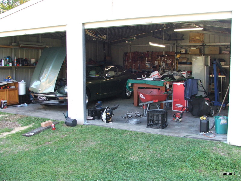

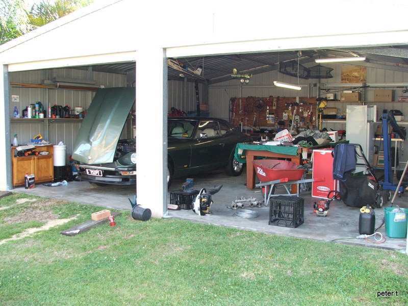

peter t Posted September 6, 2011 Posted September 6, 2011 Except I can't get to the Pool table because it is covered in Z stuff. Quote
