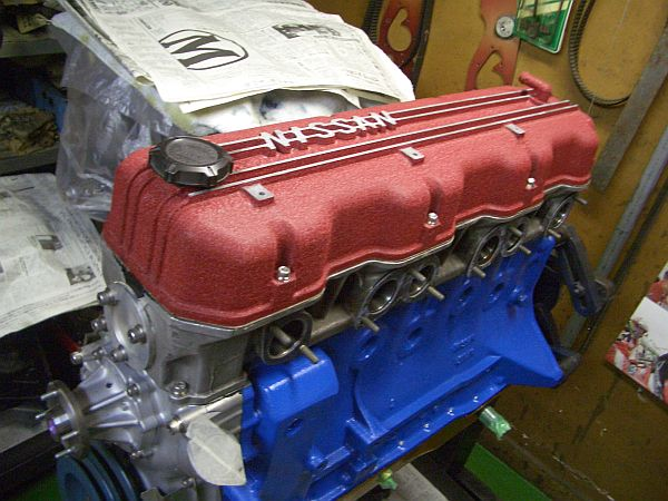

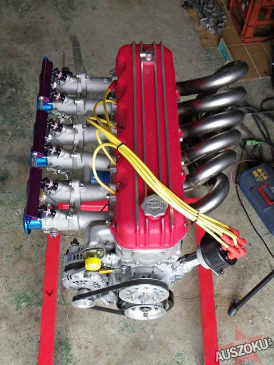

Very nice LY there...want that in betwen my strut towers!
Now I have been sitting on this a while now....but I found out about that some time ago and it is not an LY ;) the engineering that has gone into make this head look like that is nothing but outstanding.
Now the original site I found has many many pics of the build. You all will be surprised to know the head is common and in Oz will be easy to find. Now all we need is the guy to make the other parts available for sale with info on how to do the rest ;)
This pic will give you an idea on the work that went into this build 8)
Well that fooled me! hahaha You'd never guess that was a custom one off. Some more pics would be nice..

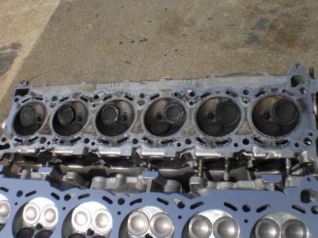

One of these is the real LY head
The other is the donor this was built on in its natural form.

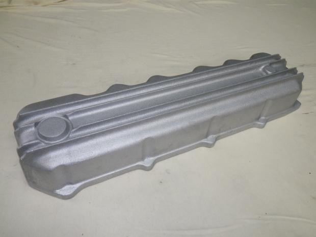

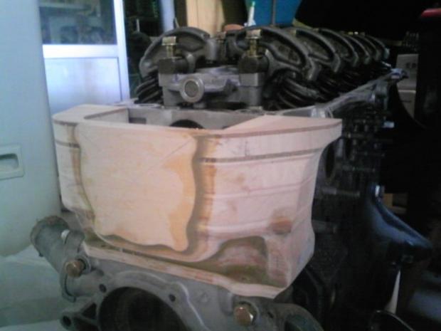

Peter you are correct it is a custom cover :D as in the sump and the intake manifold all cast in a foundry.

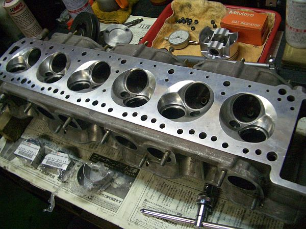

Last pic is the head during the rework phase.

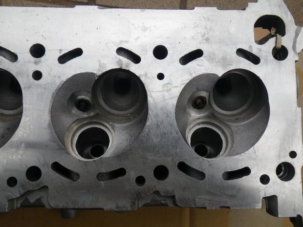

The one at the top is RB30 with the rockers showing and so are some of the other pics with the evenly spaced exhaust ports. As for the heads with the odd spaced ports????  ???
The odd spaced head is the FIA LY cylinder head made by Nissan back in the day that was FIA approved and sold off the sports option catalogue. Also homologated for Group 4.
I know of a local cylinder head business here in NZ that makes/cast/sells new head for the Nissan Z20/24 range of engines. Now have a close look at these heads (see here) http://www.kiwicylinderheads.com/modelphototest.asp?partid=68&productid=&companyid=5 and compare to the FIA head above.....see where I am going with this. Now we just need these guys to cast up one with the extra 2 cylinders and we have a FIA replica head ;)
Well those with the keen eye that spotted the small separator Plate between the rb30 head and L series block should very interested. Cheap Crossflow L series anyone?

hahah if only it was that easy the work this guy has put in to this head is incredable lots of work on the oil in and out side of things for a head that has bad ports  ::) but it looks real cool 8)

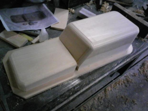

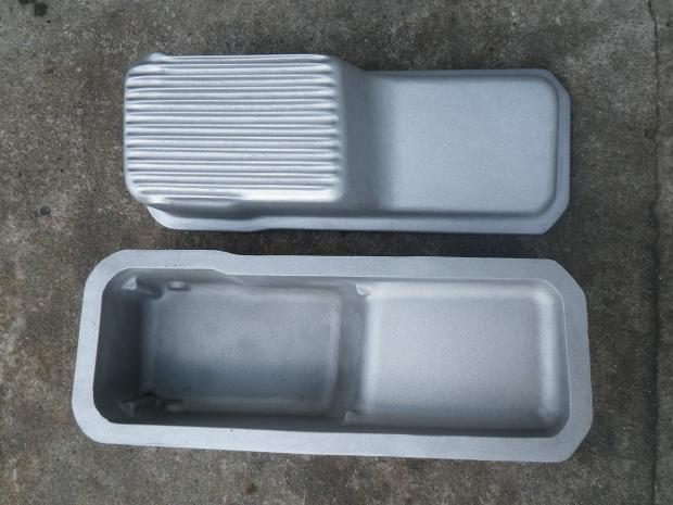

yes it does look like it....but here is pic of the their sump fresh out of the cast. And also the wooden pattern they made cast these up ;)
Having access to a foundry would be so so cool
