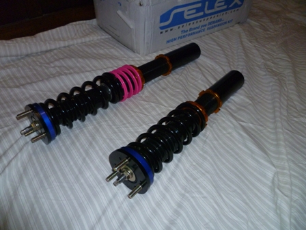

camZ Posted July 14, 2011 Posted July 14, 2011 I have had these coil overs made with tubes to suit 260z struts. I have only just recieved them so i haven't started adapting to the struts yet. With this setup you can get the spring rate you like with adjustable dampener and adjustable height. I was going to do some photos of them assembled. Quote
camZ Posted July 14, 2011 Posted July 14, 2011 Also the top mount has the correct bolt location to fit our zeds Quote
RB30X Posted July 14, 2011 Posted July 14, 2011 Where did you get those strut tops from. Were they part of the kit? Quote
NZeder Posted July 14, 2011 Posted July 14, 2011 I think the box in the background is the give away - selexsuspension - google it you will find a site and from there I am sure a supplier Quote
camZ Posted July 14, 2011 Posted July 14, 2011 The guy's name is Cedric, he is willing to get them built to any design. This set cost me under $1000 delivered. His email address is mxp.5700@gmail.com Quote
