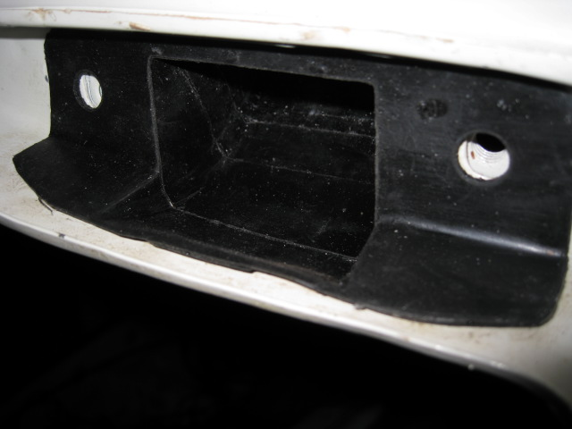

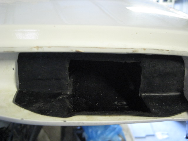

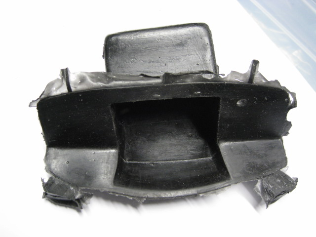

Scoota G Posted August 18, 2010 Posted August 18, 2010 The rubbers are not even noticable in the first picture, they hide right up in there and often have overspray on them. Next time i'm at Dales i'll take a picture of the hole it came out of. Quote

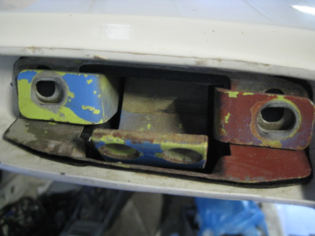

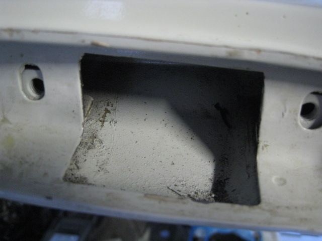

Zedsabbath Posted August 18, 2010 Posted August 18, 2010 I'll save you the trouble Scoot.... The first pic shows the cavity where the hinge fits in....the second pic shows how the boot fits (I've used one of the defective reject boots , just out of the mould the other day, notice there's no bolt holes yet)....the third pic shows the boot reinforcer.... the forth pic shows the hinge The boots keep water out Pete Quote

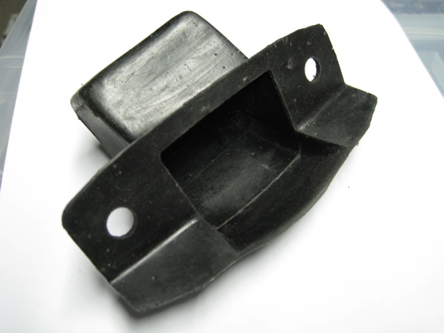

Zedsabbath Posted August 27, 2010 Posted August 27, 2010 There's a vacuum in my head for attempting them in the first place Salty but there's no turning back now...I've tried 5 ways of pouring and pressure feeding is best so far The bubbles I mentioned about before were really air locks that prevented the liquid from flowing fully throughout the whole mould cavity, I've overcome that problem Trouble is there's limited time once the agents are mixed together, gotta get it into the mould as quickly as I can Thanks mate - Pete Quote
