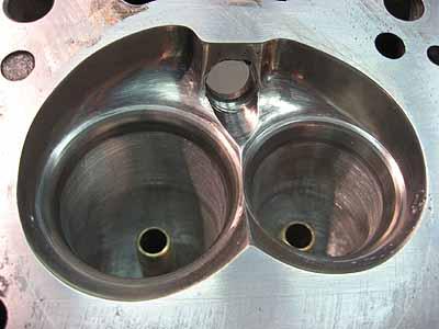

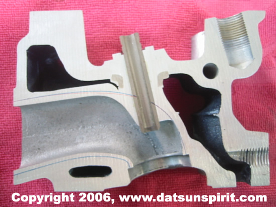

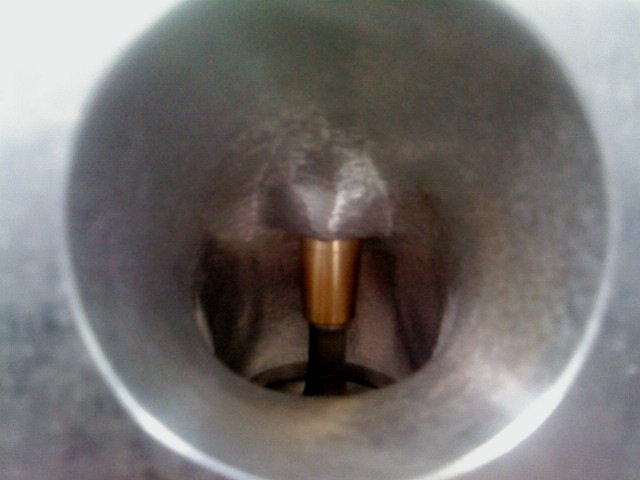

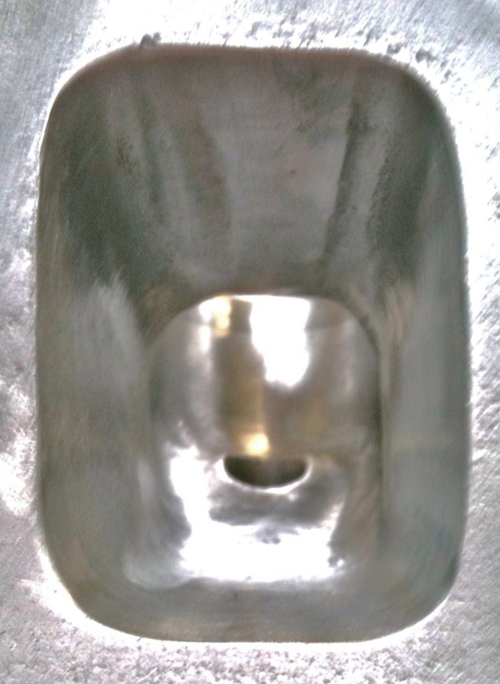

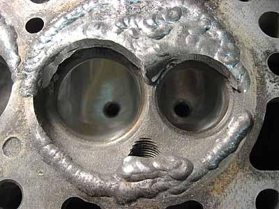

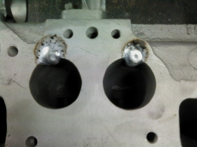

peter mc Posted March 10, 2012 Posted March 10, 2012 some pics of n42 some mine some off the net Quote
