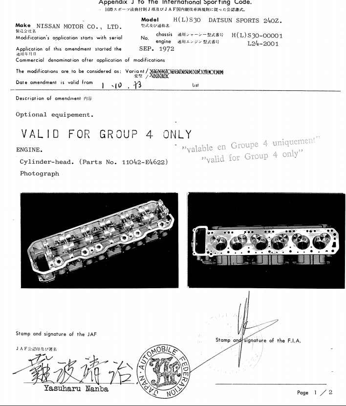

theremm Posted July 24, 2017 Posted July 24, 2017 (edited) Just thought I'd add to this old thread as I have recently purchased an L28 and was trying to understand the legality (I'm in QLD) in regards to properly registering and insuring this swap for my 240z. Came across these FIA Homologation forms and extensions which note that in 1975 the L28 was approved and could be selected for H(L)S30 and R(L)S30 model cars as a maker's option. This is specifically for the fuel injected L28 however. See link or scroll down to page 46-48 of the attached pdf. http://historicdb.fia.com/car/nissan-datsun-sports-240-z-hls30 Edited July 24, 2017 by theremm gav240z 1 Quote
theremm Posted July 24, 2017 Posted July 24, 2017 Can't seem to get the file to upload for some reason... anyway, it's accessible through the above link. Quote

Administrators gav240z Posted July 25, 2017 Administrators Posted July 25, 2017 Can't seem to get the file to upload for some reason... anyway, it's accessible through the above link. Direct link to my Google Drive. FIA recognition for Group 3. https://drive.google.com/open?id=0B_tGt5V5rGDVWU4yblYtWHZvaWM PS: If only I had a spare 1 of these... Quote
