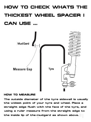

RUSSJZ-ZED Posted September 20, 2006 Posted September 20, 2006 backspace of 115mm fits on front, with standard springs, gets tight after that, dont forget that the wheels have to turn, 17x8s with 235x45 were picking up the guard on lock, easy curable with angle grinder(this is assuming you are not on the concours team) Diagrams might help understand offset and backspace. Quote
Toecutter Posted September 21, 2006 Posted September 21, 2006 Good diagrams RUSSJZ-ZED. I'll start a new thread with those same diagrams and perhaps Gav can make it a sticky. We can have people contribute what wheels/tyres etc they are running as this seems to be a popular question for Z car owners. Quote
