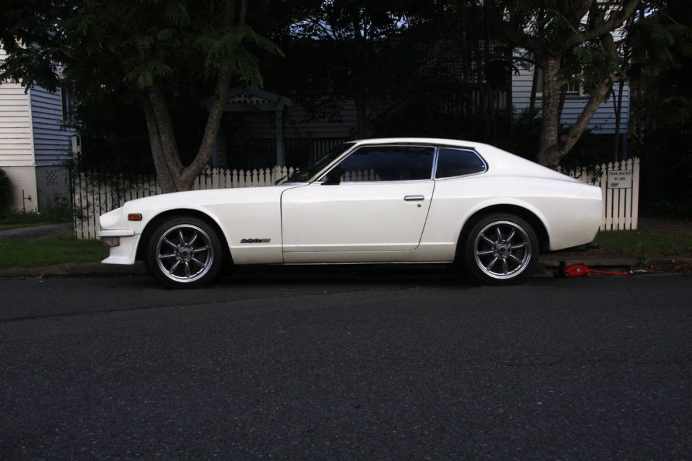

sexual_sushi Posted April 13, 2010 Posted April 13, 2010 Hey mate, I'll let other people post info about the specific sizes you have mentioned but I borowed Steve's 17 x 7.5 Rota RB and it looked like this on my 2+2: http://forums.hybridz.org/index.php?/topic/58528-wheel-show-post-your-pics-of-you-wheels/page__st__1100?s=fc8ef53a14a082ea455edf87e748f0bf I thought this was stock ride height but I actually lowered it roughly an inch in photoshop.... Quote
