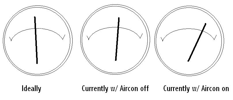

stevo_gj Posted January 19, 2010 Author Posted January 19, 2010 Thanks for the input guys. I've posted a picture below that should answer your questions. Currently it runs like the middle one during normal driving around town, and the right one when the aircon is on. I am under the impression that this was a bit hotter than I would like and that it should look like the left one. I think that Daniel is correct, the t/stat should already be fully open when its running during normal operation so I don't see how making it open sooner will make much of a difference except for very short drives. I currently have the stock mechanical fan with the original shroud. You are correct Lurch I am using the green stuff. I just found these on ebay, I measured up the condensor and I believe that I should be able to put this in front of it quite easily: http://cgi.ebay.com.au/TWIN-THERMO-FAN-10-X-10-BRAND-NEW_W0QQitemZ310194680395QQcmdZViewItemQQptZAU_Car_Parts_Accessories?hash=item48390b324b I was thinking I would do the following: -"Give the radiator a good clean with radiator flush to de-scale and then flush out with a high pressure hose." -Add the Redline 'Water Wetter' -Install these ebay thermo fans in front of the condensor -Depending upon success of previous step, install a single large thermo fan in place of original mechanical fan using the existing shroud. How does this sound? Quote

260Coupe Posted January 19, 2010 Posted January 19, 2010 Steve Leave the thermosat in ........removing it will only mask the problem and create others. My Zed ran at the same temp (as per your third figure) around 90 + deg on the gauge until I fitted the thermo fans in front of the condensor. Once I fitted the thermo fans the problem was solved , temp runs at a constant 82 deg even when stuck in traffic on the hottest days. Quote
Moderators Zedman240® Posted January 19, 2010 Moderators Posted January 19, 2010 I'd go with Daniel and Allan, leave the thermostat in. Late model cars now with clutch and electric fans have the mandatory electric fan with the AC. The fan for the condenser should be on always when the AC is on for the air conditioning system to work efficiently. All the AC does is remove heat from inside the car and dump it outside hence why the condenser needs a fan to blow air through it to remove all the heat. I won't go into detail on how air conditioning works so I won't bore you to tears. Try to mount fans that cover most if not all of the condenser for it to work well. The third pic of the temp gauge is a little hot for my liking but as Allan said, mount the fans and there shouldn't be a problem. Quote
