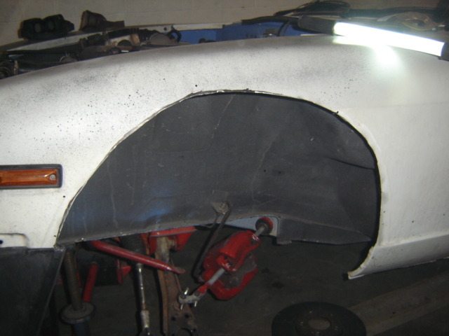

RUSSJZ-ZED Posted September 28, 2006 Posted September 28, 2006 I had a panelbeater do the rears for $300,(in his spare time)If you are in Sydney he can do over a weekend, Now he has done one thinks about $400 would be more realistic. The front took me about an hour with an angle grinder.Put the flares on, mark outside with whiteboard marker, cut 25mm below line.easy Quote

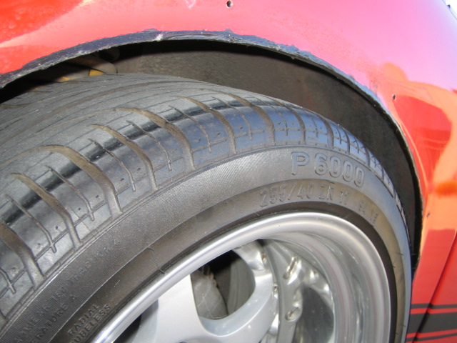

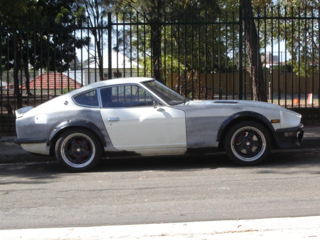

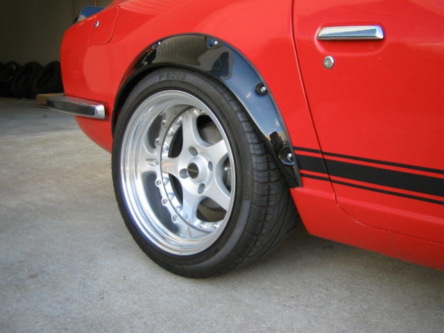

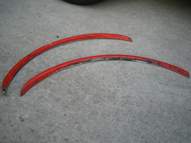

Toecutter Posted April 5, 2007 Author Posted April 5, 2007 Finally done! You can see in the close up pic where the tyre was rubbing whilst driving with the guards rubbing on bumps, ate into the tyre a bit. The fella that did the job was excellent. He used a TIG welder so heat build up was minimal from my understanding. The black stuff shown in the pics is some sicaflex over the welds to get me throught the Nationals and keep the water off. I dropped the car off at lunch time and it was ready by next morning. He also gave me back the trimmed guards to store away just in case one day...! :wink: Must by a MIG and start practicing "one of these days!" Quote
