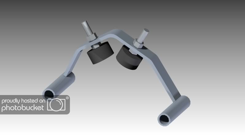

I just bought and CADed this part from Dat2Kman, its designed by Alan Stean (once Z car workshop in Brisbane) to swap out for the factory rubber strap. You can adjust the height of the rubber knobs using the nuts to sit against the diff and the whole thing just bolts in using existing bolts.
Not sure how Alan would feel about me giving the measurements out since technically its his invention, but I'm sure a picture is fine. If you can be bothered emailing him (i'm sure his email is on here or google) and get his permission I'll email you the technical drawings for it. Surely every Z owner is going to find one of these useful.

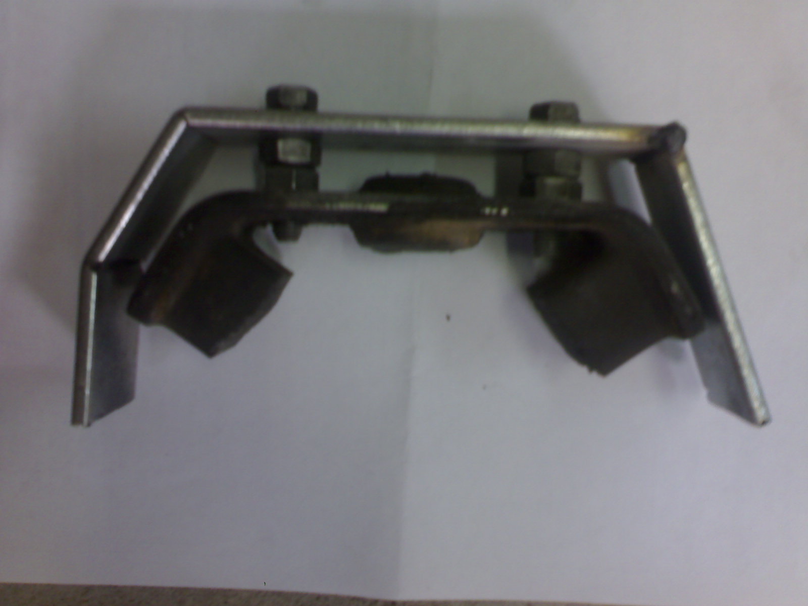

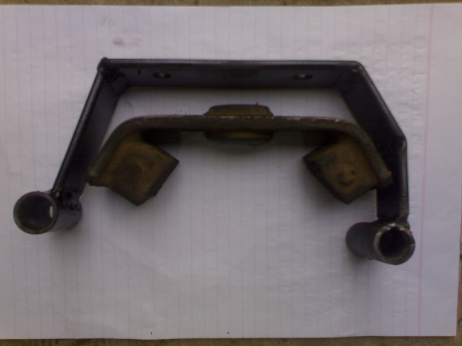

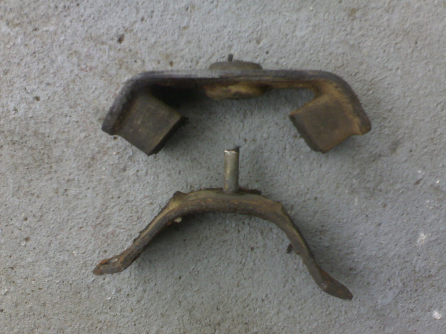

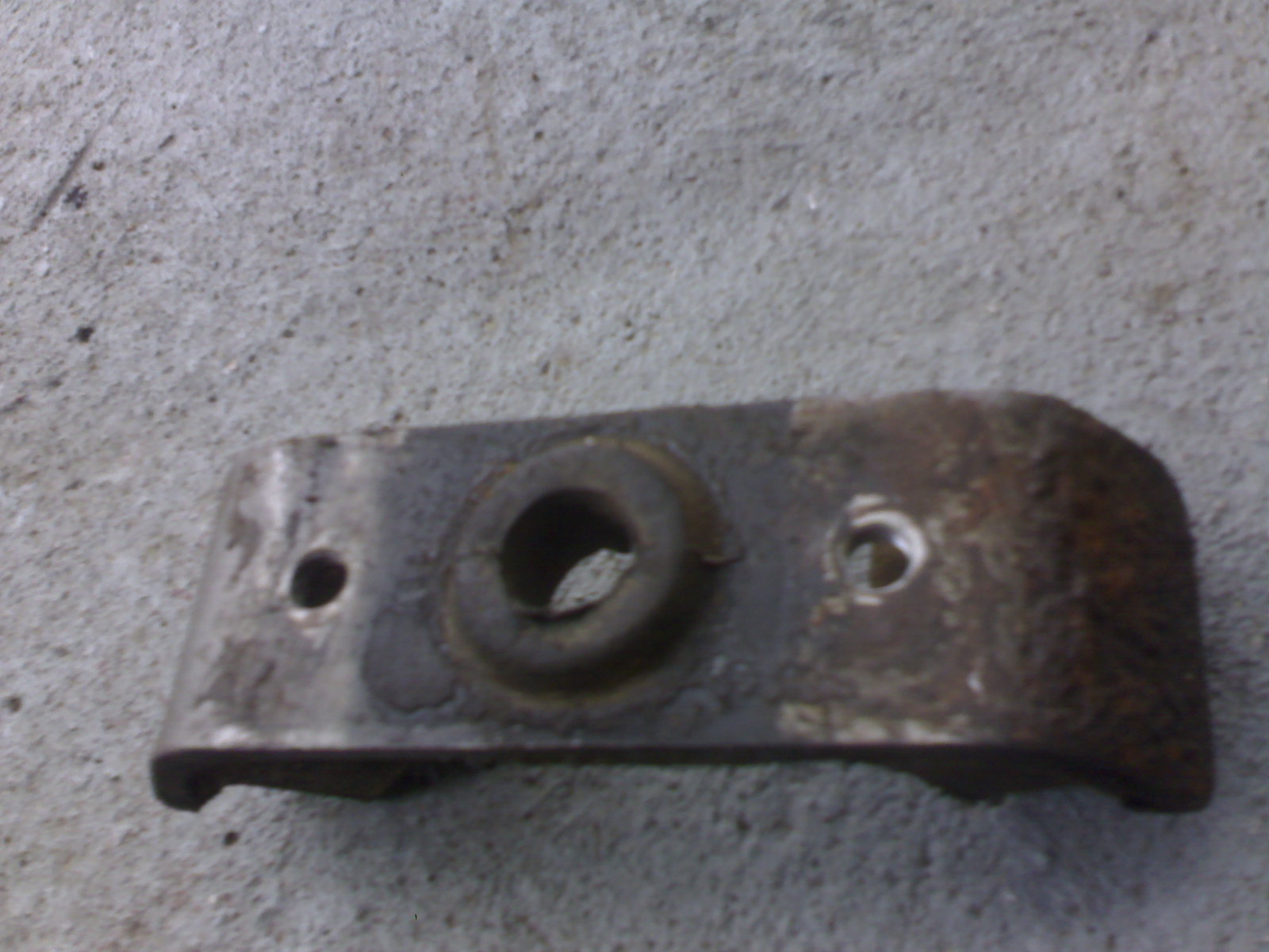

This was my attempt... Many celica fans/owners may remember the transmission mount from the 72 (pictured) with the transmission side part cut off. A piece of 40 X 5mm plate was bent up and then made to fit Dales parts car but when i went to fit it to the red one it was way out.
This leads me to thinkin that these parts may have to be fabricated for individual cars.
Then i tack weld it under the car it was meant for and Arc Welded it... with some shrinkage... which is easy to adjust.
The celica mount already has two threaded bolt holes in the top for 14mm bolts which provides the adjustment.
