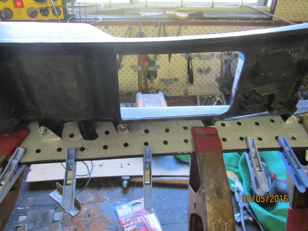

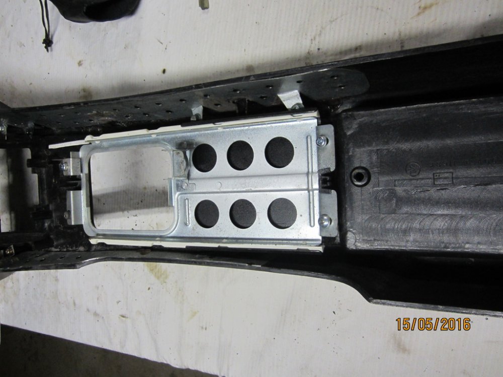

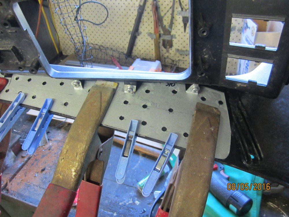

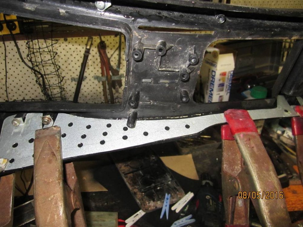

Groundhog Posted May 8, 2016 Posted May 8, 2016 (edited) Still working on the console lid rebuilding the screw posts and filling the dents on the outside. In the meantime I thought I'd reinforce the centre console before I repaint it.The console is hanging from some straps to keep it level while the glue sets. I used some thin gauge galvanised sheet I had lying around and used the screw posts on the underside to help locate it.Glue is Super Strength Araldite. I'll add a photo for the other side when I glue it. I plan to make a separate bracket to go on the tunnel for the choke lever so it's not connected to the console. [/ URL] Edited May 8, 2016 by Groundhog MichaelT 1 Quote

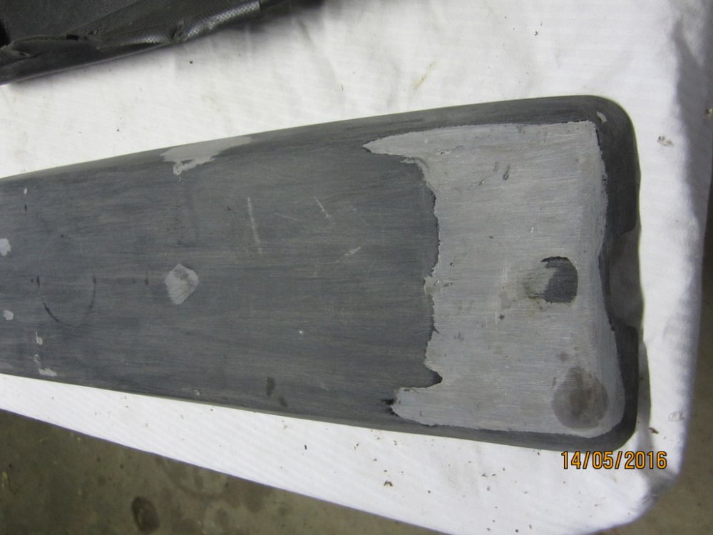

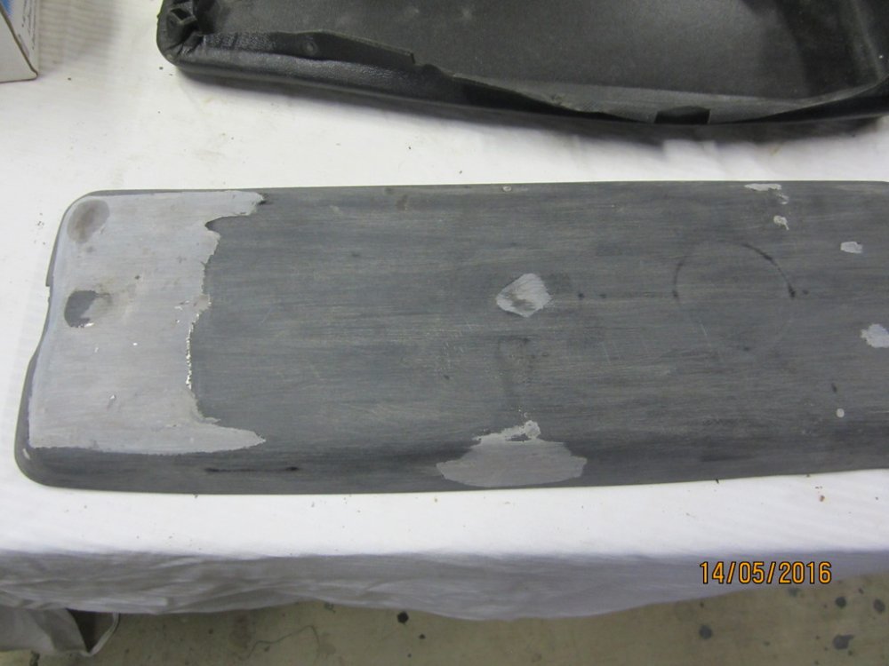

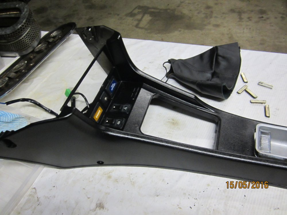

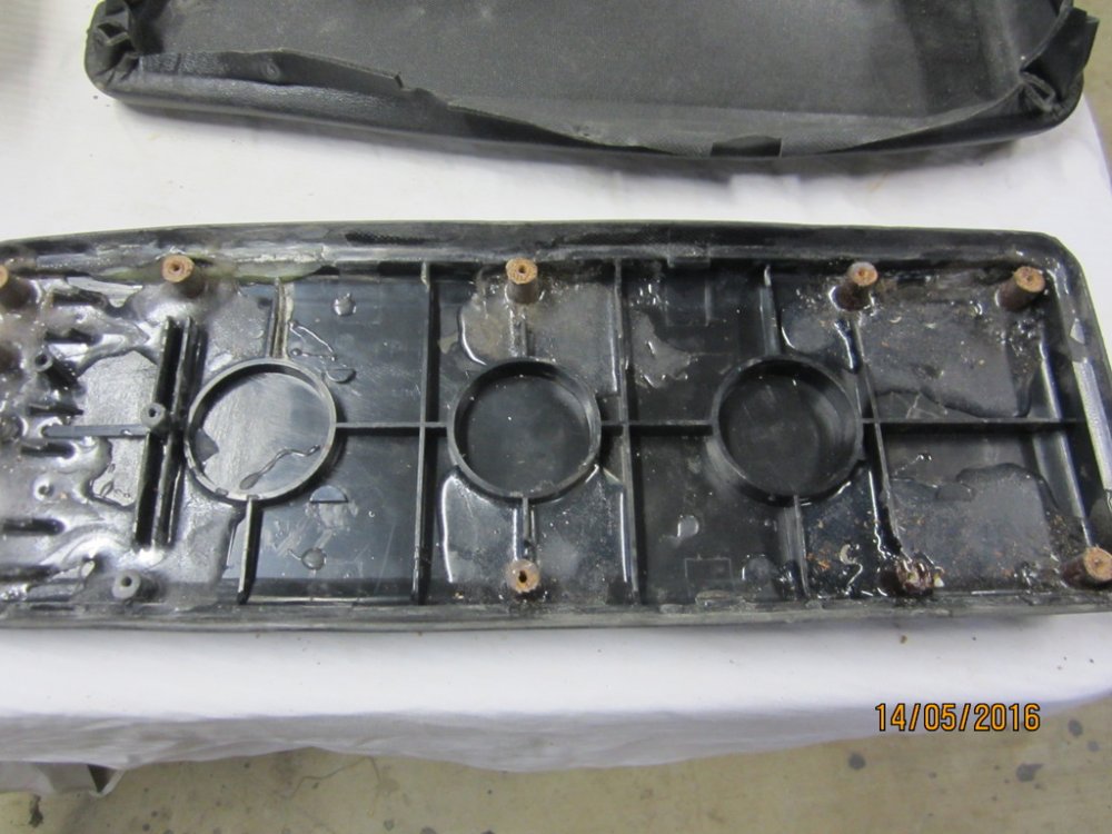

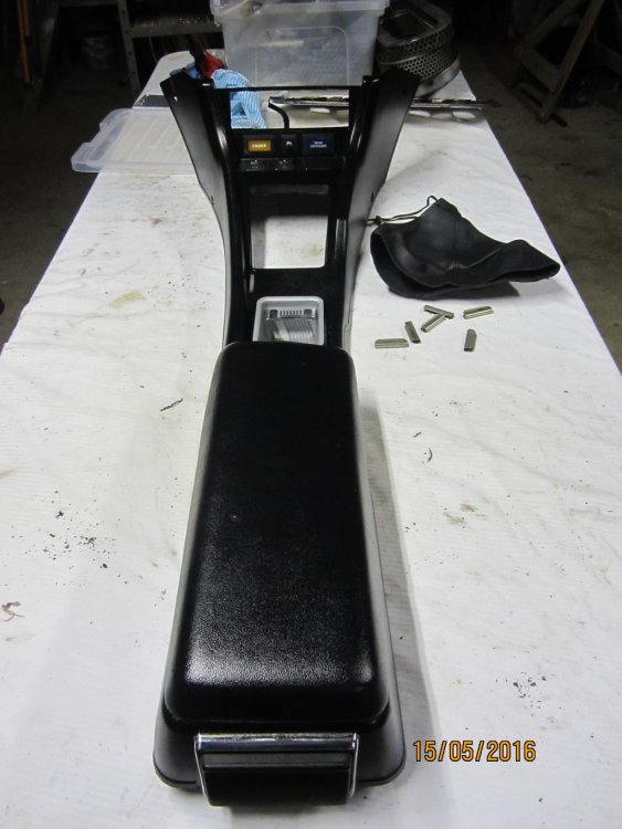

Groundhog Posted May 15, 2016 Posted May 15, 2016 Just reassembling the console after the work. Here are some photos of the console lid which I rebuilt with Permapoxy for the outside filler, and the inside posts which I turned up out of some hardwood and Araldited into place. I used some self tappers to hold them through the lid, then removed the screws and backfilled the holes. All in all it turned out OK. I redid the writing on the Choke and Rear Demister lettering with some White nail polish. I applied it to an old switch first to trial it. Put too much on then polished off the excess to leave a shiny lens and white lettering. Quick simple, cheap. Quote
