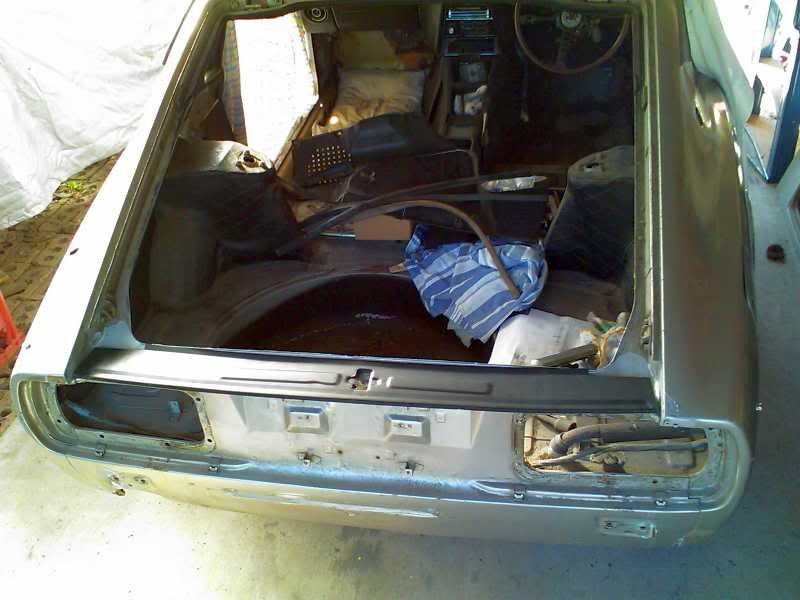

I'll get on the bandwagon and share as much of this renovation as I can.  I call it a renovation because I'm more keen on getting it back on the road than doing a "proper" restoration for which there isn't the budget anyway.  So if I take short cuts that offend, that's my excuse and too bad.

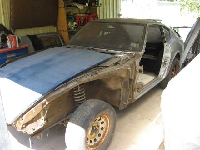

It arrived Xmas before last after sitting under a house since 1988...
Where it was tucked away in the shed while I was distracted by the 280zx.

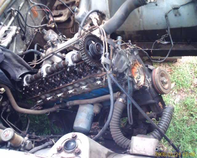

Before tucking it away I thought it wise to first remove the engine.  Though it had been sitting this way for 20 years, it had just traveled across Brisbane on the back of a truck.  (There is a few bits missing: gearbox, front guard, seats, radiator)
So finally after 20 years under a house and 12 months in my shed, it's out and work has begun!

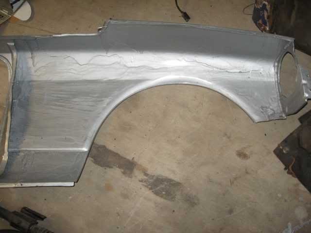

Stripping is a tedious process, you can do it financially, chemically or mechanically.  Haven't go the $$s and can't stand the smell of paint stripper, so I choose mechanical.  These stripper discs are very effective

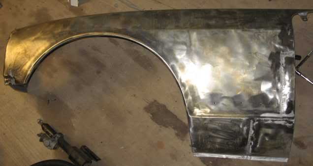

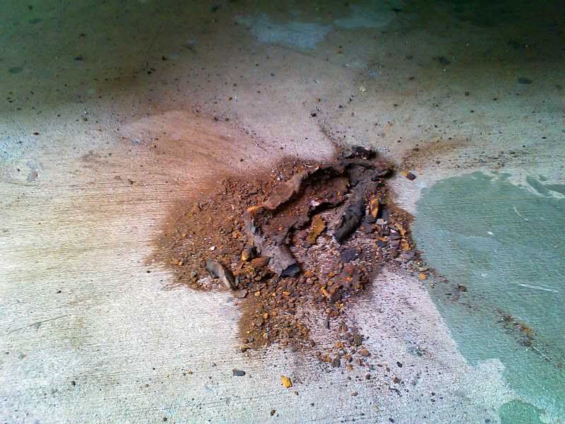

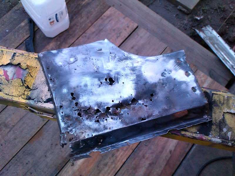

If I could get the photos off my mobile phone I'd have more detail here, but basically the bottom and rear edge of this guard were rust damaged.  Replacement panels were cut from useful sections of a 280zx guard and welded in with a cheap 2nd hand gas-less mig.  Por15 has been painted into the weld area and then stripped off the surface
The entire inner surface of the guard has been stripped and painted with por15.  Expensive stuff but I've had good results with it in the past so I'll stick with it.

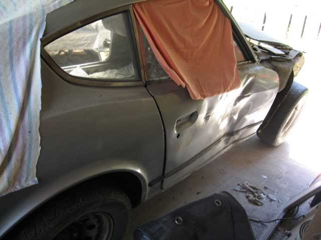

At this point time I'm taking the most useable bits off the 2 cars.  From the '71 z I'm pinching the RH door and the fibreglass bonnet.  You would think a fibreglass bonnet would be rust free, but no, the hinge attachements are steel, at least it is only some surface rust!  Haven't decided yet whether to use the steel or fibreglass headlight scoops.  Unless I find a front spoiler I'll also be using the lower front valence panels.
So to bring you up to date:

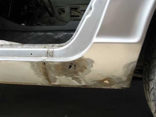

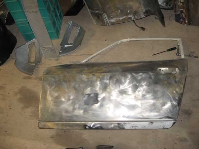

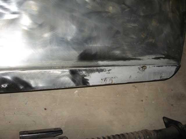

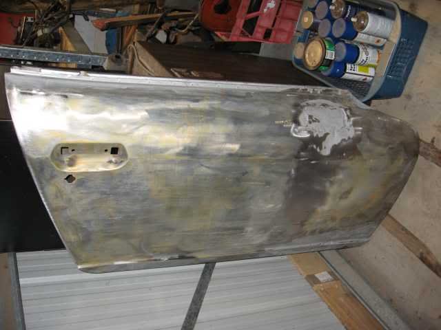

Left door has been stripped and other than dents isn't too bad.
There is a rust hole which I haven't yet decided whether to weld up or fill over for now?
The right door has had previous repairs to the front lower corner and rear lower edge.  These had rusted over again and the filler had cracked and fallen out.  They've been cleaned up as well as possible and por15'd.
The area where the mirror bolts to had rusted badly.  This area was cut out and a new piece of metal inserted.  I'm using lap welds on all of these, but welding proved impossible.  After cutting out the piece I recess the area as best and minimally as possible.  Some areas are easier to do than others, this area of the door is very difficult.  There will be a good layer of filler required over the top.
And this is why I'm using the door off the '71, this one will get reskinned at a later date.

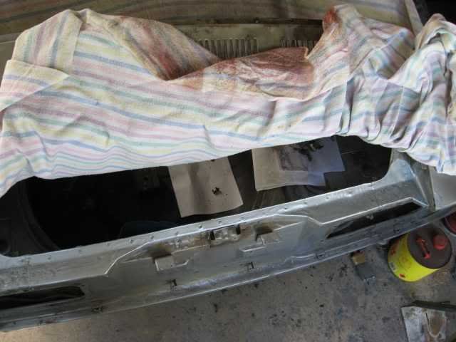

Tailgate shut panel was removed earlier and a new one has been ordered.  At the moment this is likely to be the only new panel.  Area has been cleaned up and por15'd.  When the new one arrives I'll look at where I need to strip it back to weld the new panel in.  Advice welcome from anyone who's replaced this panel before?

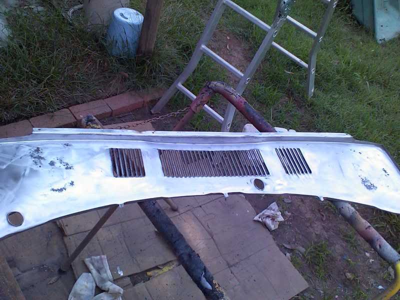

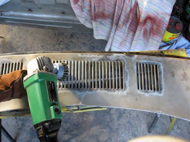

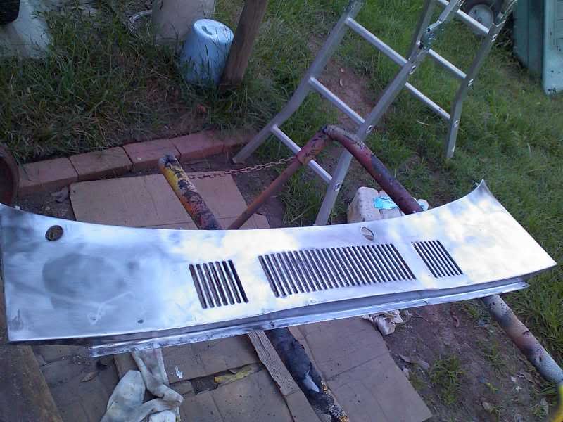

I had to revert back to paint stripper for the cowl panel, those vents just cannot be done any other way!  The wire cup brush was still useful though.
Nearly there, but I still have more work to do cleaning out the vents...
You can see the pitting where foam pads were glued on.  What have people replaced these with?  ???

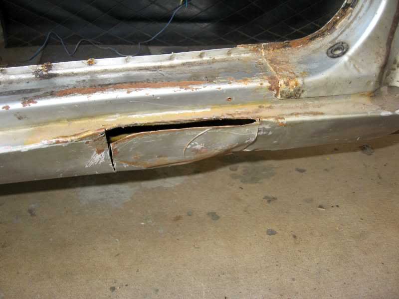

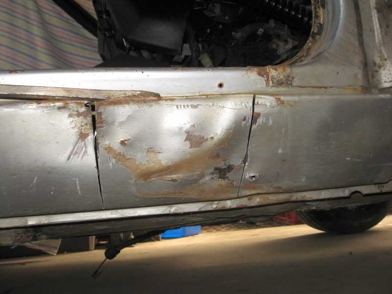

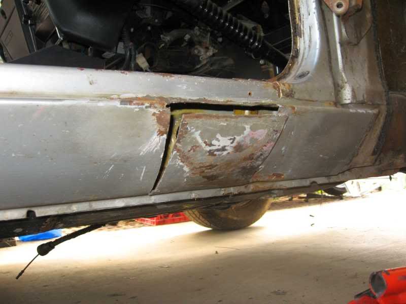

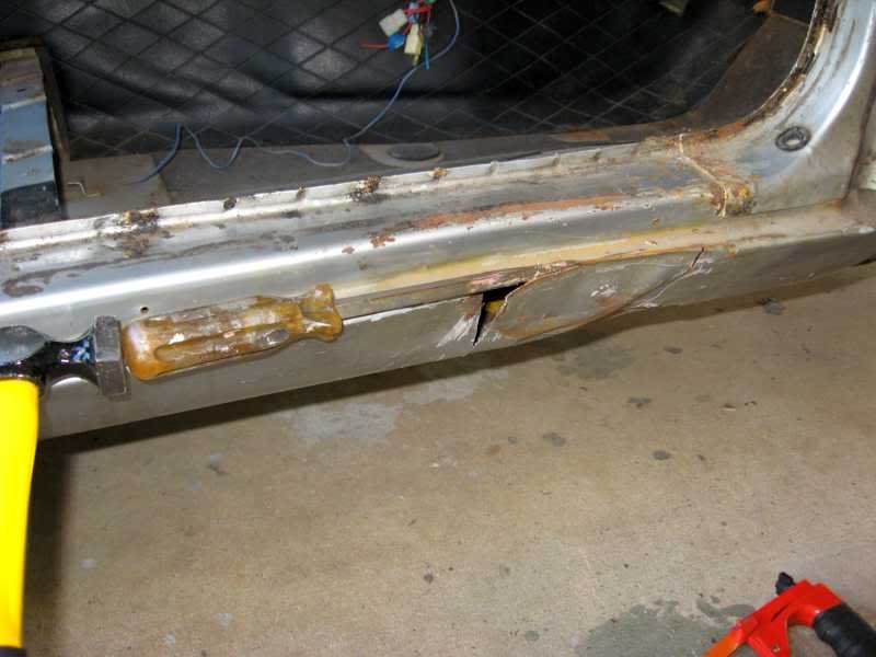

Along with the door the RH sill panel has taken a hit.
I've cut two vertical slits with hacksaw
And now I'm slicing the crease across the top
The sheet parts easily along the crease
and then fold it down
I've decided this is the most useful tool in the workshop!  It's being used to straighten out the outer sill
Ta-da! It worked a treat
A bit if work with hammer and dolly and it's folded back in place ready to be welded in

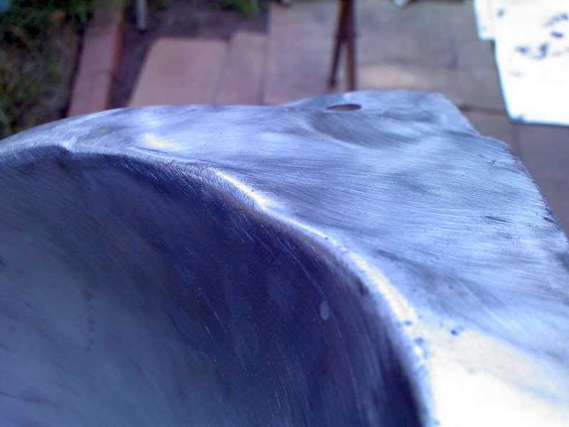

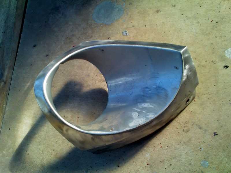

Stripping headlight scoops is particularly tedious!  The right one is pretty good
But the left one has the telltale sign of bodyfiller appearing
Two scoops stripped, damn!
Sure enough, the front of the left one is a little crumpled.
Got it off ebay but the seller is unlikely to have known, I couldn't tell until I started stripping it.

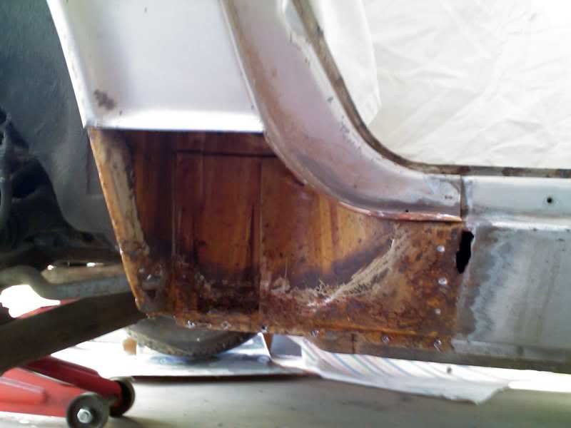

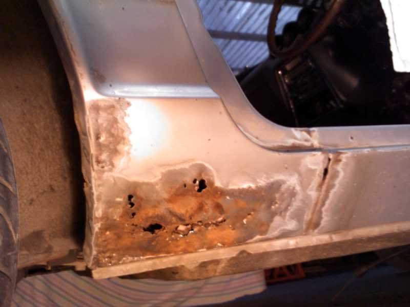

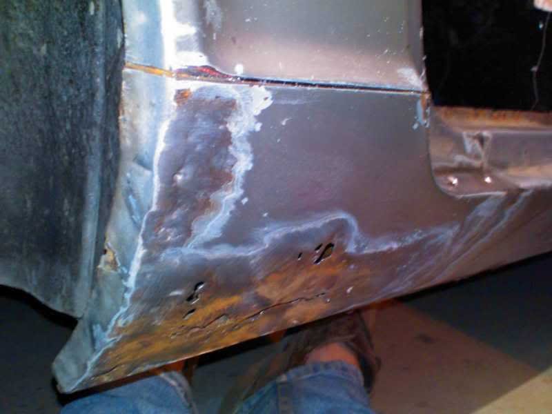

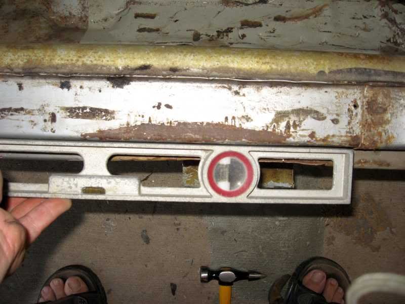

Started in on the left dogleg. It's just a little worse than hoped for, but isn't that always the way with rust...
Now this is the danger point where a renovation can verge into a restoration.  Do I close my eyes and weld a bit of sheet over the top?  Or do I start tearing the dogleg apart?  It's too much to ignore, dive in!
Spot welds
Horizontal cut
More spot welds and it'll pop off

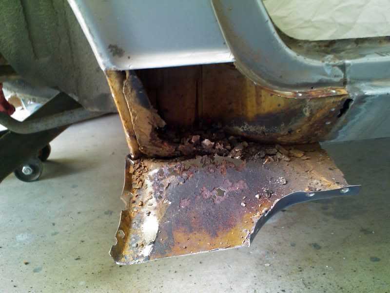

Fold it down and... this is why everywhere you read or hear about rust, they say it's always worse than looks on the outside.  My '71 240z stands testament to that too.
Yuck, rust, dirt, bog, wax sealer, holes, it's a mess.
Time to toilet train the Z, it's just left a pile of crap on the floor
Take out the remaining spot welds along the bottom and tear the junk off
Wire cup brush helps clean it out and shows up where the holes are
And a bit more cleaning up with a grinding disc

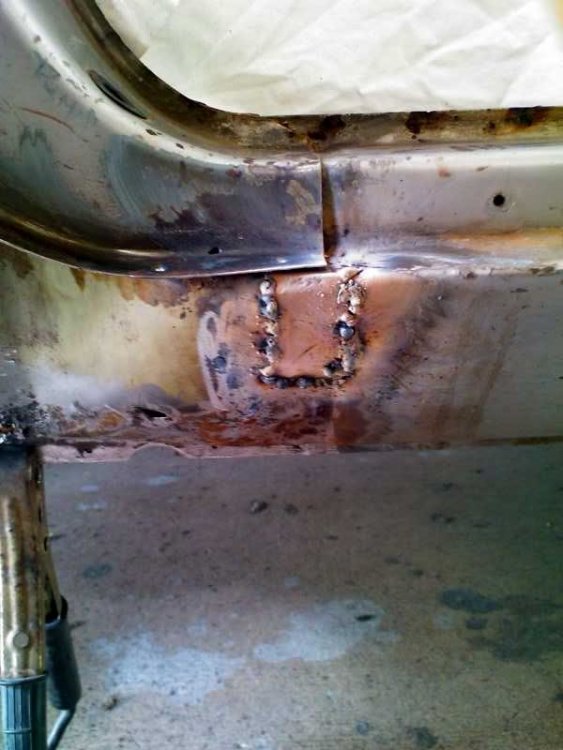

Patch made up for the easy hole where the dogleg meets the sill.  It's held in place by a small Neodynium magnet.  I picked up a bunch of these off ebay.  Very strong and very useful.  Great for holding sheet while you tack weld.  Don't let them get too hot or they lose all magnetism and become useless ceramic pellets.
Tacked in place
Shape a bit with hammer and weld in
Clean it up and "hey presto"

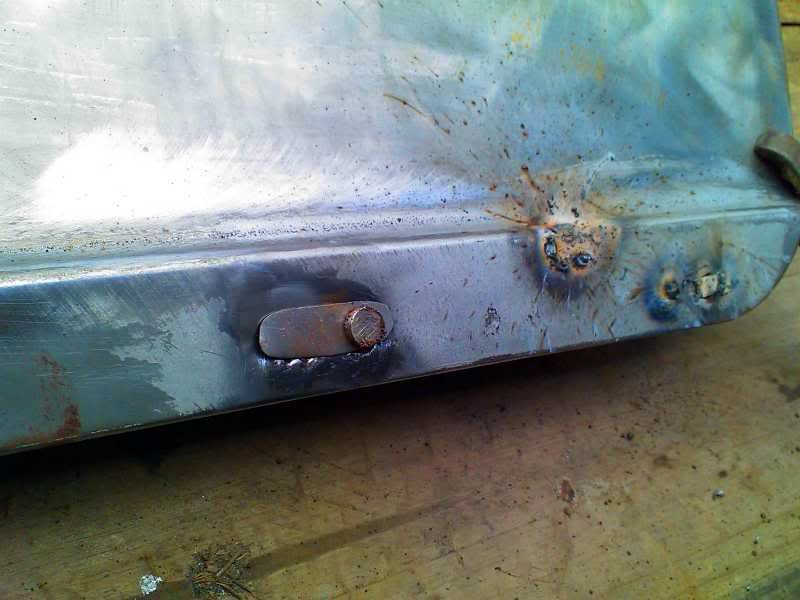

More on the nasty dogleg when I figure out what to do next, but I did a bit more on the LH door.  Bridged one small hole
Made up some small patches for the others and again using the little magnets, tacked,
Welded,
and cleaned them up!

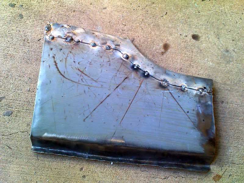

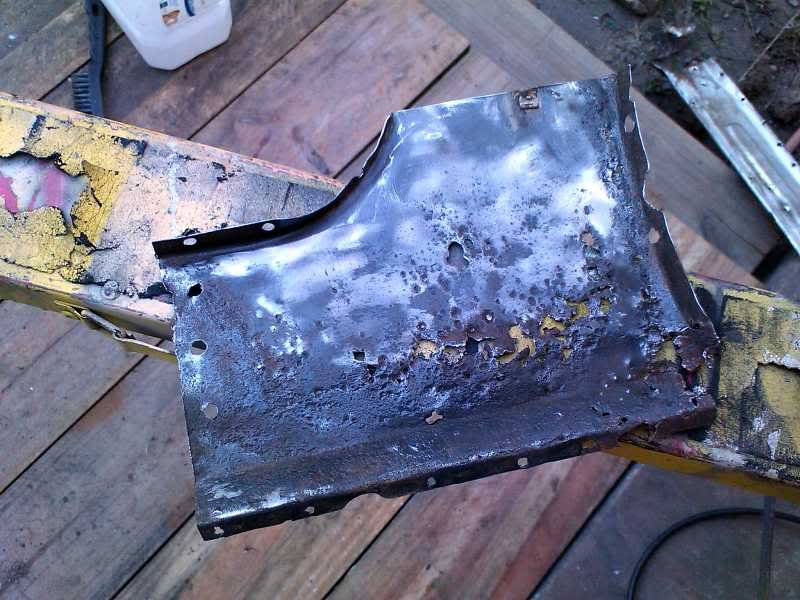

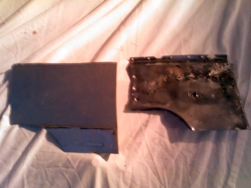

The driverside dogleg as I found out is swiss cheese.  Does anyone know if there are repair sections available?

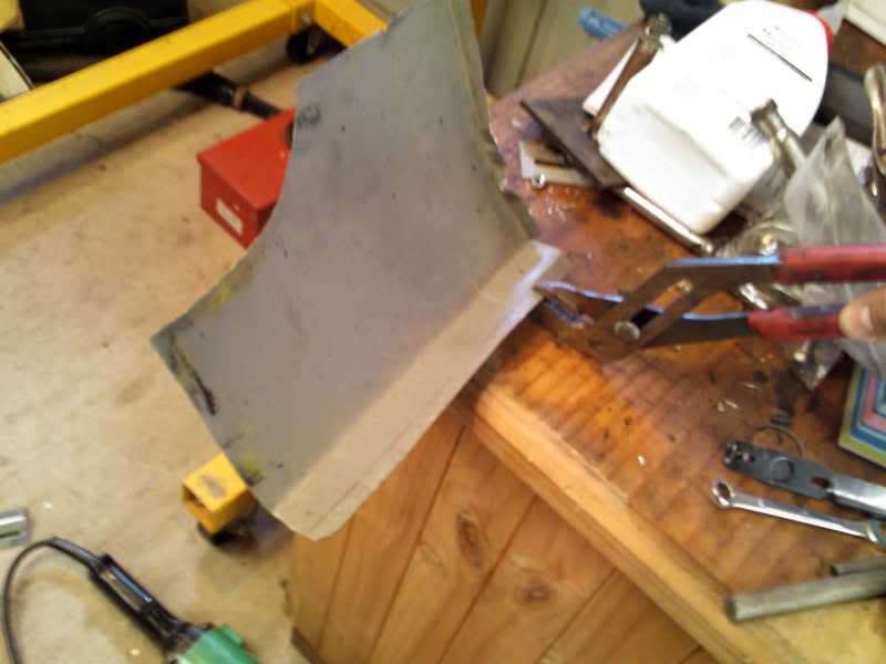

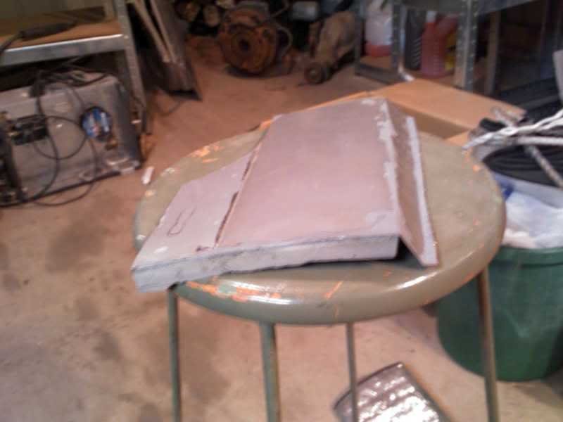

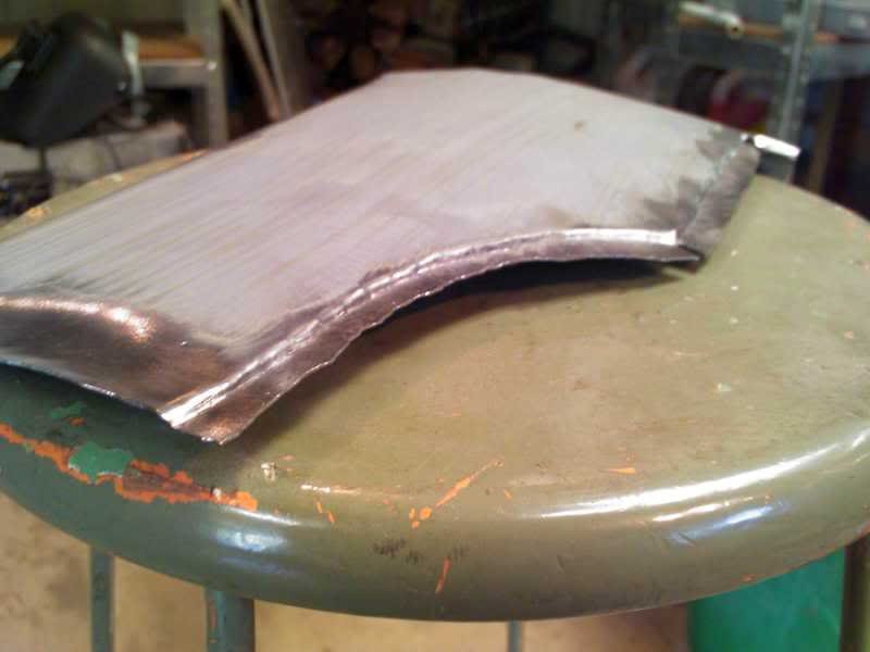

I didn't menton earlier, this is where I am sourcing my patch panels, a bent 280zx guard.

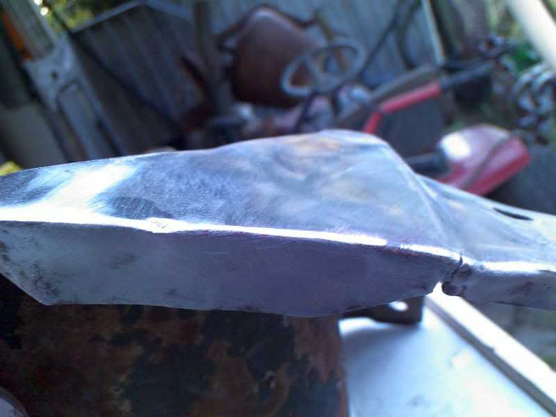

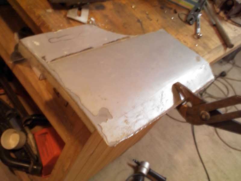

It's been more useful than I first though because I have beem able to reuse profiles and folds that suit.  Here is the donor section for the dogleg

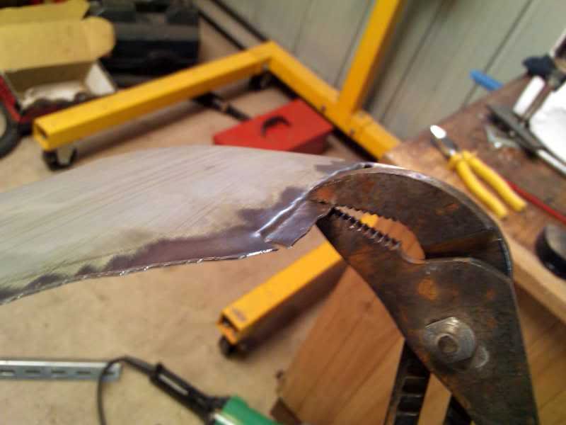

The fold on the rear edge is modified from the guard.  The lower profile is shaped by gently bending with pliers.  The trick is to use the nose of the pliers to carefully form the crease.  Don't bend more than 30 degrees at a time.  Work along and back a few times until you get the right angle.
The wider fold was formed the same way but using the deeper grip of my favourite tool using exactly the same technique
Tidy up both folds with a hammer and dolly.
Trial fit
Lower profile not right, have another go

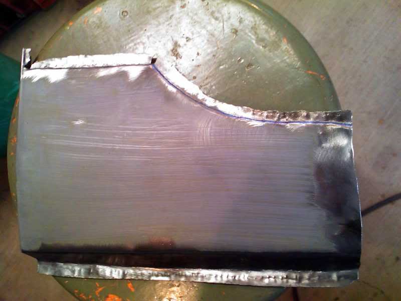

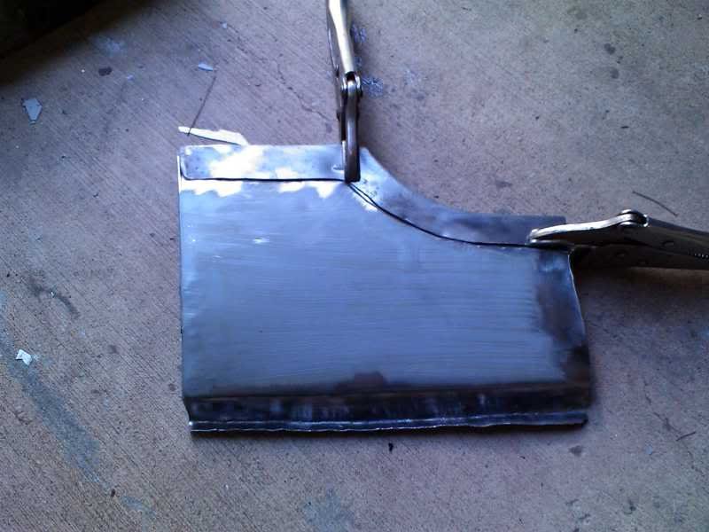

Had a brainwave!  Reuse the top profile of the old dogleg
Double check it still fits
Put new section on as well and mark out where they meet
Add about an 8mm overlap, cut to shape and form a lip.  Same technique as above but take even more time and care.  You want to form the lip fold first and then bend the overlap back to parallel
Should end up looking like this
Clamp the two parts together
Start tacking them together
Not too bad I think

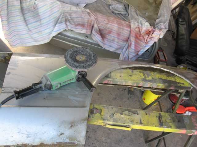

where abouts did you get them from? what brand? and how much?
I just went and got the only similar looking thing from the local hardware store, and for the price it was and amount of a panel that i managed to strip it seems like an expensive method!?!
