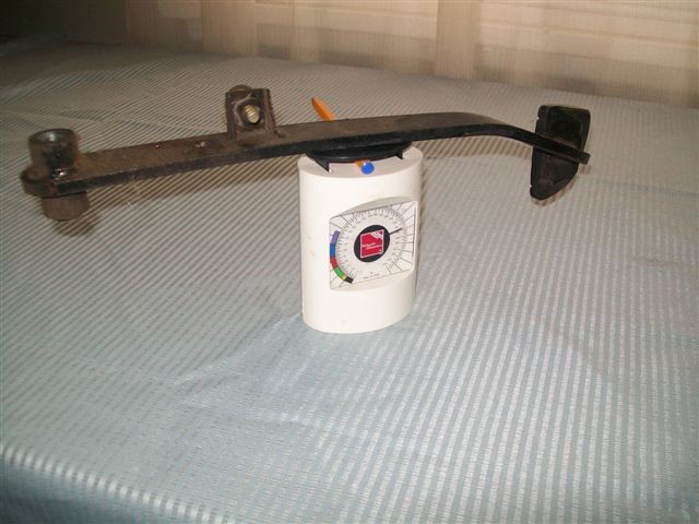

PeterAllen Posted January 26, 2009 Posted January 26, 2009 Wonder what a brake pedal weighs 1310 grams, actually! PS. I get the joke. Quote
