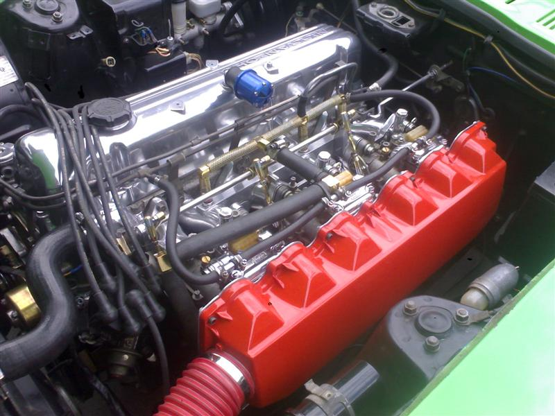

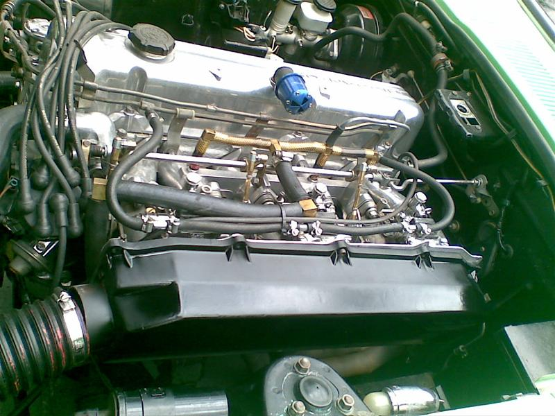

Riceburner Posted December 16, 2009 Posted December 16, 2009 Hey scoota looking great!! Are you building these to sell? If so I'm interested... providing it won't hit my strut tower, what is the overall thickness? Quote

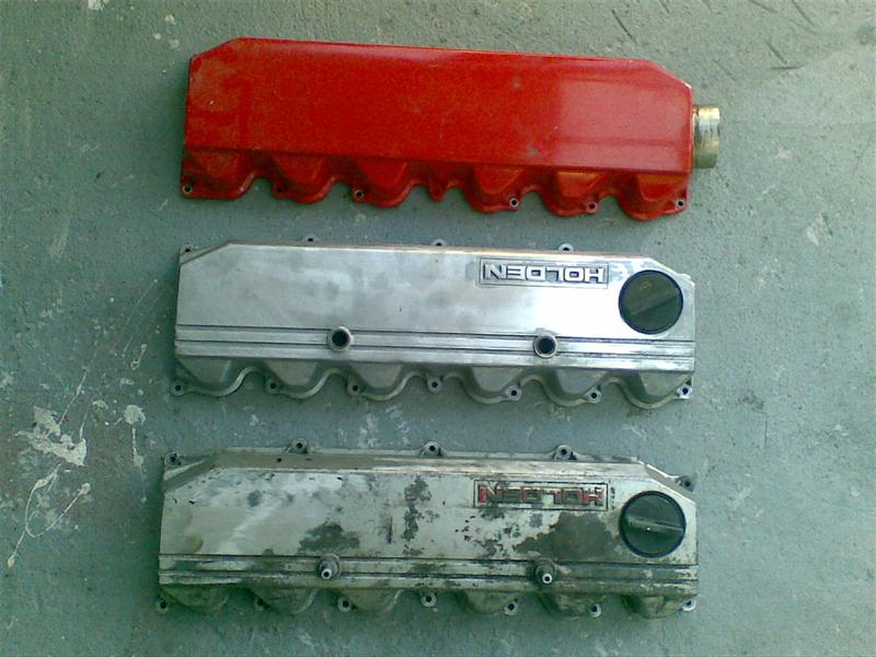

Scoota G Posted December 16, 2009 Author Posted December 16, 2009 What i had in mind is to fabricate the next one and then make a fibreglass mould of it but i think it wouldn't be worth it as RB30 rocker covers are cheap and plentiful. The distance would depend on what manifold you use but a Ebay one i listed earlier in this thread has less clearence than mine. As a real time guide i can fit my knuckles in between the intake and the strut tower.. .. .. this clearence would expand when the air box is turned around. Once i do the next one i'll post some pics and see what people think (should have a lot cleaner appearance). Quote
Riceburner Posted December 16, 2009 Posted December 16, 2009 I have a custom manifold and blackbird carbs so I will measure the distance. Keep us posted Quote

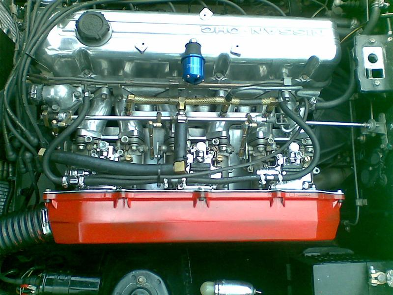

Scoota G Posted January 30, 2011 Author Posted January 30, 2011 Sorry for diggging up this thread Again but i started on Version 2 which puts the bumpy bits down the bottom. Quote

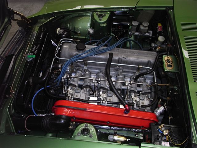

Sirpent Posted January 30, 2011 Posted January 30, 2011 Hey Scoota, Now that looks the goods Buddy ! much more original looking, well done. Are you planning on doing anything with the color of it as in re-apply or maybe polishing the housing to an alloy finish? Cheers John Quote
Scoota G Posted January 30, 2011 Author Posted January 30, 2011 Are you planning on doing anything with the color of it as in re-apply or maybe polishing the housing to an alloy finish? Hey john thanks, The problem with the cover is it can't be welded easily and has all the holes on the front so polishing wouldn't really work. Going to stick with a color but not sure what yet! The inside grinding makes it 1 kilo lighter Quote

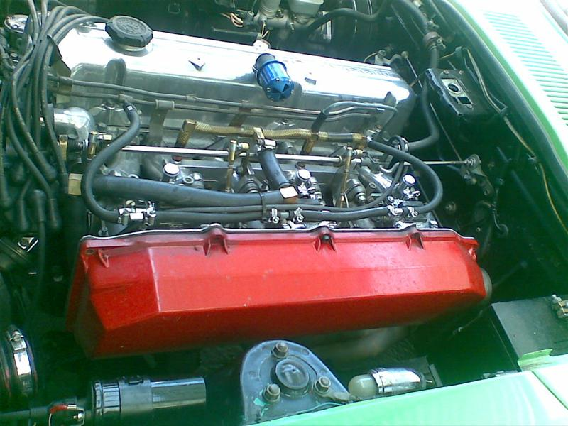

Scoota G Posted January 31, 2011 Author Posted January 31, 2011 Are you planning on doing anything with the color of it as in re-apply or maybe polishing the housing to an alloy finish? Perhaps understate it in a Satin or Matt Black! Quote

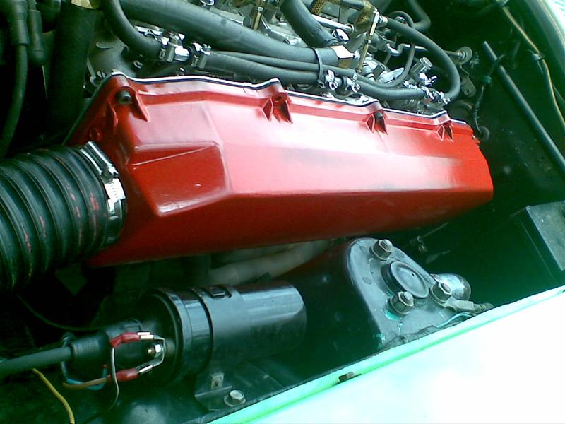

Scoota G Posted January 31, 2011 Author Posted January 31, 2011 Well that's done then. I should have done it this way to start with but i think the principal of custom design is in the practical application and not the theory. You can't see the bumps now and it doesn't even look like a rocker cover now. Quote
zr240 Posted January 31, 2011 Posted January 31, 2011 looks cool scoota Ive got a nissan (r31) here that I might try to fit onto my car as I need to start getting some cold air and a filter over my triples, Got me thinking I could also try a L series rocker cover? Just wondering if there is an issue with volume of the airbox? Ash Quote

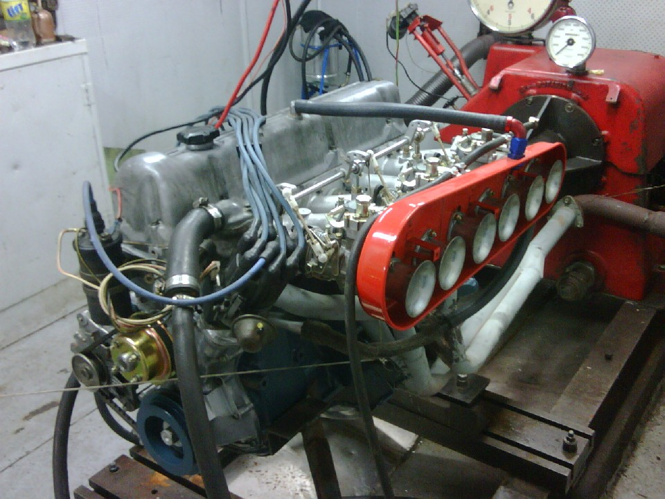

260Coupe Posted February 1, 2011 Posted February 1, 2011 There is certainly some science in the airbox design, we have proved this on the engine dyno numerous times. The standard 240z air box on the twin Hitachis makes more power than ram tubes alone (and crappy uni filters) by at least 5% across the range. My Prince GTB airbox is tapered front to back and on the engine dyno, improves mid range power by around 10% and no hinderance to top end power (when compared with no air box fitted) For a bit of trivia, the Prince motor company stemmed from Nakajima industries (who made fighter planes during WWII), they still employed a lot of old aircraft engineers who flow bench tested everything before bolting it onto a car...............hence the airbox design . I am hoping to get a mold made soon so I can lay these boxes up if Carbon Fibre . Alan gav240z 1 Quote
