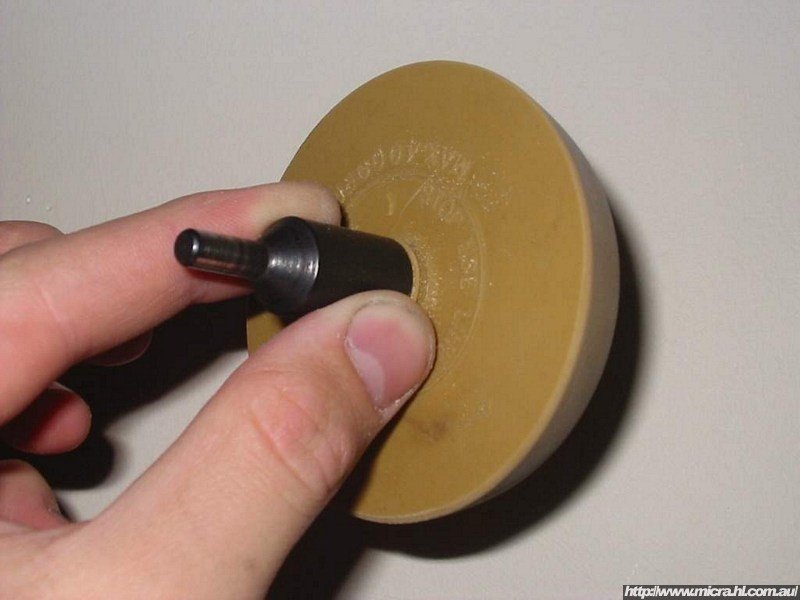

Zeddophile Posted September 26, 2008 Posted September 26, 2008 Its frustrating because I can't pull them off without destroying the paint in that area, and to respray is expensive and time consuming. Steve, there is a thing you can buy to put on a drill which will remove stickers without harming the paint at all. I call it a caramel wheel, because it smells like caramel, and basically it is a rubber disc about 2.5 inch in diameter which is designed for exactly this purpose (removing pinstriping etc). I have used one on a number of cars with suspect paint, and other than sometimes a bit of unfaded paint being uncovered under the sticker, the paint itself is undamaged. I'll try and find one on the net so that you can see what I mean. Quote
Zeddophile Posted September 26, 2008 Posted September 26, 2008 Here we go, buy one now! (ebay is a marvelous thing sometimes!) http://cgi.ebay.com.au/PINSTRIPE-REMOVAL-WHEEL-GREAT-LITTLE-TOOL-MUST-HAVE_W0QQitemZ220282537755QQihZ012QQcategoryZ43997QQtcZphotoQQcmdZViewItemQQ_trksidZp1742.m153.l1262 And a picture for those too lazy to go to ebay and look! I also saw another type made by 3m which was white in colour, but the ones i used were exactly as in the picture above, and I can vouch they work well. Ultimately if you go to a GOOD paint supply shop (maybe ask a well recommended panelbeater who they use), and ask for a pinstripe removal wheel, they should be able to help you out. Quote

stevo_gj Posted September 26, 2008 Posted September 26, 2008 Thanks Zeddophile, thats very cool! Is that the sort of thing I can use on the big black stripe that my car sports on each side? I think its a sticker of some sort. However, the 'Flamingo' and bird on my car are actually plastic/metal badges that the PO used some incredibly strong glue to stick in place. When I shut my boot lid too hard a few months ago the 'A' on my nissan badge (yep my car says NISSAN 280Z ) popped off along with a few mms of the red paint underneath it leaving a white colour that I assumed to be primer. I'm thinking that I'll have to sand it down and respray the area where the badges are all stuck on. Quote
Zeddophile Posted September 26, 2008 Posted September 26, 2008 Thanks Zeddophile, thats very cool! Is that the sort of thing I can use on the big black stripe that my car sports on each side? I think its a sticker of some sort. If its a sticker, that wheel will turn it to dust in a matter of seconds. If the sticker is really hard and baked on it may tend to leave smeary bits of sticker or gluey residue though, which you can get off with a bit of rubbing with wax and grease remover (Prepsol), and a bit more time on the caramel wheel. The effort is worth it in the end though, even if you end up having to cut and polish the whole car so the unfaded paint from underneath the sticker isn't noticeable. As far as the metal badges go, can you see any of the glue at all? If they've used sikaflex or araldyte you are in a bit of trouble to get it off... If its silicone based, you could try to carefully cut between the badge and the paint, which then gives you better access to the 'glue' itself, to try removing it. Petrol tends to argue with silicone, but I don't know how quickly it would work, and I'm also not sure on what effect it would have on acrylic paint if your car is painted in acrylic (strong possibility). Wax and grease remover definitely softens any sticker glues (the kind used on the back of factory Range Rover bonnet decals for example), and makes even the hardest glue soft enough to get off - just make sure you wipe a decent quantity onto the glue, and give it a minute or two to work depending on the glue. Incidentally my preferred method is to CAREFULLY use a razor blade in a trailing fashion (as in the sharp edge is angled AWAY from the direction of scraping), this gives you a big goobery ball of glue which you wipe off the razor blade and continue. If you don't wipe the blade the glue gets smeared everywhere, and it doesn't scrape as well. If carefull enough, you can do this without cutting or scratching the paint at all. If your Nissan280z badge was glued on with the same stuff, experiment - try soaking the glue on it with wax and grease remover, waiting 5 minutes or so and see if its going soft (unlikely if its silicon based, although I must admit I haven't tried it on silicone) Quote
stevo_gj Posted September 26, 2008 Posted September 26, 2008 If your Nissan280z badge was glued on with the same stuff, experiment - try soaking the glue on it with wax and grease remover, waiting 5 minutes or so and see if its going soft (unlikely if its silicon based, although I must admit I haven't tried it on silicone) Cheers mate, appreciate the advice. I'll have a crack at it soon. Quote

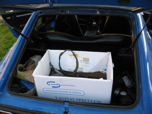

Hunter Posted September 27, 2008 Posted September 27, 2008 This is not my car, but the box in the back certainly was an odd finding. Quote
Dingo Dave Posted September 29, 2008 Posted September 29, 2008 hmm very odd finding. i know a guy who got a 2 year old falcon. when he was updating the sound system he puller the back seat up and found like 100 condom rapers. no used ones forfunatly. Quote
