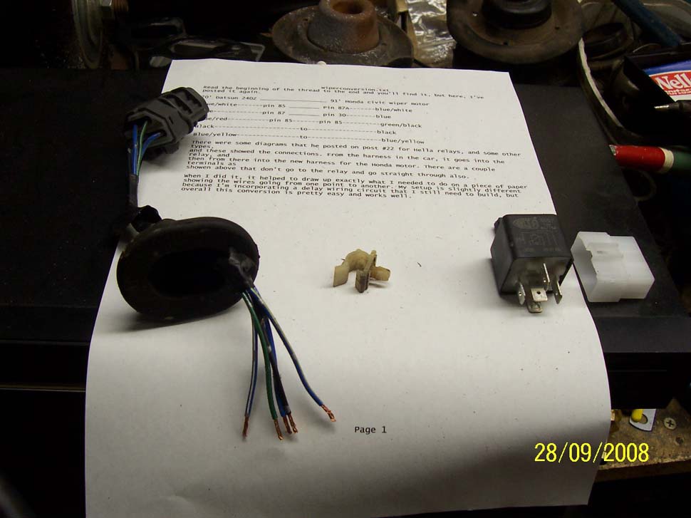

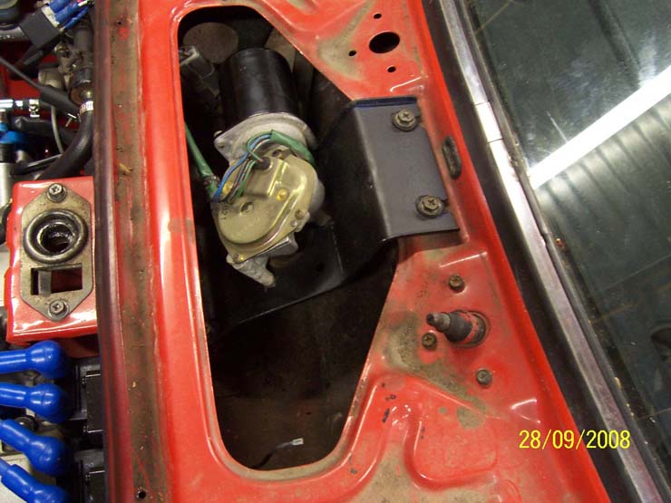

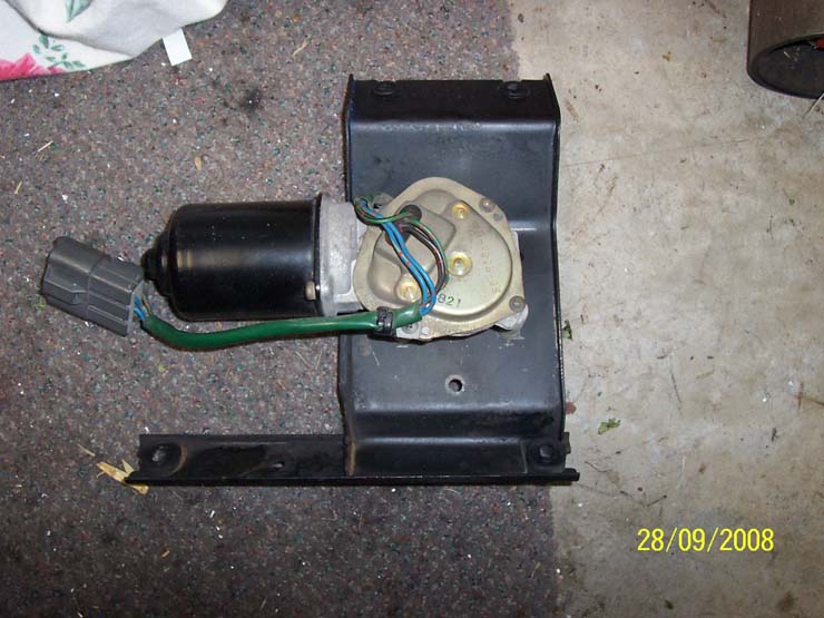

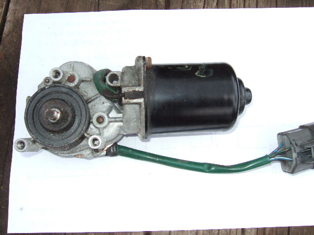

Moderators Zedman240® Posted September 20, 2008 Author Moderators Posted September 20, 2008 Just come back from the wrecker; and found that the correct motor (well the car I pulled it out from was a Aug 93 Civic). All the earlier 89-91 Civics had that "spider" type motor fitted. If it has 4 alloy mounting lugs to the firewall, keep looking! Another little difference is that LHD Civics in the U.S. have a slightly different gearbox on the motor. Looked at the HybridZ site and its OK; another guy there found a motor out of a 95 Civic "UK Spec" and it is the same as my RHD motor. I'll take some pics while I'm converting but for now some pics I found on the HybridZ site: Pic of both motors compared (US style) Second pic is RHD motor fitted.. Third pic is what motor you will find at the wreckers.. Quote
Moderators Zedman240® Posted October 4, 2008 Author Moderators Posted October 4, 2008 Finished the Honda motor upgrade with no real issues. Found out my 2nd speed doesn't work thanks to my switch! It all went together very easily. Took some pics along the way; helpful for a guide to diy. I also found I have two right hand wiper arms; they are both the same length. I'll have to search around for a shorter one so I can get a proper wipe on the windscreen. Quote

Moderators Zedman240® Posted October 7, 2008 Author Moderators Posted October 7, 2008 In that HybridZ post, a member just wired in a 5 pin relay (with a 87a terminal) and that supplies 12v to the motor even when the switch is off until the motor returns to its "park position" and then the internal switch in the gearbox itself disconnects the power. then its ready for another cycle to begin when the wiper switch is turned to "on". I think that's how it is!! Quote
