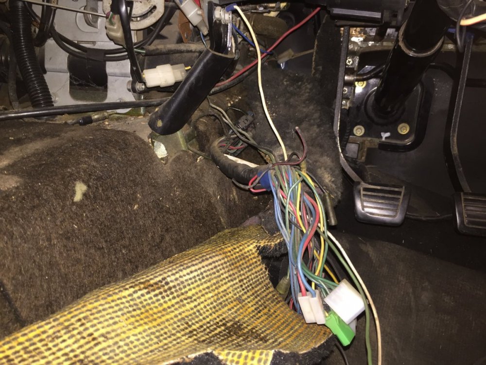

Oversteer Posted June 14, 2021 Posted June 14, 2021 Hello I'm trying to sort out the wiring in my 260Z, someone before pretty much butchered things to the point of extending the wiring and mounting the flasher units, aux relay, horn relay, passing relay and int wiper relay under the drivers seat ! For god knows what reason !, car does have a electric power steer column but as far as I can tell thats not really causing the space issue, the motor/gearbox of the EPAS unit is all to the left of the column. I have removed all the extra wiring and got everything to work, which was pretty painful with the wiring diagrams that are available. Anyway I want to now mount all those relays etc back where they are supposed to be, I'm guessing above the drivers kick panel/fuse box area !? Does anyone have a picture or diagram that shows where and how they mount ? Pic is where I'm at, I currently have whole dash and steering column out, it just sitting across the gear stick so I can plug everything in to test stuff. Cheers Justin Quote

Oversteer Posted June 14, 2021 Author Posted June 14, 2021 Ok so all those relays bolt to the side there ? Ok will try look for bolt holes etc, harness has been cut apart, joined then taped up again with extra wires so it may be a bit of a puzzle ! Quote

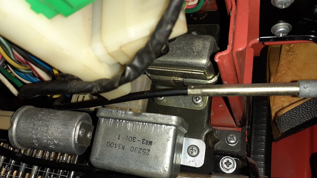

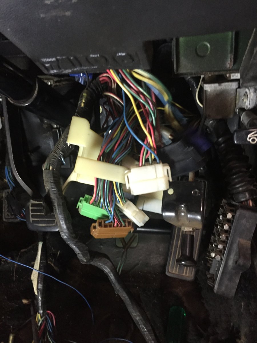

Millerman Posted June 14, 2021 Posted June 14, 2021 This is my 2+2 is this what you are after? This is one i took when i was taking a my dash out. Hopefully might tell you the right story haha Quote

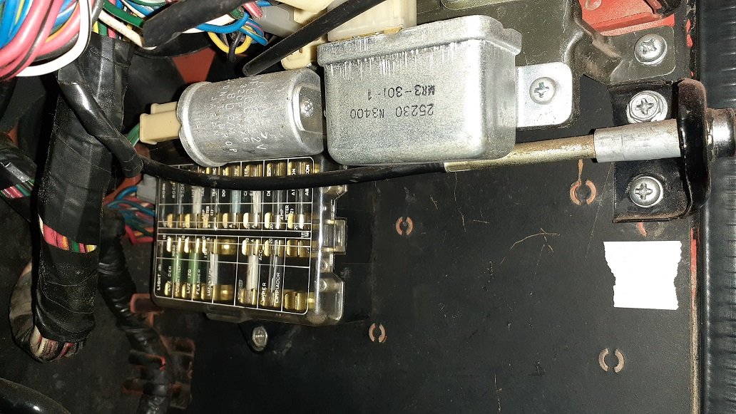

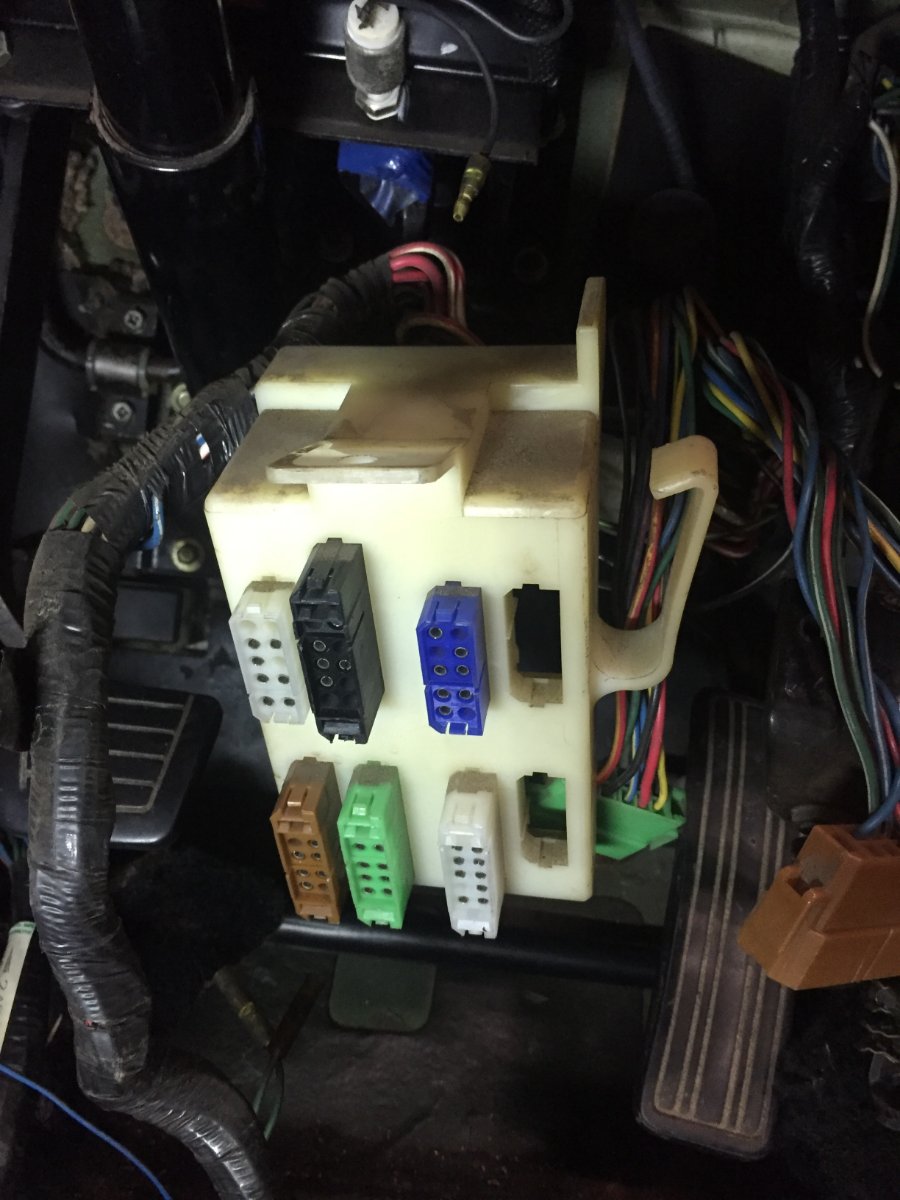

gilltech Posted June 14, 2021 Posted June 14, 2021 And mine lower down at fuse box. Do you have the cardboard backing panel? Imprints and holes through that would help position the various items. Quote

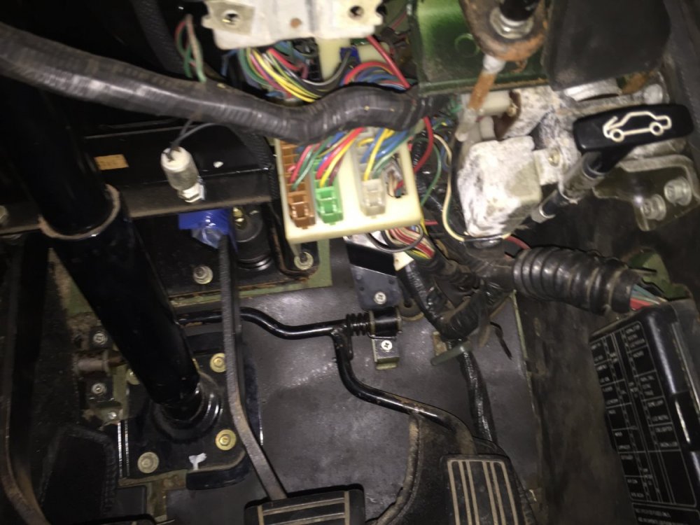

Oversteer Posted June 15, 2021 Author Posted June 15, 2021 Thanks for the photos people It looks like I'm missing a bracket that all that stuff mounts to then the bracket bolts to the car... I'll have to try make something, which needs to not interfer with the dash going back in etc. gilltech - If you get a chance can you snap a pic that shows the bottom of the dash frame and where it sits so I can see where not to put stuff/bracket !? Quote

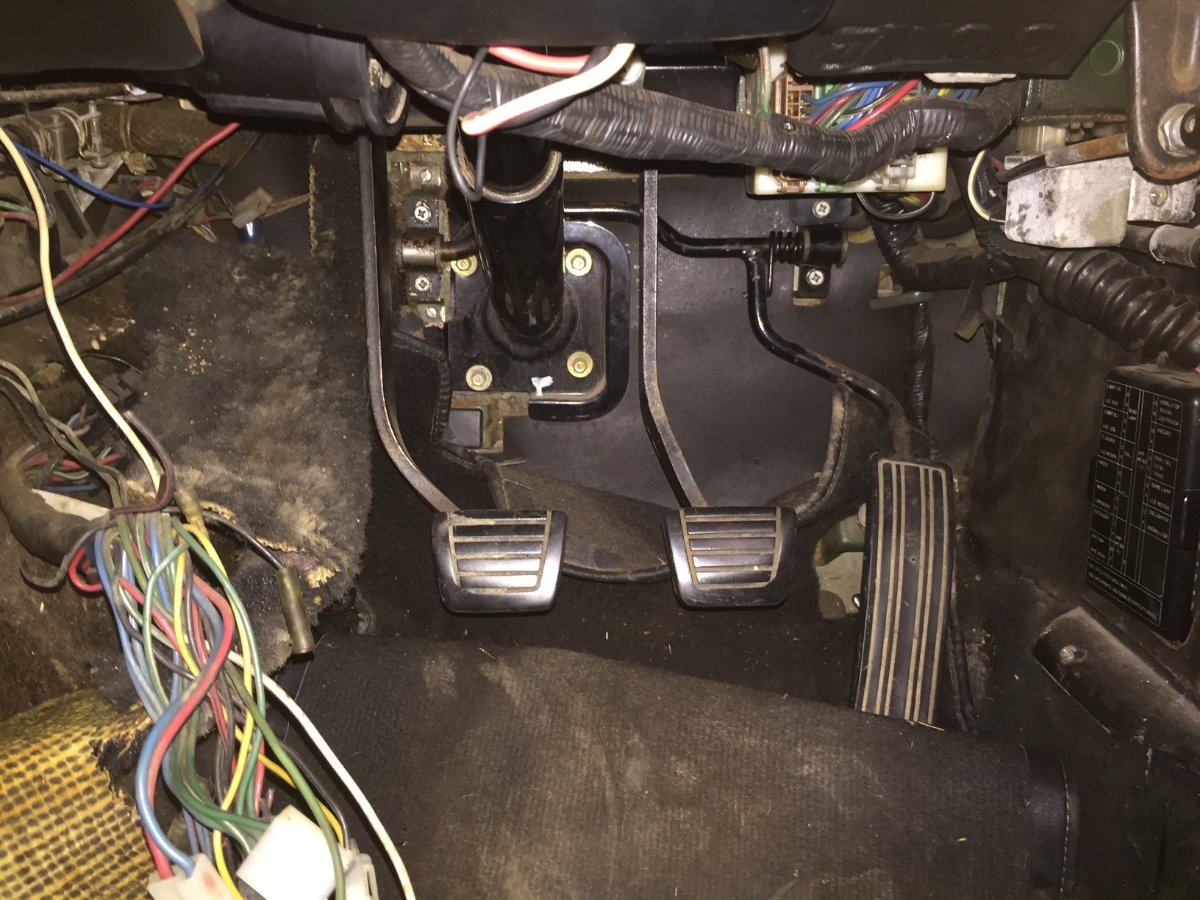

gilltech Posted June 15, 2021 Posted June 15, 2021 Here's another. I'll take a look tomorrow, just very hard to photograph with the car all complete with steering column in the way. Quote

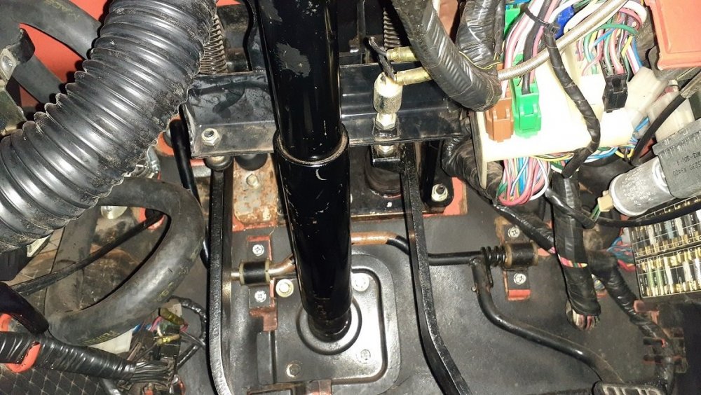

gilltech Posted June 16, 2021 Posted June 16, 2021 (edited) OK here's a shot looking up from the footwell. This is a very early '74 RS30 in original condition (with the exception of the pair of DIY-fix generic heater hoses looped around to make the tight turn). Very little else has been disturbed. This is a NZ-new car, IMO a 'basic equipment' level (only electrical 'extra' is a hazard lights switch), so your car may have more relays and wiring on the upper RH side for other electrical stuff which this car doesn't have, judging by what I've seen on later and/or Aus-spec 260Zs. Edited June 16, 2021 by gilltech Hope this helps. Quote

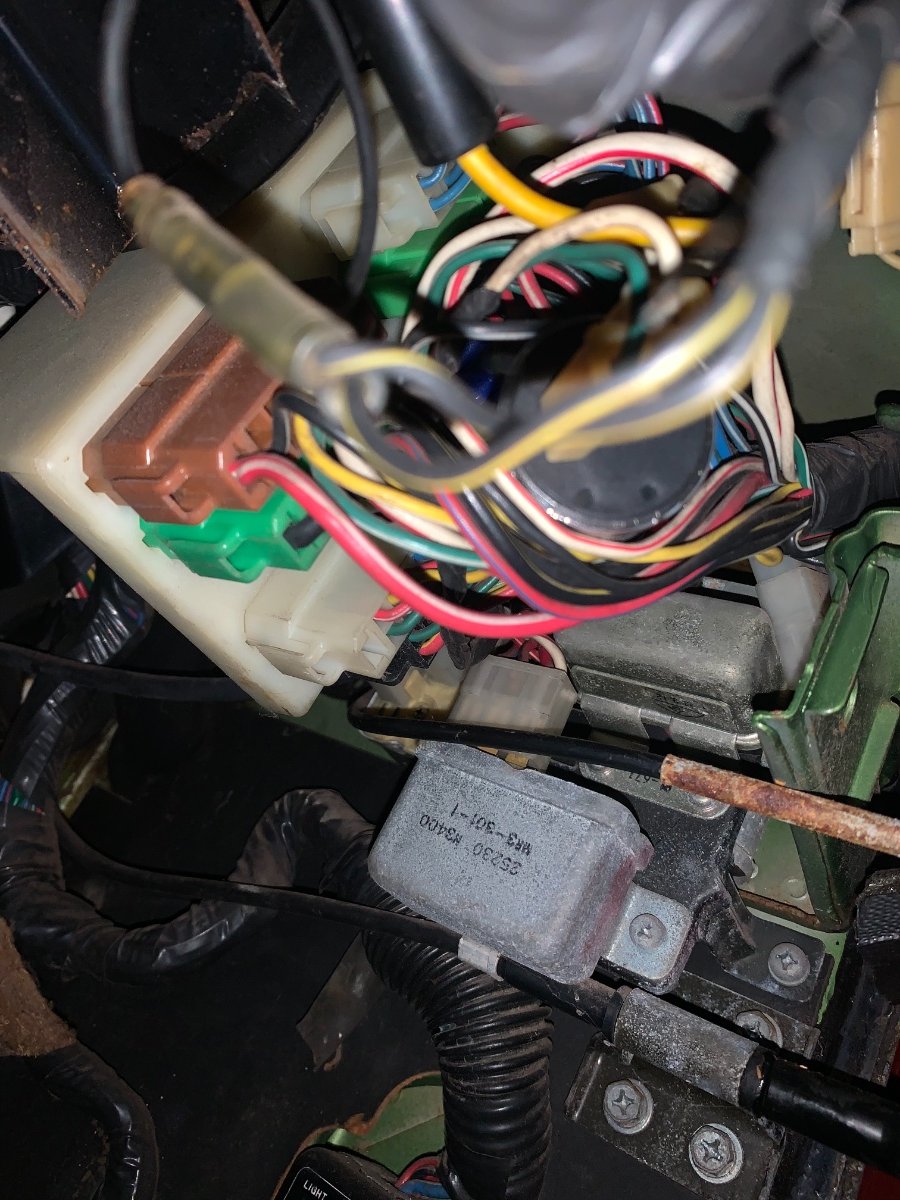

RestoZ Posted June 16, 2021 Posted June 16, 2021 A bit late into this discussion but some pictures below which might help. Mine is a '76 260z 2+2. Quote

Oversteer Posted June 17, 2021 Author Posted June 17, 2021 What the relays etc are screwed too with Philips head 6mm bolts is a bracket that is then screwed to the kick panel of the car... In my last post I drew a red arrow(badly) just below the bonnet release cable pointing to the bracket which is grey/greeny colour, the Philips screw directly under the red bonnet release main bracket(which is spot welded to car) holds the bracket I want to the car, I'm sure there are more screws elsewhere also which I can not see... Quote
gilltech Posted June 18, 2021 Posted June 18, 2021 Oh righto, I hadn't spotted the faint red arrow on the photo... I guess you'll have to track one down from a car being parted out. I had a look to see what bits are with my spare loom but no joy. Quote
