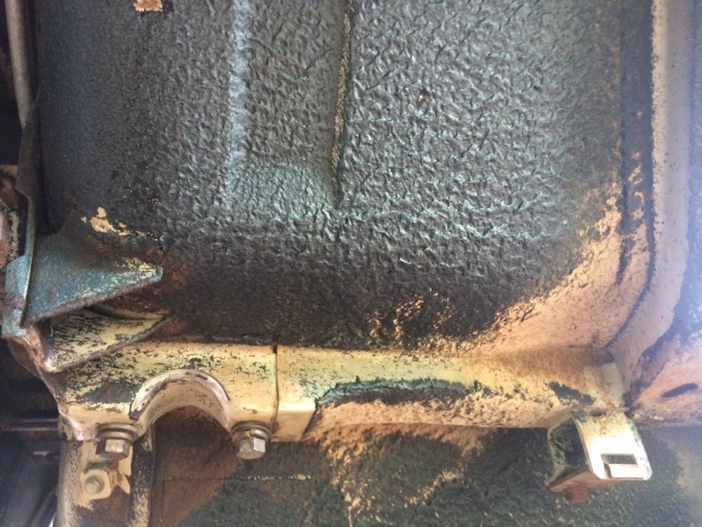

AndBir Posted June 6, 2021 Posted June 6, 2021 (edited) On 6/5/2021 at 8:31 PM, gilltech said: As for the primer, on my RS30 it's more of a cream colour (faintest hint of green) rather than a grey. Based on my early 260z there is cream coloured "primer" on the parts of the body that may have had stone chip coating but internally still had the grey primer. Edited June 7, 2021 by AndBir correct photo Quote

gilltech Posted June 7, 2021 Posted June 7, 2021 Quote Bonnet hinges WERE painted - body colour, after assembly on the car Well that would explain the lack of paint coverage in some places and paint runs in others! Awkward things to paint on or off the car, given all the concealed faces whether they are extended or closed. Recently I removed mine as they had got so daggy they spoiled the look of the engine bay, so I cleaned them back to expose the plated finish and they can stay like that meantime. Maybe I'll paint them, maybe I'll just have them replated as there are areas around the pivots where the plating has worn off and will rust again. Quote Based on my early 260z there is cream coloured "primer" on the parts of the body that may have had stone chip coating but internally still had the grey primer. Ditto AFAIK, never having stripped the car totally down to its shell. Cream primer externally, grey primer internally. Different formulas perhaps? Quote
