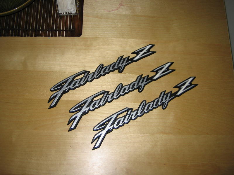

Toecutter Posted January 2, 2006 Author Posted January 2, 2006 Thanks Lambs. Ash has got a pair of them. I hope to see a finished set of three when I get back from holidays. We discussed making copies of the original steel ones in plastic but I was still curious about their background. I really like the look of them. Will post some pics as soon as they're done. Thanks for the history, and additional info. Cheers Sulio Quote

Toecutter Posted January 8, 2006 Author Posted January 8, 2006 Hey Crowe, it's quite easy I just used Macromedia's Flash, it has a tutorial section as a good guide for first time users, if you have a play you'll pick it up easily I reckon. Picked up badges from Ash's and I painted them to original within an hour. Quote
zr240 Posted January 8, 2006 Posted January 8, 2006 nice job sulio they look like the originals!! Ash Quote
NZeder Posted January 8, 2006 Posted January 8, 2006 wow they look good - so Sulio/Ash want to do another set - I would be keen they are good looking replica's very Quote
Toecutter Posted January 8, 2006 Author Posted January 8, 2006 Hey NZeder, I belive Ash will be selling blanks for AUD$35 ea so best to talk to him as he's the one making them. I'm sure he will chime in shortly on this thread. He's selling them blank. It was'nt very hard for me to paint them up. I used a flexible primer, followed by matt black all over except for the Z which I filled up with blue tack. When matt black was dry I sprayed the silver on card board and then dropped the badge face on the wet paint and pulled it off after a few seconds. Once dry I pulled out the blue tack and gave it a clear coat to finish it off. All the paint was in small $5 pressure pack cans I bought from the local auto shop and the whole thing took me about 45 minutes. Cheers Sulio Quote

Toecutter Posted January 8, 2006 Author Posted January 8, 2006 Gav, the originals are as I painted these not chrome. Evan, I'll just use double sided tape to stick them on. Quote
zr240 Posted January 8, 2006 Posted January 8, 2006 Hi guys Yer as sulio mentioned I will be selling the blank badges for $35 each so peolple can paint them or chrome or whatever to suit your car. Just pm me if you are after some Thanks Ash Quote
