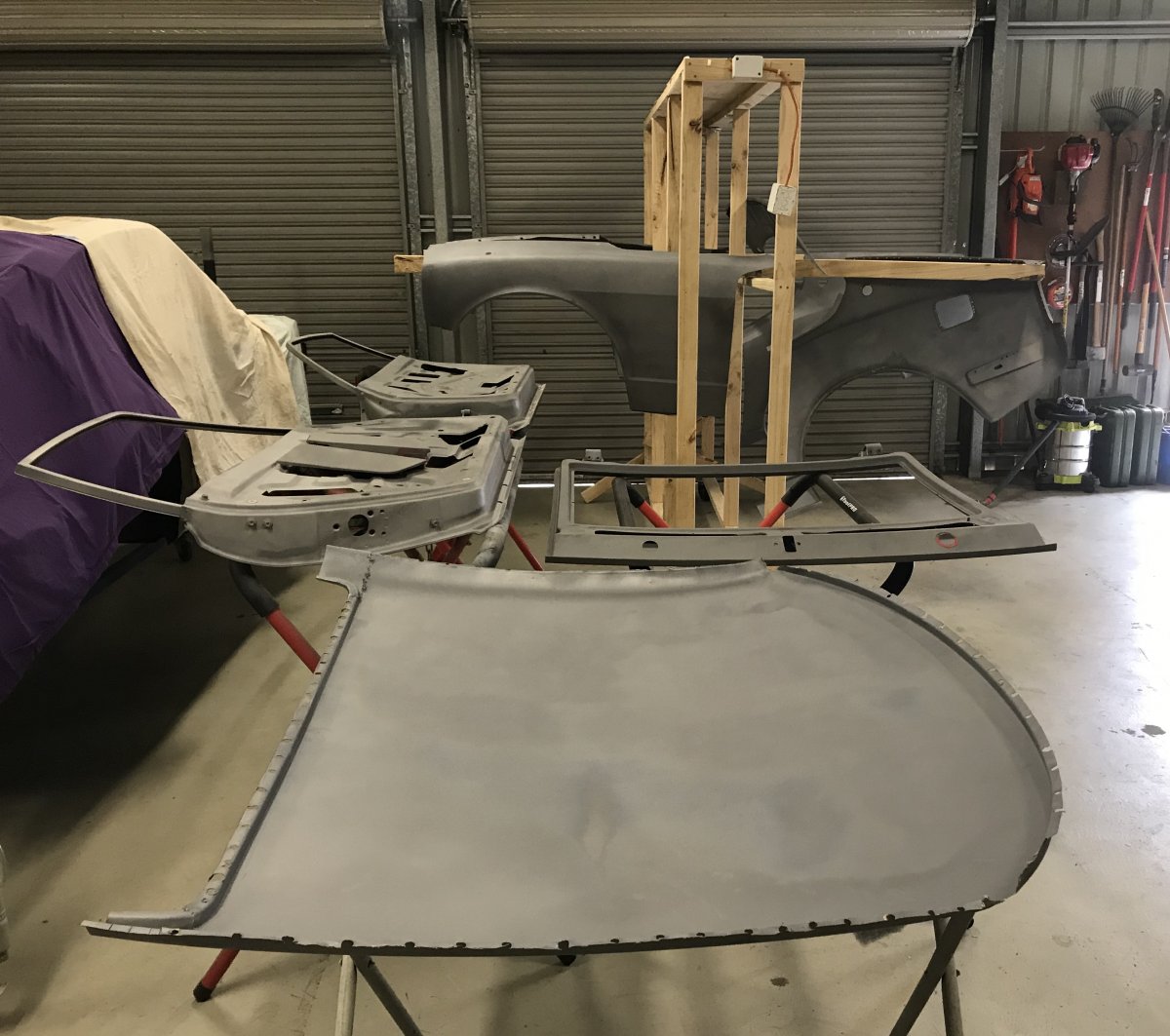

Robdog Posted December 9, 2019 Posted December 9, 2019 Hey guys, looking for some opinions on possibly using adhesive to secure the roof skin on my 240. It has been removed before by the look of the welds I had to drill out, ie not stock spot welds. I did so to repair rust in the A pillars and seem between roof and rear quarter. so the roof skin needs some work to repair the flange that sits in the gutters etc, but to put it back on, has anyone just used panel bond to avoid heat? thought it might give better water protection for this area as well? Quote

Robdog Posted September 8, 2020 Author Posted September 8, 2020 Still no further along with this, other than the roof being coated in epoxy primer but still needs repair. The rust under the roof predominant was in each corner where the lead filler was originally used. There was also some brazing done to plug some holes. This was where the rust had effected the pillars. As mentioned, this roof had been off before or more likely was from a donor. Once I got the roof off It looked like the roof subframe had been struck and slightly squashed. The rust holes were reasonably small patches with some pitting, but my main concern now was the quantity of mig weld used to pin the roof down. I had to make fairly large holes in the gutters to get it off, so roof repairs are the priority, and I’m thinking of employing a more experienced hand for this. I’ll try to dig out some pics 240ZBUILTBYME 1 Quote
