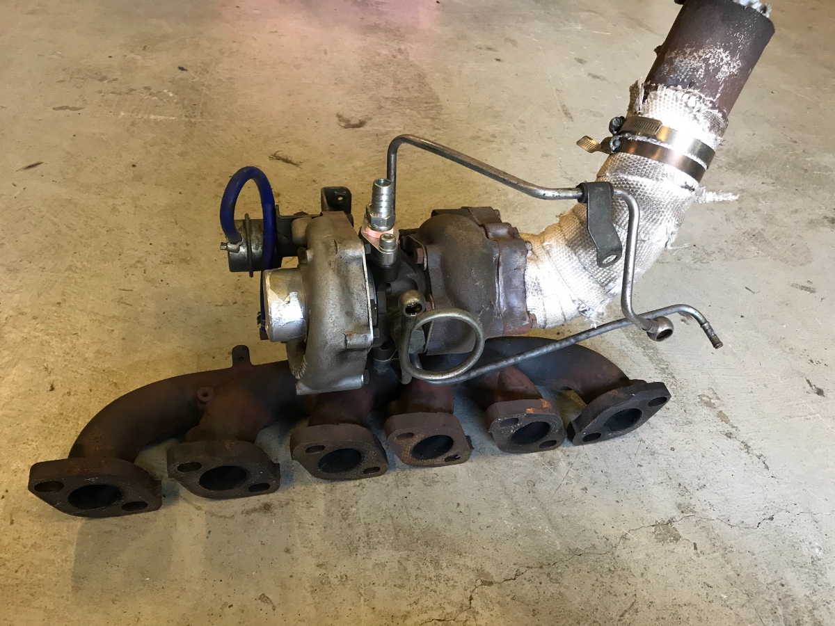

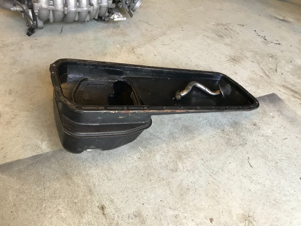

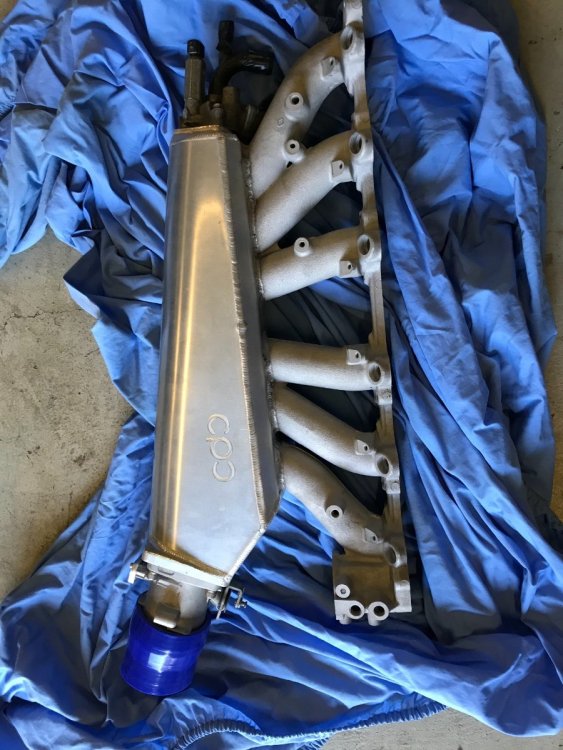

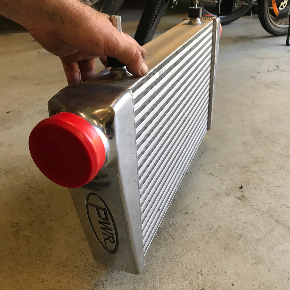

  16. All these parts are available because I backed out of the Rb build. Inevitably make a loss due to changing my mind. Hopefully it will make someone else happy.
  17. I recently sold two rb30’s, one was out of a 260 and was a s2 n/a converted to turbo. If of course you’re interested in forced induction I still have the turbo and exhaust manifold, as well as a castlemaine (front) EDIT... (rear)sump. I also have a brand new cpc forward facing manifold with a xf falcon throttle body that will fit nicely in the z engine bay and a pwr cooler. If nothing else the sump may be of use? You just need the long block Rb30 S2
