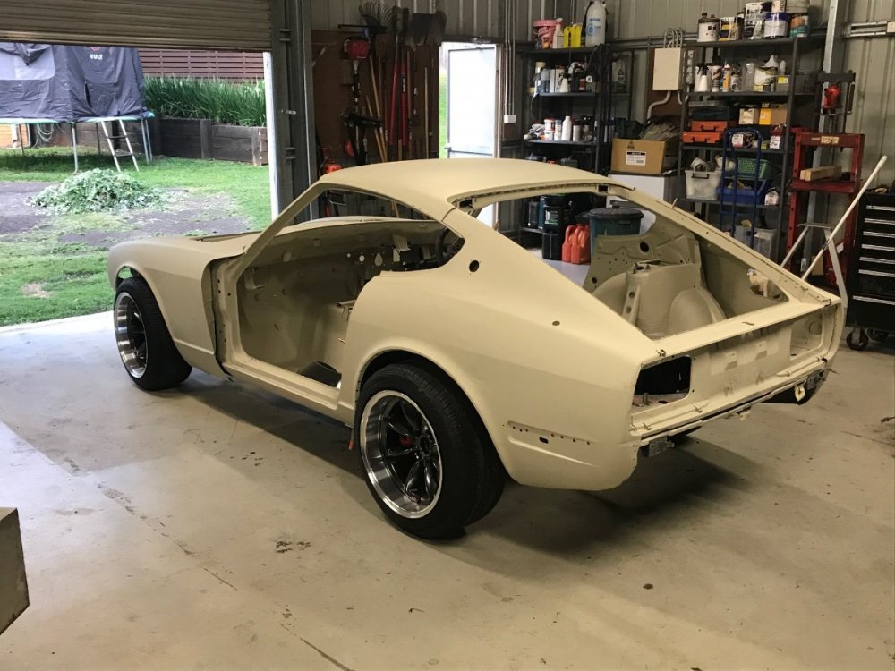

  8. Hi Guys, bought my car some 12 years ago as a rolling shell in Sydney, and from then on I have been lurking in this site, which has been a great resource of information mind you. So thank you for the years of help. Personal I’ve never driven a zed! That’s right never! but I’ve been compelled since enjoying ownership of a ta22 celica when I was younger, to complete the resto mod under mostly my own steam (re the duration) after falling in love the the lines of the 240z. many won’t subscribe to my choice of power plant, however I’ve done my best to leave the body alone. Many more years of work to come in my minimal spare time no doubt, but progress is progress. Getting to the stage where I’ll need a professional hand with final body work. Cheers guys merry Christmas Rob
