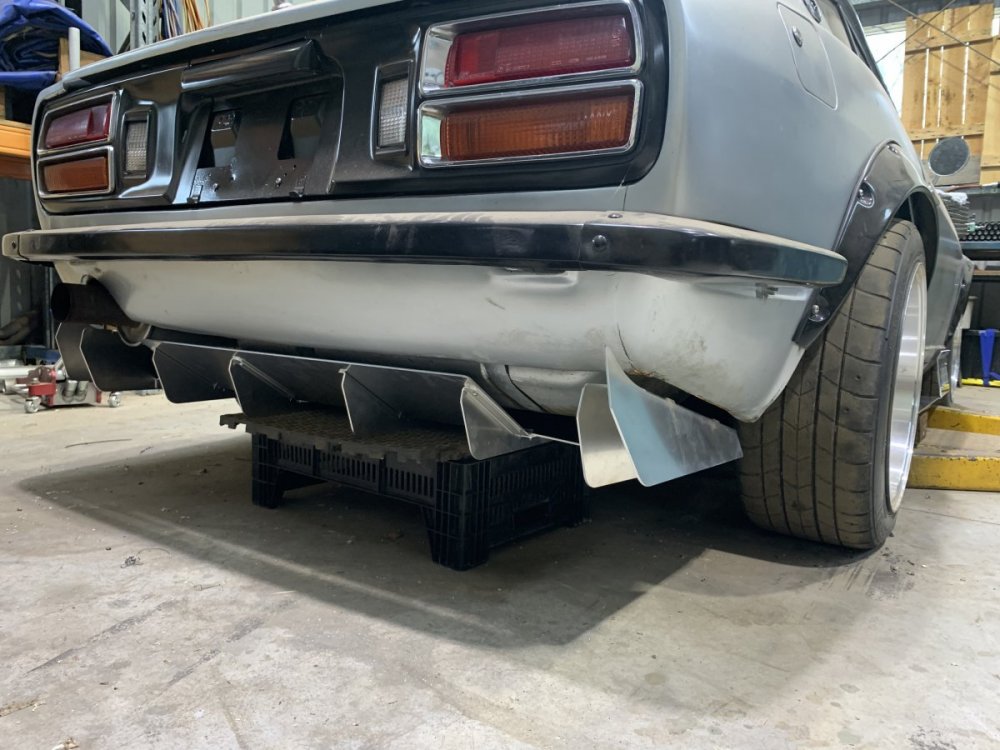

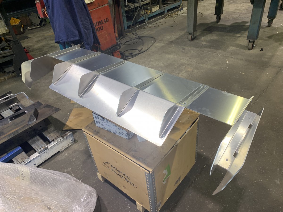

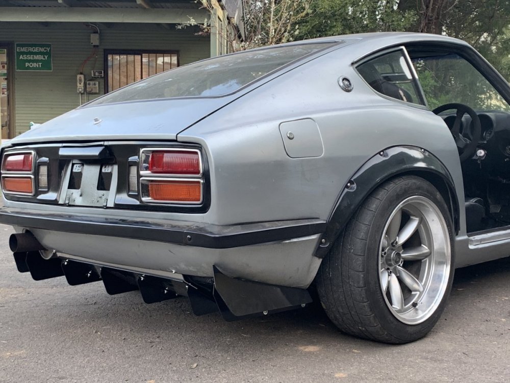

Mqhoon Posted April 14, 2019 Posted April 14, 2019 (edited) i actually couldn’t be bothered selling my laser cut parts as it’s not worth my time i only made my own as its my hobby Edited July 20, 2019 by Mqhoon Not for sale Quote

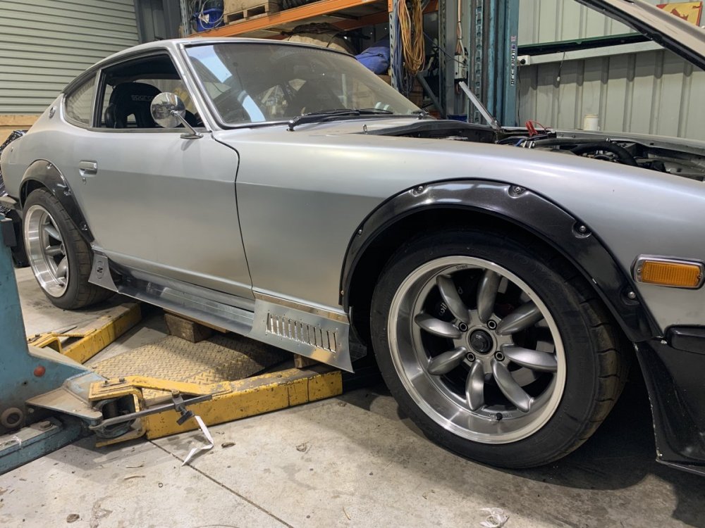

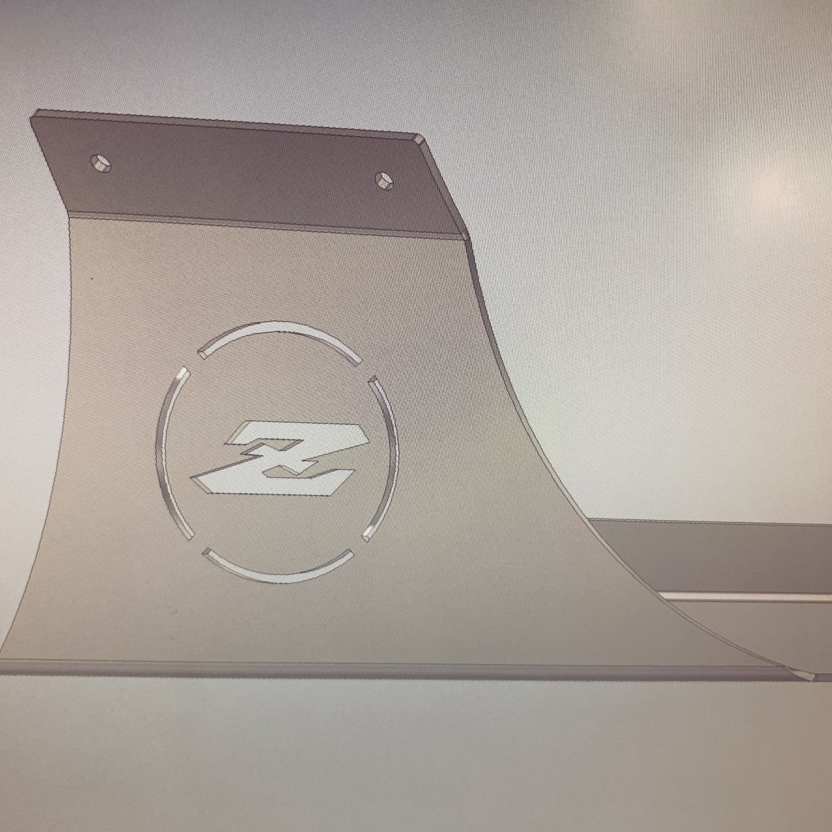

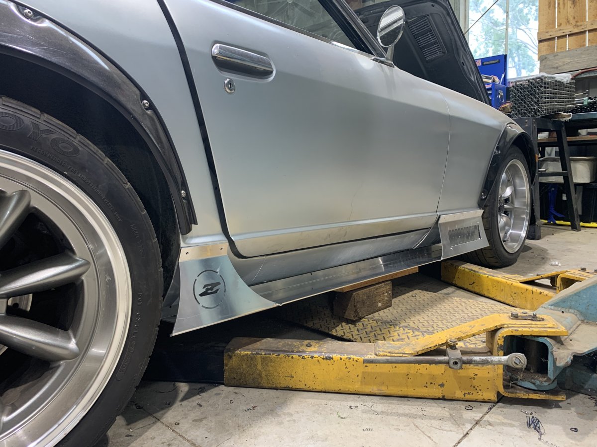

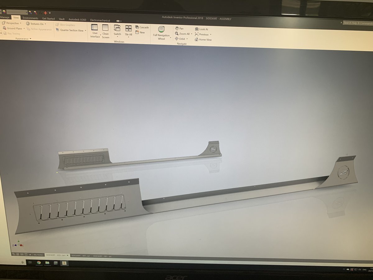

Mqhoon Posted April 14, 2019 Author Posted April 14, 2019 Also did side skirts if anyone interested 0424436629 Quote
chamboz Posted April 14, 2019 Posted April 14, 2019 Looks great! where does the rear diffuser mount off? And what kind of pricing for these? Quote
Mqhoon Posted April 14, 2019 Author Posted April 14, 2019 1 minute ago, chamboz said: Looks great! where does the rear diffuser mount off? And what kind of pricing for these? Unfortunately you have to put some holes in the body under the rear guards and the rear skirt part under the bumper and 2 mounts in under the fuel tank at the front id have to say at least $300 in laser cutting and folding Quote

MaygZ Posted June 20, 2019 Posted June 20, 2019 I don't want to be a party pooper, but your side skirts do not comply with the ADRs and would make a vehicle unroadworthy. All forward facing protrusions from the vehicle must have a radius of at least 10mm to comply. It doesn't look to be difficult to alter your skirts to comply, but that may have an affect on the aesthetics. MaygZ peter t and gilltech 2 Quote
Mqhoon Posted June 21, 2019 Author Posted June 21, 2019 21 hours ago, MaygZ said: I don't want to be a party pooper, but your side skirts do not comply with the ADRs and would make a vehicle unroadworthy. All forward facing protrusions from the vehicle must have a radius of at least 10mm to comply. It doesn't look to be difficult to alter your skirts to comply, but that may have an affect on the aesthetics. MaygZ I don’t want to be a party pooper but do you see license plates on my car Quote

sidedraught Posted August 14, 2019 Posted August 14, 2019 You have made a really nice job of that diffuser, good luck with it. Quote
