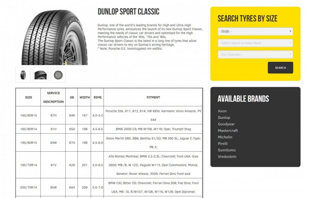

That is the way I think I will go at this stage (@ $125 each) vs the Dunlop 195/70R14 Sport Classic @ $270ea
The "classic" tyre ranges are usually made in the higher performance compounds so will still allow you to extract some performance, while the passenger type tyres in the standard specs for 14 inch tyres will just be passenger car type compound made for decent road performance in wet and dry and long tyre life. FYI
