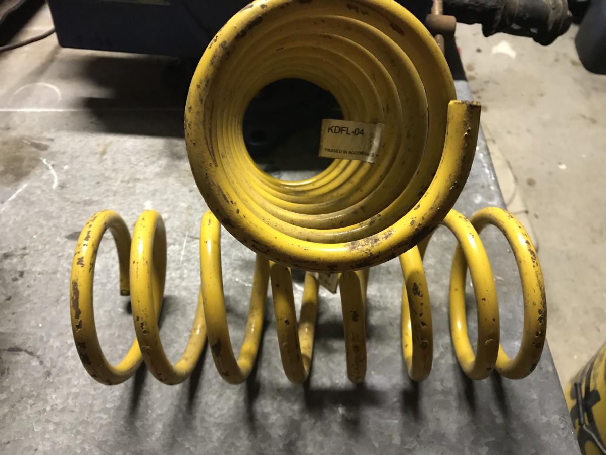

Cozza Posted May 18, 2018 Posted May 18, 2018 Yep I have a pair of KDFL-04’s. They are a little beaten up but they still have their original tag, I don’t think they have ever been used. PB260Z 1 Quote
Kuba Posted May 18, 2018 Author Posted May 18, 2018 Yep I have a pair of KDFL-04’s. They are a little beaten up but they still have their original tag, I don’t think they have ever been used. BD8D6D5B-1B52-45BD-A80F-CADDB294C0B3.jpeg PM sent. Quote
