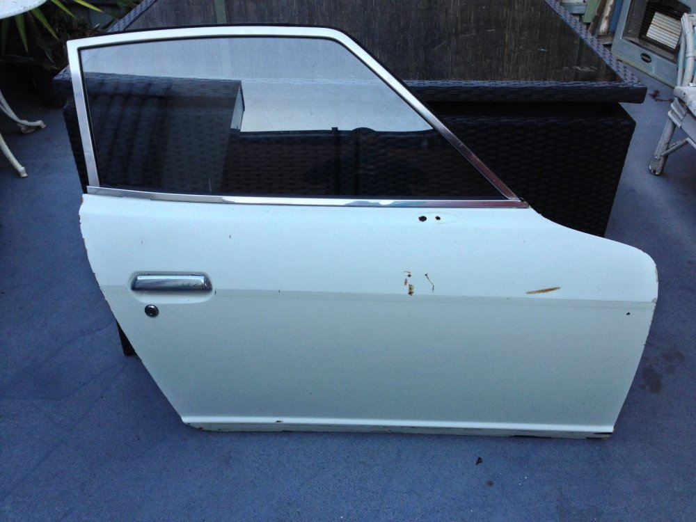

AndBir Posted February 8, 2018 Posted February 8, 2018 Maybe contact this ebay seller and check if this one is compatible: https://www.ebay.com.au/itm/DATSUN-260Z-RHS-Drivers-Door-rare-late-1976-onwards-/192351736185?nma=true&si=lbagRzK8upN8GcUOkEZuGanhye8%253D&orig_cvip=true&rt=nc&_trksid=p2047675.l2557 Quote

260z blues Posted February 9, 2018 Author Posted February 9, 2018 That door looks okay. Im fairly new to buying parts for these. Is this a premium price or normal.? Quote
gilltech Posted February 9, 2018 Posted February 9, 2018 (edited) Is this a premium price or normal.? Hard to say with just one photo re shell condition, but the glass is in it & presumably the winder gear so that's probably fair. It's sold now anyway. But you need to do what Brabham advised & post a photo of your door latch - early & late 260Z doors are quite different & not interchangeable & if your car is a '76 then it's right in the middle so who knows which it is. Edited February 9, 2018 by gilltech Quote

gilltech Posted February 12, 2018 Posted February 12, 2018 That white door must be off a later 260 as the latch is completely different to my '74. 280zUSA 1 Quote
