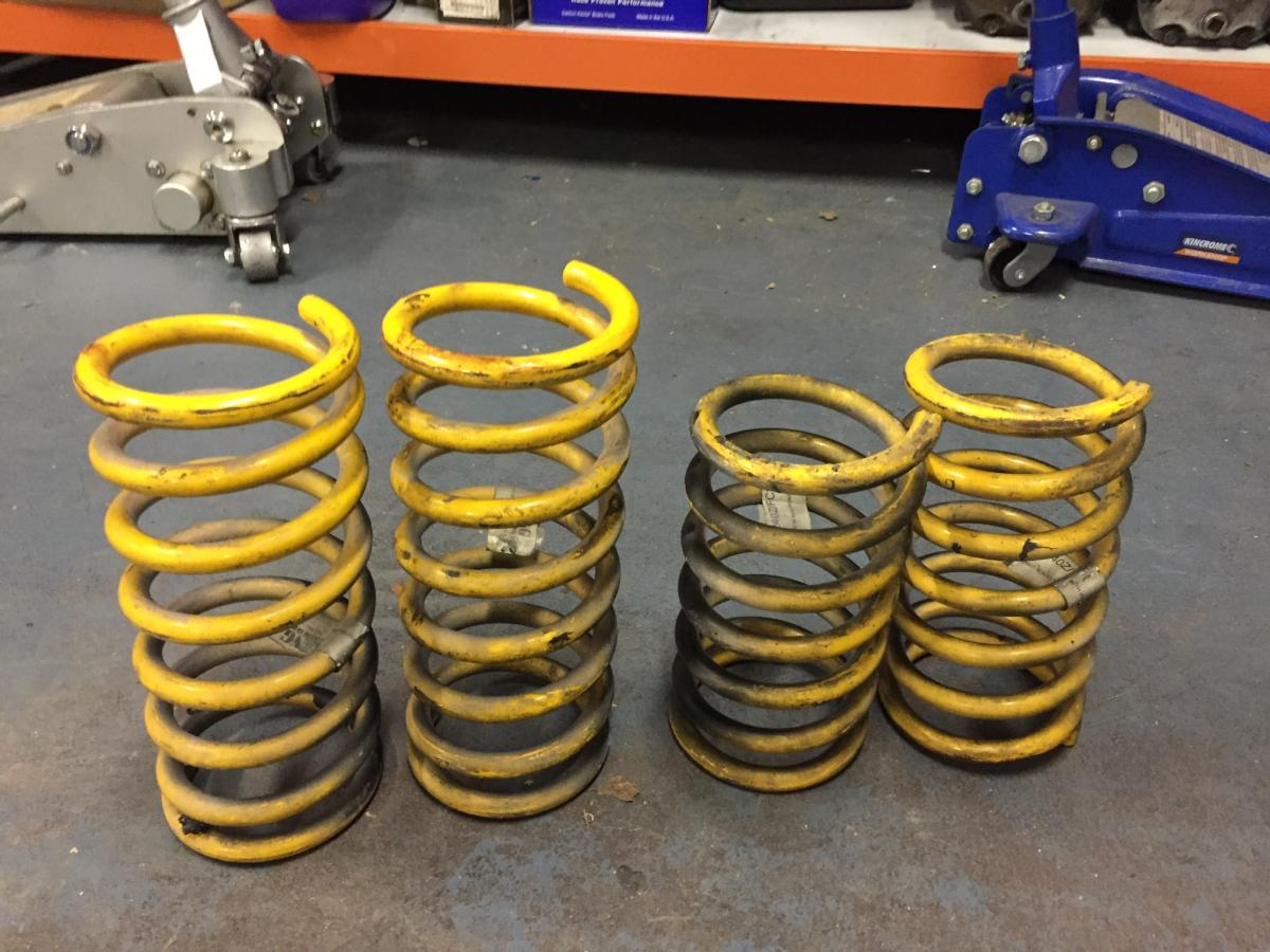

hmd Posted December 11, 2017 Author Posted December 11, 2017 They only made one version of it, to be honest I can't tell you how low it lowered the car. Quote
theremm Posted December 12, 2017 Posted December 12, 2017 What year is your 240z and how long have you had them for? How did you find them? Quote
hmd Posted December 12, 2017 Author Posted December 12, 2017 1972. Had it in the race car when I bought it, I went to heavier rated spring. The car was not super low at all just about right but that is my opinion. The springs are in good condition but got oversprayed on them. theremm 1 Quote
Administrators gav240z Posted December 12, 2017 Administrators Posted December 12, 2017 I have these in my 72 240z if it helps give you an idea as to how low it is. hmd 1 Quote
twoforty z Posted December 12, 2017 Posted December 12, 2017 (edited) King Lows lower 30mm and are 165lbs amd 180lbs and are progressive (stated by Kings) Hope this helps. I have a set ill be trying after i found my Tokico springs too hard for street use Edited December 12, 2017 by twoforty z hmd 1 Quote
Administrators gav240z Posted December 12, 2017 Administrators Posted December 12, 2017 It's not the springs, it's the Tokico Illuminas (in white) shocks that are too hard. Anything other than the lowest setting is bone jarring. GongZ 1 Quote
Cozza Posted December 12, 2017 Posted December 12, 2017 It's not the springs, it's the Tokico Illuminas (in white) shocks that are too hard. Anything other than the lowest setting is bone jarring. Can’t say I find that with my Illuminas. I generally have mine set at 3 front and 2 rear for the road and 5 front 4 rear for the track. I have my Tokico springs tested for the rate. I can’t remember the results off hand but where significantly lower than the king lows. I have read of quite a few people say the tokico springs are so low and limp that the shocks bottom out. Quote
Administrators gav240z Posted December 12, 2017 Administrators Posted December 12, 2017 Dalee and I discussed it at the BBQ. I find them fine on the first setting but too hard on 3-5. I don't know if King Springs are a good match for the shocks however. It's on the to do list. ? Quote
