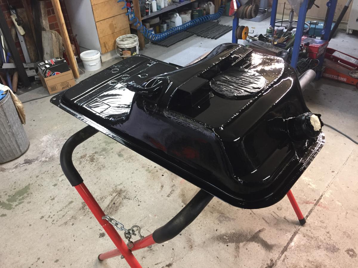

Something like this pot, filter, low & high pressure all-in-one in-tank system that I built for Jeff?
Edited by Lurch ™
Stock tank, R200 with its moustache, a 2 litre pot and pre-filter, and a Bosch 044, all fit
On the drivers side, not directly behind diff.
