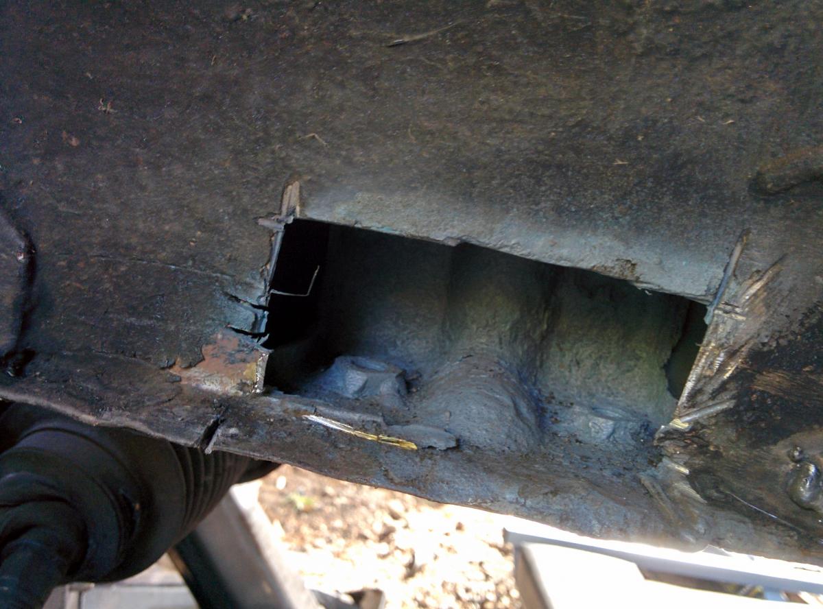

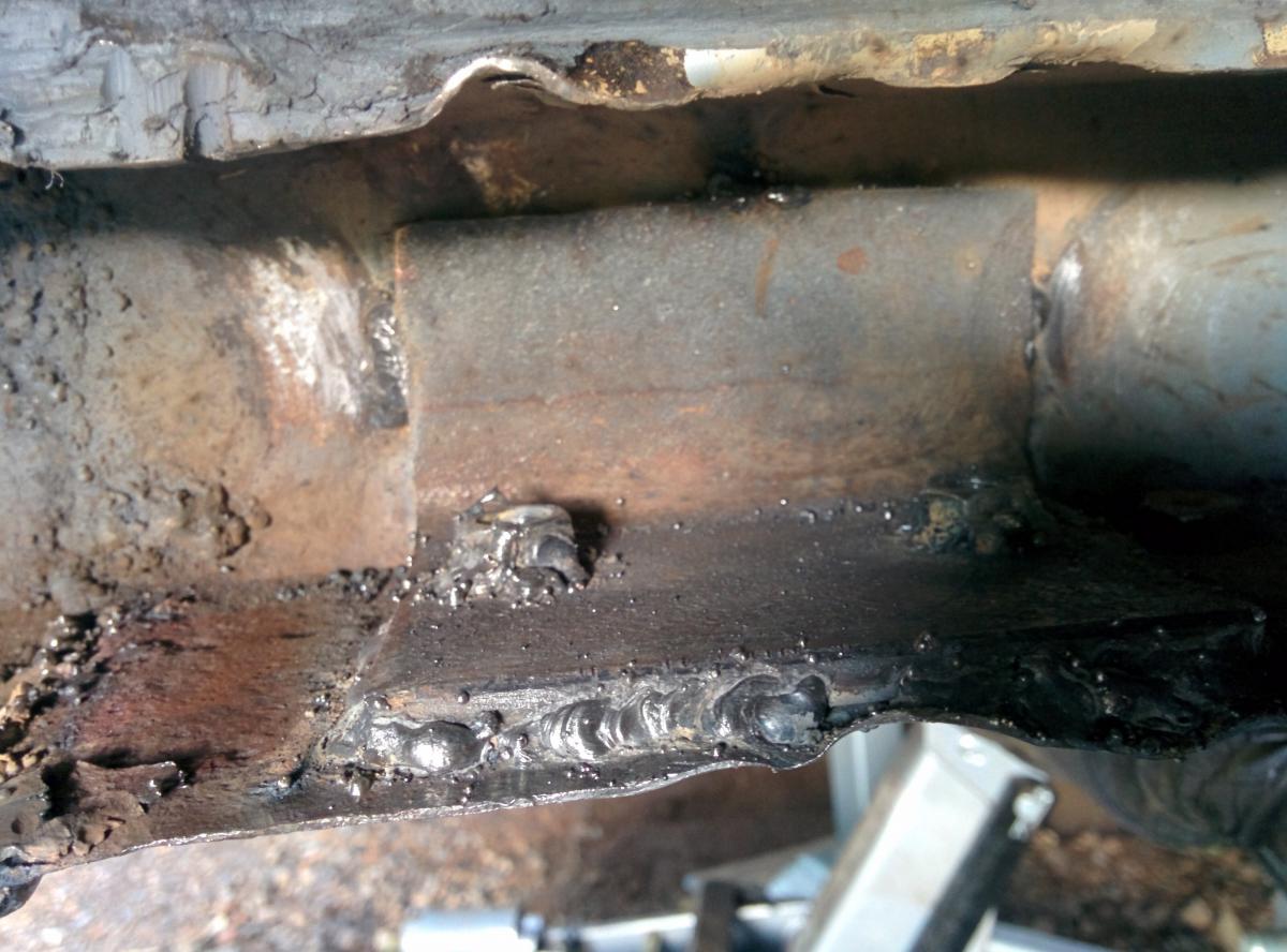

You should be able to cut out the inner arch down the bottom and access it. You could either repair what's there or replace it with a piece of angle iron which is what I did (welding new nuts on/tapping the angle iron)
What it looks like inside
Replaced with angle iron
Also, I would run a tap through all the other holes to clean them out, using plenty of WD-40 in the process. Also make sure you replace the bolts with high tensile as they can be under a fair bit of force.
