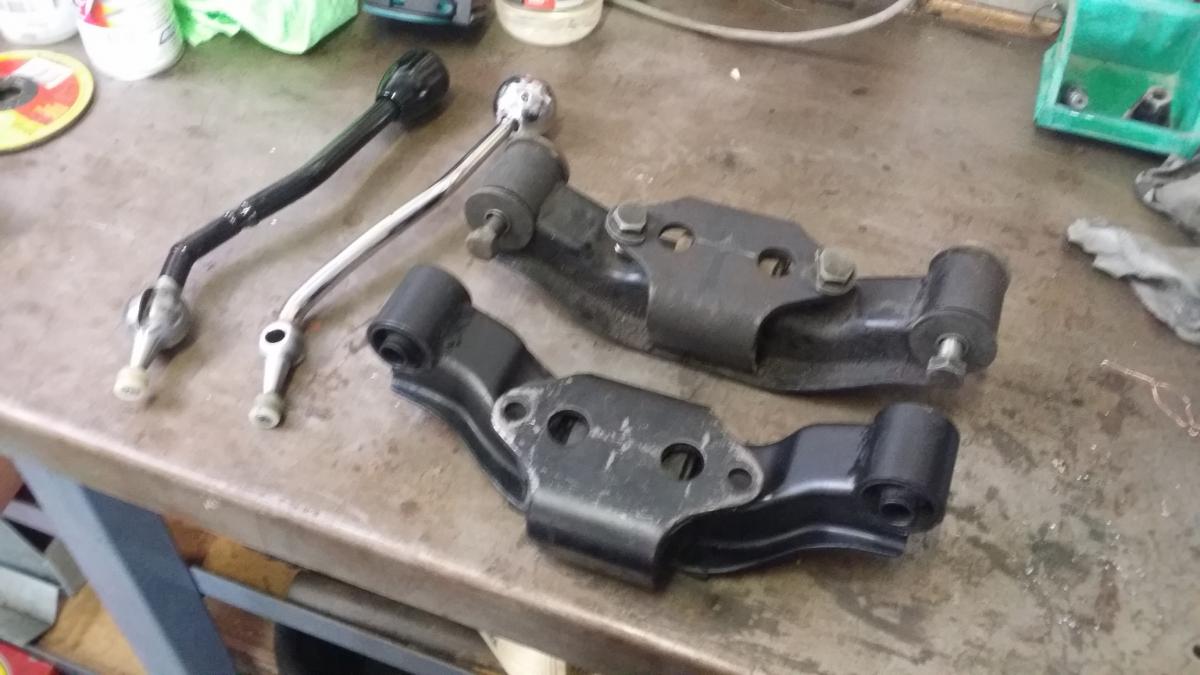

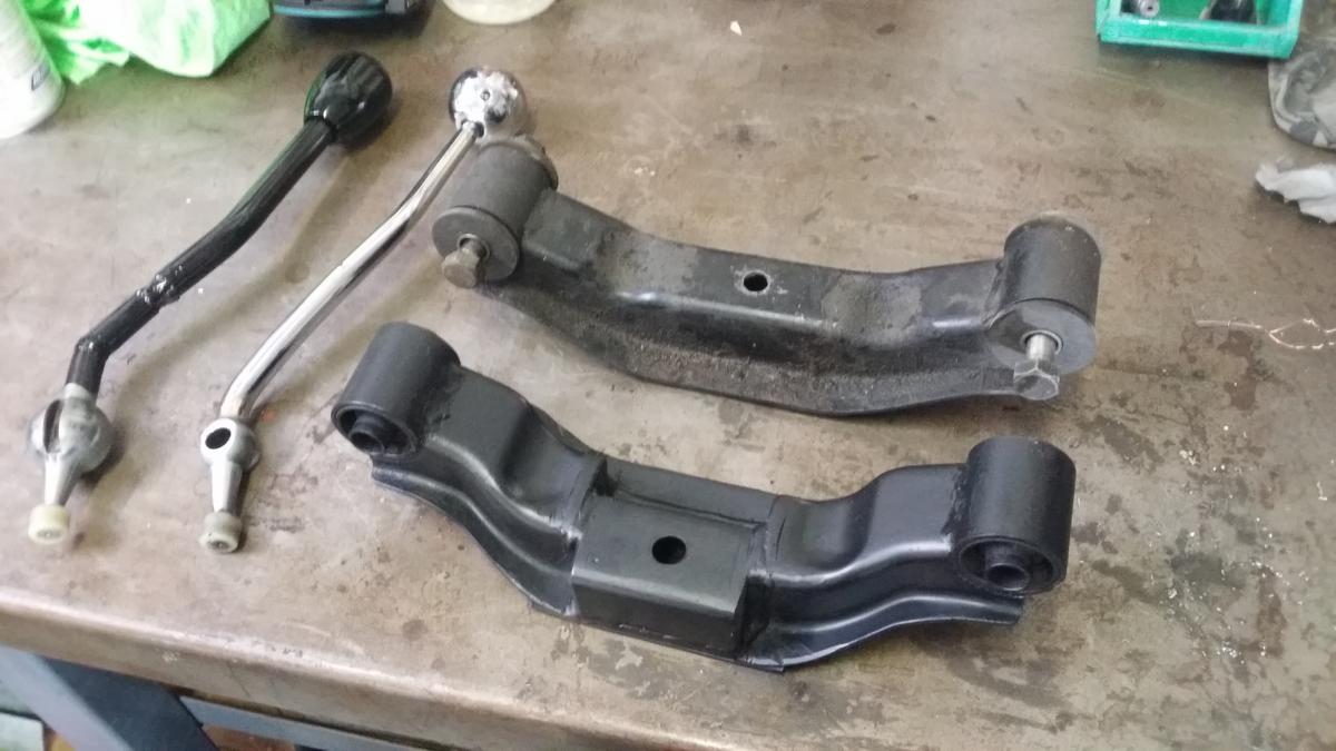

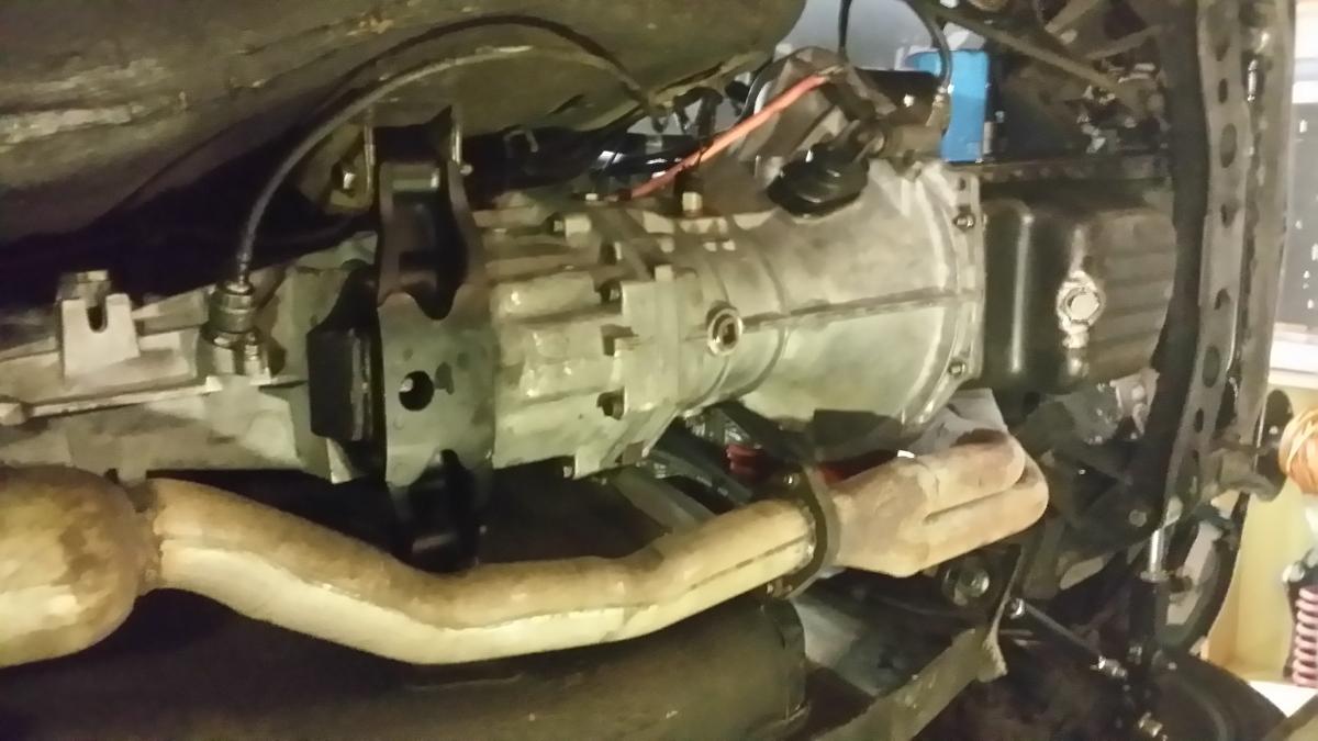

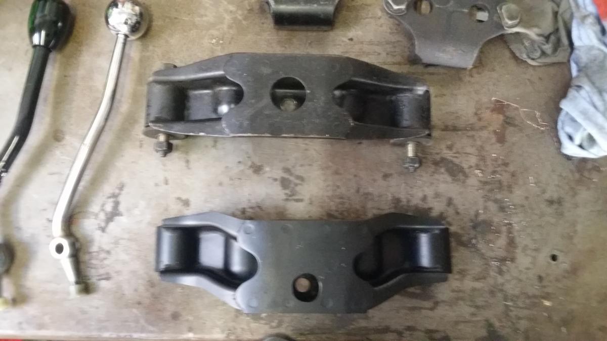

Gtv240z Posted June 4, 2016 Posted June 4, 2016 Hi , Just wondering if I can pick your brain? I had a S14 silvia gearbox fitted with an RB gearbox extension housing pieced together and mounted to my L series bell housing so that overall length of the gearbox was the same as the original and retained the original tailshaft. If i had gone with complete S14 gearbox on the L bellhousing I would need to shorten my tailshaft. My question is : I had to re do the rear gearbox mount to fit my hybrid gearbox which is approximately 35mm further back towards the diff, Would the Silvia gearbox mount to this or is the distance different again? Thanks, Craig Quote
Gtv240z Posted June 4, 2016 Posted June 4, 2016 Jason, do you have any spare shifters, shifter plate and the little clips/spacers to go with it? I've got a spare SR20 box without any of the shifter parts on the rear casing. I'm might have a shifter I want to get rid of, i'll let you know, or hassle me mid week onwards if i forget modified to suit 240Z Quote
C.A.R. Posted June 4, 2016 Posted June 4, 2016 Hi , Just wondering if I can pick your brain? I had a S14 silvia gearbox fitted with an RB gearbox extension housing pieced together and mounted to my L series bell housing so that overall length of the gearbox was the same as the original and retained the original tailshaft. If i had gone with complete S14 gearbox on the L bellhousing I would need to shorten my tailshaft. My question is : I had to re do the rear gearbox mount to fit my hybrid gearbox which is approximately 35mm further back towards the diff, Would the Silvia gearbox mount to this or is the distance different again? Thanks, Craig Same position Craig. Quote
Gtv240z Posted June 4, 2016 Posted June 4, 2016 Same position Craig. Thanks for the info! This modified mount and shifter will most likely be up for sale this week if anyone is interested. I tried my best to make it factory looking Quote
