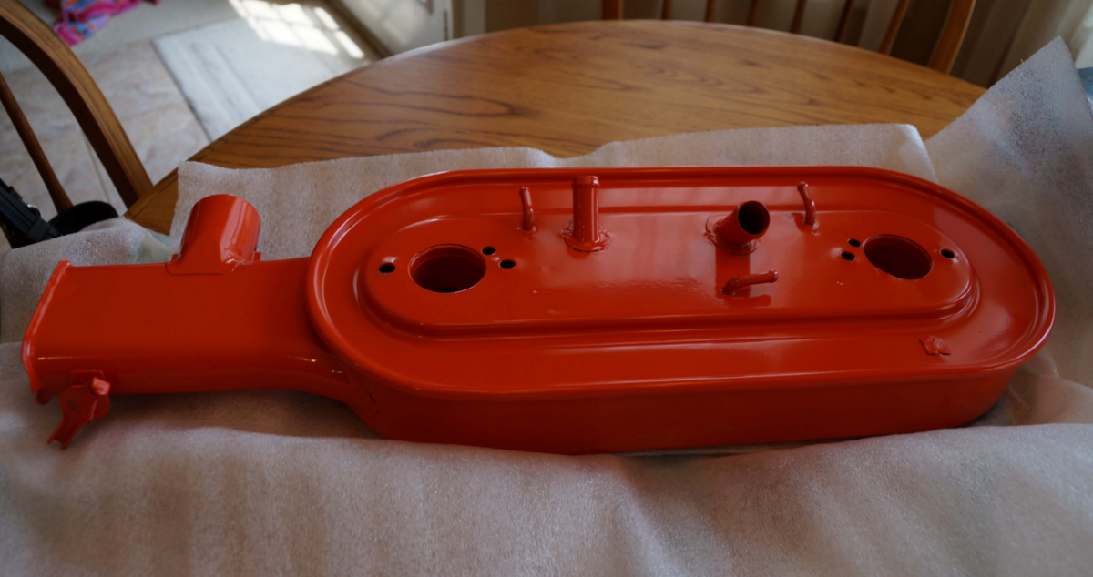

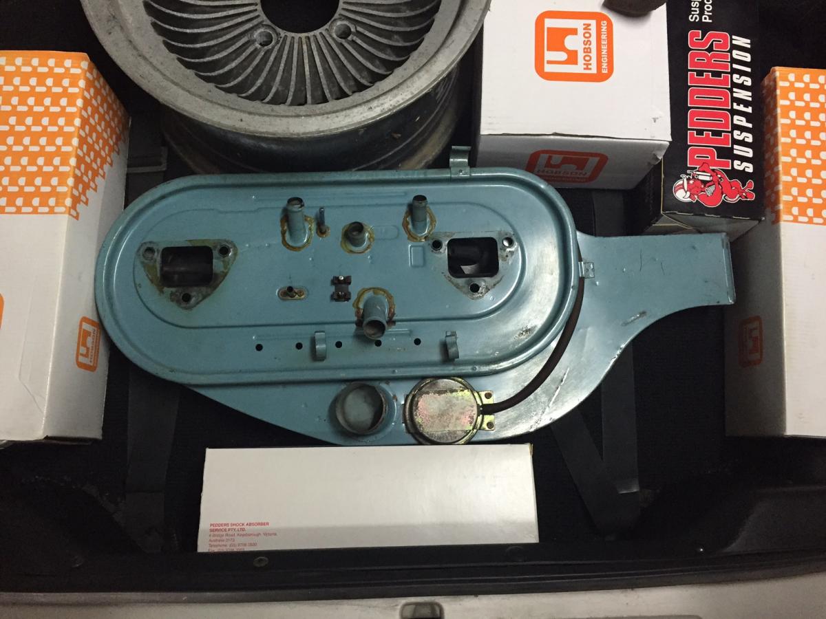

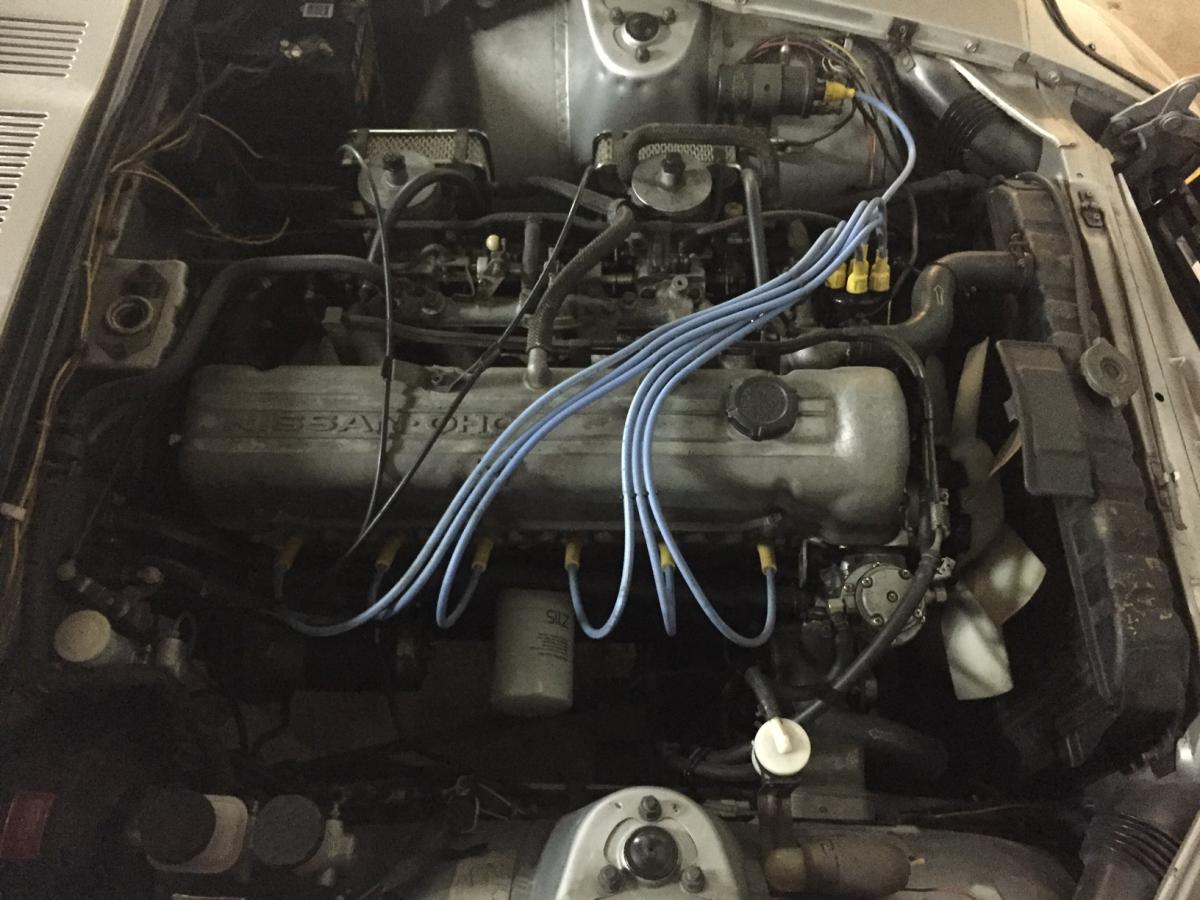

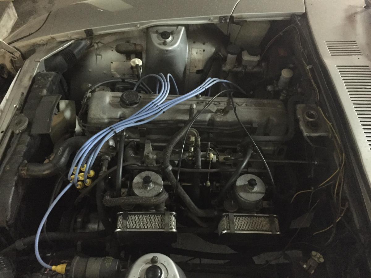

aj_ Posted April 13, 2016 Posted April 13, 2016 My recently acquired 260 (early '74) doesn't have the standard air cleaner installed. I did get one though, included with a small bunch of parts that came with the car. However, I don't believe the one I have is the perfect fit for the early '74 260 (I've seen some air cleaners with 2 x "pipe things", but mine has 3). I've attached some pictures - the aqua colour one is mine, with 3 x "pipe things" / the orange one is a comparison picture, with 2 x "pipe things" / plus, for context, 2 pictures of the engine, as it is now. Questions! Is mine missing the air pump, or was it a non-standard bit of kit at that stage? Should I put one on? Can I use the aqua one? And, if I do put one on (and can use the aqua one), are they all meant to be orange anyway (so, paint the aqua one)? Cheers, Andrew Quote
Administrators gav240z Posted April 13, 2016 Administrators Posted April 13, 2016 Questions! Is mine missing the air pump, or was it a non-standard bit of kit at that stage? Should I put one on? Can I use the aqua one? And, if I do put one on (and can use the aqua one), are they all meant to be orange anyway (so, paint the aqua one)? Cheers, Andrew 1. I believe that by 1974 our cars had air pumps fitted. North American market cars had air pumps on 240z's. Where as we didn't get emissions until 1974 (I'd have to double-check to be 100% sure on exact date we got this stuff). 2. The stock airbox generally performs better than the aftermarket ones that soak up heat from the exhaust like the ones in your picture. I personally would fit it. 3. The aqua 1 looks like the correct style of airbox for a 260z, but I'm not sure without cross checking that they work for all years 260z or if there was a difference between say North American air boxes for 260z's and our market. The orange cleaner shown is a North American delivered 240z style airbox. You can tell because it has the funnel / flapper at the front for cold air setting. Our market never got the flapper. (Ven did you get zee clapper?) 4. I believe they came in both colours, personal preference but most 260z's I've seen had the light blue / aqua colour. Personally I like the contrast of the 'orange' box though. It's sexy. aj_ 1 Quote
aj_ Posted April 13, 2016 Author Posted April 13, 2016 Brilliant, thanks Gav. Re Mr Powers, I could watch this for days - https://youtu.be/iLKR9tCiwvA?t=17s gav240z 1 Quote
gilltech Posted April 13, 2016 Posted April 13, 2016 (edited) The aqua one is correct for a 260, note it has square ports to match the square ports on your 260's flat-top carbs. On my NZ '74 260 the original airbox is orange; but I've seen both colours on 260s in NZ & here. Whether the colour signifies something in particular I don't know. And I've seen some variations in the 260 airbox 'plumbing' & cover across different cars, tweaks for different markets I guess. Anyway, you can fit the aqua one in the first picture for your flat-tops, but if you eventually run ex-240 round-tops you will need the orange style one with the round ports as in your second picture. The upper 'pipes' connect to the carbs, the lower pipe to the rocker cover vent IIRC? (Mine's packed away, haven't seen it in a while). The backing plate bolts to the carb flanges with 6 bolts, the lower 2 being a special type with a threaded female head to receive the wing nut bolts that hold the cover on, if that makes sense. Hopefully you have all those. FWIW, I have ex-240 round-tops & airbox on my 260, & the airbox has the same manual flapper, so must have been a colder-climate spec fitment. Edited April 13, 2016 by gilltech Quote

richard260 Posted December 18, 2016 Posted December 18, 2016 Yes you got run the aqua one as it has squre ports for those flat tops su,s aj_ 1 Quote

Mike260LW Posted December 20, 2016 Posted December 20, 2016 All three '74 260Z I have had run an orange air box with square port ram tubes. I have one which is surplus to needs if you are interested. Quote
aj_ Posted December 21, 2016 Author Posted December 21, 2016 All three '74 260Z I have had run an orange air box with square port ram tubes. I have one which is surplus to needs if you are interested. All good, thanks Mike. I have an aqua one that came with the car - still pondering if I should install or not. Quote
