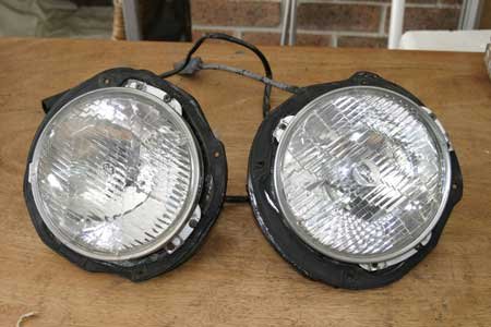

VintageNissanEnthusiast Posted April 3, 2016 Author Posted April 3, 2016 (edited) Alright. So ended up purchasing new aftermarket H4 globes and headlamps today. Was tricky doing it with the wheel on (like 3 hours tricky) and needed to go somewhere in it so put it back together without 2 screws (the left inside top and bottom) as I just couldn't get them to line up! I will give it another crack tomorrow, taking the driver side out again and hopefully putting it back together then doing the left (hopefully in less than 6 hours ahaha) I had a bloody hard time trying to put the metal plate around the light back into the unit itself. I imagine the whole job would be so much easier with the wheel off!Here are some pics. On the job/ the new and one and the light difference at night. Edited April 3, 2016 by VintageNissanEnthusiast Quote

VintageNissanEnthusiast Posted April 4, 2016 Author Posted April 4, 2016 So I managed to do both today. Ended up just taking the wheels off as it was considerably easier just to spend a 5 more minutes on it. Now I have put on the new lights but there is a bit of an issue. The lamps I purchased were universal ones (178mm) and they did not totally fill the metal bracket that surrounds them (seemed a couple of mm off) so I put in some slight bits to help fill it out so it doesn't move, now only problem is I think they look a little...off. Not sitting quite right in the terms of the style of light is a bit...shit. There seems to be a white line around the lamp that is visible (probably due to its size) I was told that they were generic and they would suit great but...they do not at all. The are some brand called autopal. Does anyone know the actually measurement of the original lamps? Have attached some images of lamps that are now in. Any recommendations for better lamps that can incorporate the semi sealed beam design with the globes? Quote
GongZ Posted April 4, 2016 Posted April 4, 2016 (edited) I can't quite see well enough in your photos - but do you have the headlight rings in front of the headlight 'glass' or behind? The rings should be in front, holding the headlight unit in place. You can see this reasonably well in the photo below ('borrowed' from Matt Drago's website (http://240z.drago.com.au/?attachment_id=139). As far as I know all conventional round headlights are usually 5 and three-quarter inches (146mm) or 7 inches (178mm) diameter, so your 'Autopals' should be the correct size. Edited April 4, 2016 by GongZ VintageNissanEnthusiast 1 Quote
VintageNissanEnthusiast Posted April 4, 2016 Author Posted April 4, 2016 (edited) Yeah the metal rings are indeed in front. It must either be the rings them selves or the style of these top of the range "Autopals" that make them look off, and not fit perfectly. Note* apologies for the pictures, seem to change angle on upload. Edited April 4, 2016 by VintageNissanEnthusiast Quote
GongZ Posted April 4, 2016 Posted April 4, 2016 OK - I can see that it all looks correct now, and they look fine to me. I am not sure what you meant when you said "I put in some slight bits to help fill it out so it doesn't move". As previously mentioned - did you find that you had 'Koito' sealed beams? Are you thinking of doing the relay upgrade to further enhance your headlights and save your precious switches and wiring? Quote
VintageNissanEnthusiast Posted April 4, 2016 Author Posted April 4, 2016 Slight bits were just some double sided foam tape cut slightly between the outside of the lamp and the metal, as when I put it back together it was a bit loose on both sides. Originally it had sealed beams either side, one IKI and one Lucas (no idea why they were different). Didn't know I needed too! I was told when I purchased the globes and the headlamps that I wouldn't need to upgrade any of the relays etc, just swap the lamp over for a semi sealed and get a globe.... Quote
GongZ Posted April 4, 2016 Posted April 4, 2016 ...Didn't know I needed too! I was told when I purchased the globes and the headlamps that I wouldn't need to upgrade any of the relays etc, just swap the lamp over for a semi sealed and get a globe.... It is not compulsory - but if you have time - look at what Peter (PB260Z) and I said in replies #2 and #3 and the pages linked to in those responses. VintageNissanEnthusiast 1 Quote
