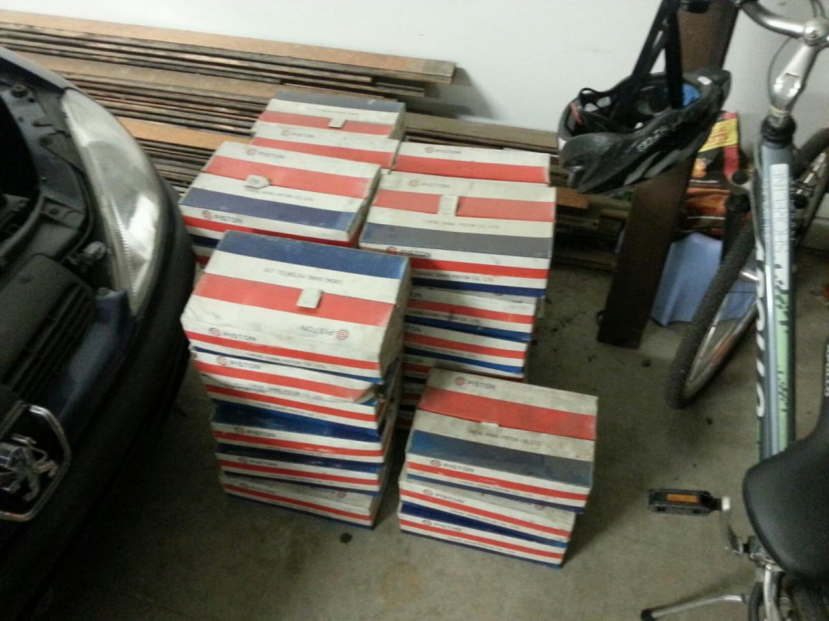

dattocam Posted April 1, 2016 Posted April 1, 2016 (edited) Hey, I've got 30 sets of replacement pistons that I have been meaning to sell. They are old stock from my father business that has been sitting around. They are +20" and +30" L24 and L26 flat top pistons with valve relief’s cut in. Rings and pins supplied. Without knowing your cylinder chamber cc’s it’s a bit hard to tell you exactly what comp you will achieve. They are the same comp height as standard without the dish in the top of the piston so the comp with rise closer to your desired target. These are an option if your are interested $75 Edited April 1, 2016 by dattocam Quote
Cozza Posted April 1, 2016 Posted April 1, 2016 Hry, I've got 30 sets of replacement pistons that I have been meaning to sell. I expected that to be a typo until I saw your pic. Gotta love hoarding Datto parts. We are all guilty of it. dattocam 1 Quote
