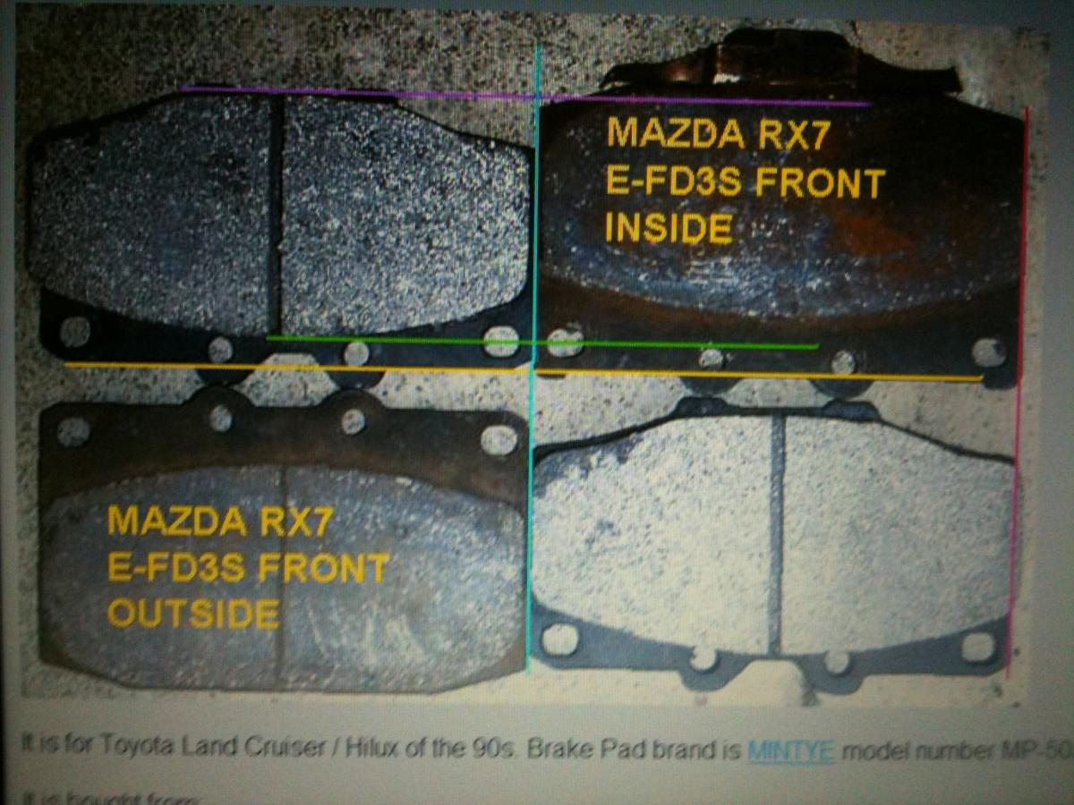

Riceburner Posted March 15, 2016 Posted March 15, 2016 I run Project Mu club spec pads from a Mazda E-FD3S in my hilux calipers with cross drilled and slotted vented rotors. No issues at all, the pads aren't cheap but they're bullet proof and have lasted me ages. I have attached a pic of them compared to a hilux pad, if you want to use them you need to weld the holes and re drill them in a slightly different position to set the pads in exactly the same position as stock hilux ones. I tried EBC (with solid rotors) green as well as yellow and both sets cooked at the track so much that huge chunks of material were cracking off. Do you have anymore info on the brembo pad? Quote
