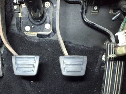

Andrew_L26 Posted February 12, 2016 Author Posted February 12, 2016 Yes it would, dont take the chance. As Jason said of something goes wrong you could be liable. And as Gav said said, just grab an S30 one. Do you need a new pedal box ? my late model 2+2 auto didn't need a new pedal box, just the 260Z clutch pedal and pivot pin. Cheers PB Thats what I just became aware of! I'm now on the hunt for a clutch/brake pedal (I believe they are the same?) Quote
C.A.R. Posted February 12, 2016 Posted February 12, 2016 Thats what I just became aware of! I'm now on the hunt for a clutch/brake pedal (I believe they are the same?) No the angles & pedal pad orientation are different between the two. Just do as I advised in my PM! Andrew_L26 1 Quote
Moderators PB260Z Posted February 12, 2016 Moderators Posted February 12, 2016 (edited) Thats what I just became aware of! I'm now on the hunt for a clutch/brake pedal (I believe they are the same?) Hi No unfortunately not the same. Edited February 12, 2016 by PB260Z Quote
