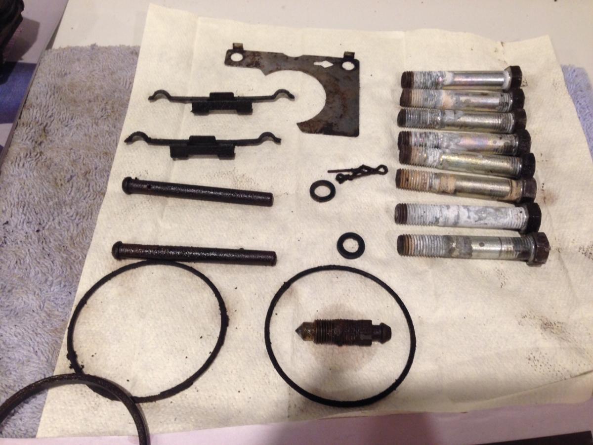

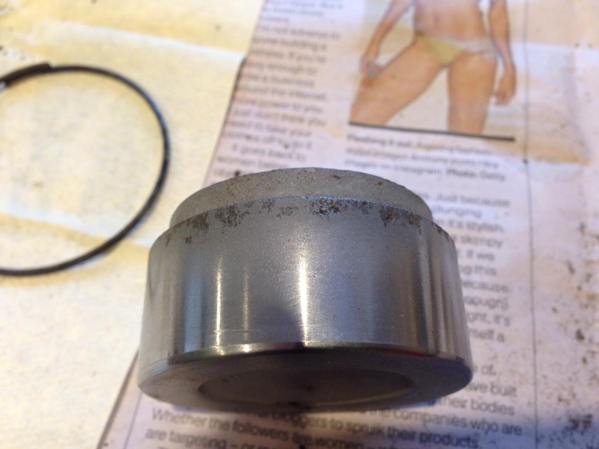

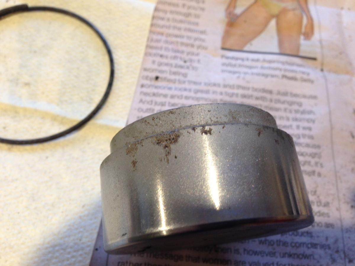

George Posted August 24, 2015 Posted August 24, 2015 (edited) Stripped the front right claiper over the weekend and all looks servicable but I just wanted to check the piston with you guys. There is some pitting on one of them and I was wondering if I should reuse or replace. The pitting is on the outer edge which looks to be past the rubber seal within the caliper so I suspect it will create a sufficient seal. Thoughts? Also, does anyone have spare shims laying around? I think I need the right shim but haven't looked too closely. Most rebuild kits I've seen do not include them. The other caliper looks to have both shims. Bikini girl was a happy coincidence. Edited August 25, 2015 by George Quote
Administrators gav240z Posted August 25, 2015 Administrators Posted August 25, 2015 From what I understand any damage/pitting to the piston surface means you should replace it. But happy to be corrected on this. Quote
KatoKid Posted August 25, 2015 Posted August 25, 2015 Hi George. The piston may be useable if the pitted area is outside of where the seal works. Measure where the groove for the seal is in the cylinder bore and then push the piston all the way in and confirm that the pitting doesn't go past the seal location when fully depressed. George 1 Quote
George Posted August 25, 2015 Author Posted August 25, 2015 Dave, I measured as suggested and I'm not confident it will create an ideal seal. It overlaps ever so slightly but enough to potentially leak so new piston it is! The pitting really isn't all that bad but not it's not worth the risk imo. Still looking for shims if anyone has any spare ones. Alternately, if you know where I can purchase them that'll do as well. Cheers. Quote

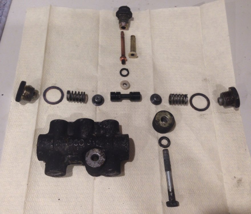

George Posted August 26, 2015 Author Posted August 26, 2015 Stripped the other side and the pistons are shot. I can only save 1 which means they're all getting replaced. Also stripped the proportioning valve and despite it looking rough with fungus-like silver deposits it looks serviceable. Quote
