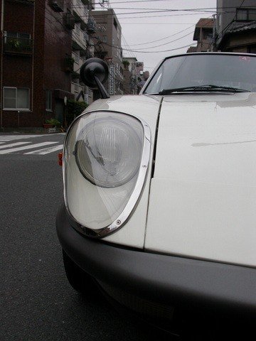

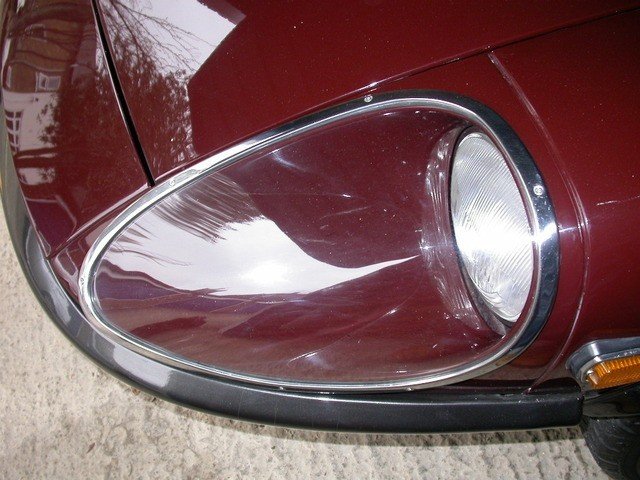

d3c0y Posted July 28, 2015 Posted July 28, 2015 As i'm building a Z-G replica I have some Z-G specific questions. I would like to know what specific differences the Z-G came with, compared to Aus market 240Zs. Did they come with the speedo that had the yellow and red lines on it? (I know the emblems say Fairlady 240Z) Did they all come with the rear spoiler and was it the one with the two ribs in it? Is the JDM AM radio different to the AUDM one? When you fit the nose with flared guards, obviously the lower half of the nose sticks out under the flare. Do people trim this back corner off and did you reinforce it, since the is an angle at the back there that makes it stiffer. Does any one have a pic of a genuine Z-G headlight cover mounted from the side and top. A close up would be good as there isn't a lot of room there. Quote

d3c0y Posted July 28, 2015 Author Posted July 28, 2015 Thanks Gav & Alan. Alan you have answered all my questions with the intentions with which they were asked. I'm running 9.5J Watanabes on the front so I think i will have to trim it and yes it looked structurally important to me too haha. The headlight cover images are exactly what I wanted. I just like having good references after miss-reading your fender mirror diagram. I have the reproduction covers I got from Yahoo Auctions jp and when you don't have any marks to go off there is definitely a bit of room to move it. I've found i need to exert sideward pressure on the cover for the seal on the bottom of the perspex to sit flush on the body. Out of interest these are the main visual differences i have seen on JDM cars: Hazard switch Side markers (no rear ones on PS30 models) KPH speedo Datsun emblems replaced with Fairlady Z or just Z Kick plate covers Stereo as mentioned above 3 piece seatbelt (maybe only on the early cars) Fender mirrors S30 bumpers, rubbers strips were an option No over-riders on the bumpers Amber indicators on the lower valance Sidemarker switches in the centre console A lot of them don't seem to have a choke light? Roadside flare mounted in the interior Willingness to be possessed by evil spirit/devil for highway racing purposes. Quote

HS30-H Posted July 29, 2015 Posted July 29, 2015 I've found i need to exert sideward pressure on the cover for the seal on the bottom of the perspex to sit flush on the body. That's OK, that's normal. Don't worry about it. You might have to give them a bit of a push to get them to sit right and get the holes for the mounts in the right place, but they do - in my experience - kind of find their own way to being right with a little gentle persuasion. Out of interest these are the main visual differences i have seen on JDM cars: Hazard switch Quite a few other differences in switchgear too, depending on model and month/year. Side markers (no rear ones on PS30 models) No rear markers on any Japanese market models. KPH speedo. Yes, and differences in month/year versions. Datsun emblems replaced with Fairlady Z or just Z. Remember that L24-engined models (like the 240ZG) had two piece 'Fairlady 240Z' emblems. Kick plate covers Yes, the stainless sill plate trims were plain - non-branded - on Japanese market models. Stereo as mentioned above Several different Japanese market radio/tape units, depending on model/month/year. 3 piece seatbelt (maybe only on the early cars). Both my 240ZGs have the 3-piece seatbelts with letter 'Z' on the buckles. Earlier cars (like my 1970 Fairlady Z-L) had the plain black buckles, but the belts were still 3-piece. Fender mirrors. With different design and positioning on late model cars. Complicated subject! S30 bumpers, rubbers strips were an option Yes, all 'Standard' (no frills) models from 69 to 73 had plain chrome bumpers (ie S30-S, HS30-S & PS30-SB) but rubber trims present on all other 'Deluxe' models. Fairlady 240ZG had painted rear bumper with extra 'filler' rubber strip in the middle. No over-riders on the bumpers Although available as an extra-cost showroom option at time of purchase. Amber indicators on the lower valance Yes, but two colour (amber & clear) division on later models. Sidemarker switches in the centre console. Yes, the double rocker 'Parking Light' switch. A lot of them don't seem to have a choke light? No choke light on early cars. Roadside flare mounted in the interior Originally it was a double-ended signal torch with a red lense on one end. Flares came later, with a double (torch and flare) mounting bracket arrangement. Willingness to be possessed by evil spirit/devil for highway racing purposes. Only the blue ones, apparently... ^My comments above in red, which hopefully won't look too rude. Best points of reference are the Japanese market factory parts lists. They help you to differentiate between the parts fitted to different spec cars. You can spot a lot in there by comparing with the Export parts lists too. There are lots of extra little differences on the 240ZG that people don't generally notice. Stuff like the different bonnet prop rod, the different front tow hook, the front number plate holder, etc etc. Quote

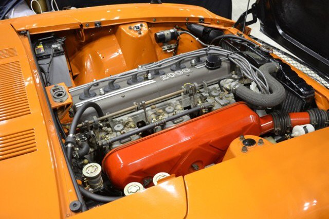

locklock Posted July 31, 2015 Posted July 31, 2015 thats very deep. 400 but left 1298???..... :o Someone replica it?? D3coy are you putting mikunis carb? Is it possible to fit the original SU air filter box into the triple carb like in the picture? Quote
d3c0y Posted August 8, 2015 Author Posted August 8, 2015 I have triple 50mm webers. Originally 240ZGs had L24 engines with twin SUs not the S20 pictured. Also that isn't an SU airbox it is a special 432 airbox for triple 40mm solexs. Quote
