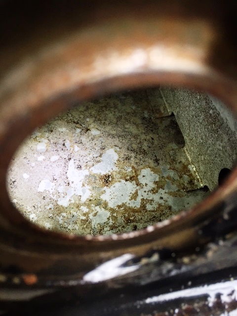

Once tank is empty and the fuel sender is out, wash the tank well with the pressure gun, you should be able to stick the nozzle inside the tank and try to get all angles, when you think you have washed the fuel tank well then wash it for another 5 minutes. Try to get all angles and rotate it.
See Photo #2 – Much better already.

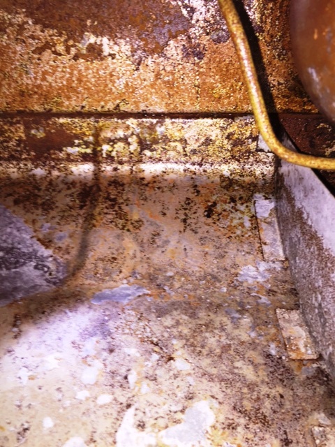

Step 3 Loosen the left over rust (repeat this step any time the tank is properly dry )
Once tank is dry, really dry!  Bang it around gently and you will notice more rust flakes, I vacuumed this out.
You can also use a handful of washer inside the tank and then rolling the tank.
See Photo # 3 Looks even better.

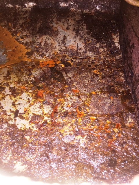

 My fuel tank had probably had 5mm of rusty slag and scale in the bottom and after this process alone the rust was almost totally gone on all the flat surfaces. In total the fuel tank spent about 3 hours rotating and I did flip the tank over to make sure the top and bottom both got equal treatment, as the stones tend to slide against the side facing the cement mixer drum.
Getting the stones out wasn’t as bad as thought it was going to be but you have to patient it takes time and some stones got wedged under divider wall between the low part and deep part of the tank which I has to poke out with a stick, note you have to get the pebbles out the fuel sensor hole as there is a lip on the inside of the filler pipe that prevents stones coming out easily.
After about 1.5 hours turning like a propeller on each side it was time to empty it out so I stopped the mixer filled the tank with water until it was spilling out than put the mixer on high rotation this spilled out the stones and water so it was 80% empty when I turned it off for the last time.
The worst part of doing all this is the mounting of the fuel tank to the cement mixer drum this was a cumbersome time consuming and difficult task apart for that it was all pretty good.
After this process stone washing/sanding process  I flushed the fuel tank clean with water, it pretty close to 90% perfect but some rust in the centre clamshell seam grove
Photos after pebble mix process - see pic 3 & 4
