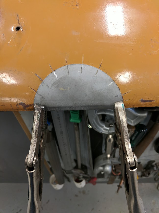

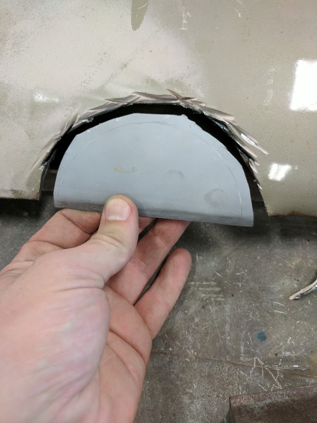

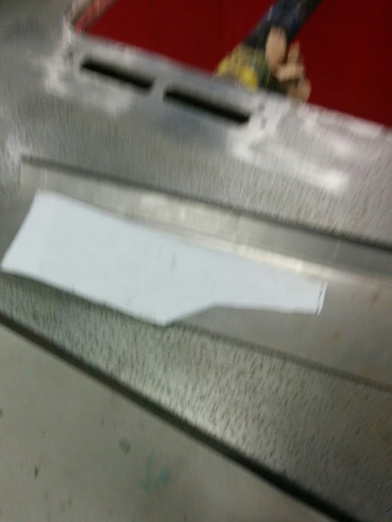

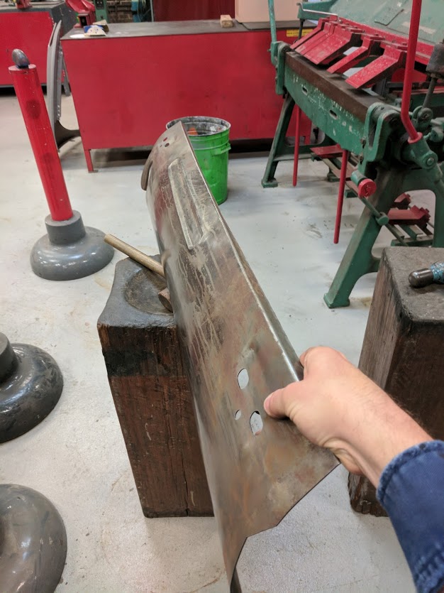

So fabricating the rear slam panel upper area (under the spot welded panel) is a bit hard without the right tools. Using a folder here and preferably a guillotine to cut to the right size is very helpful.

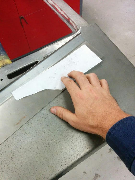

I had tried to use a paper template of the whole thing but it came out badly due to all the obstacles in the way and the paper I was using was very thin and would rip on the sharp edges of the metal.

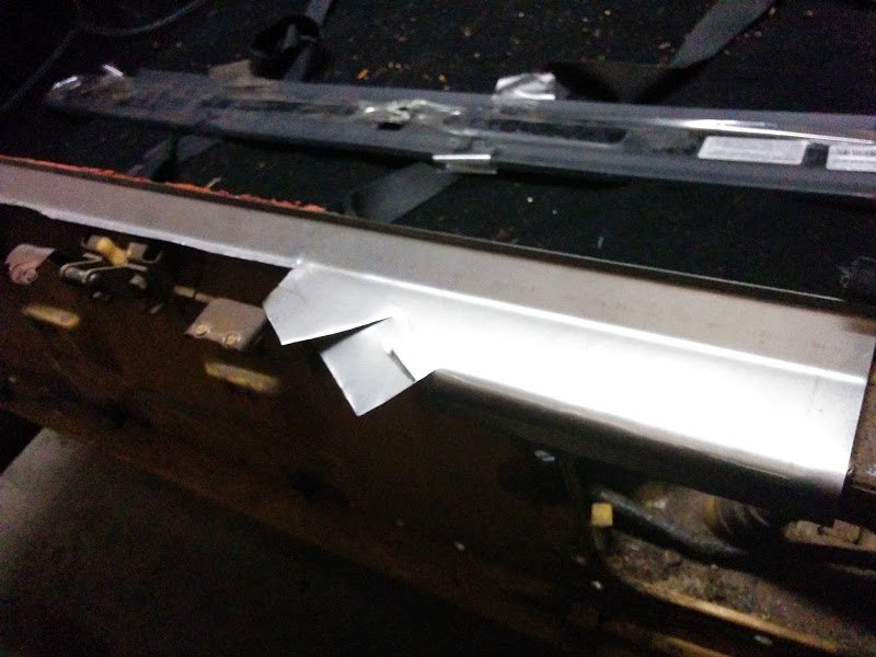

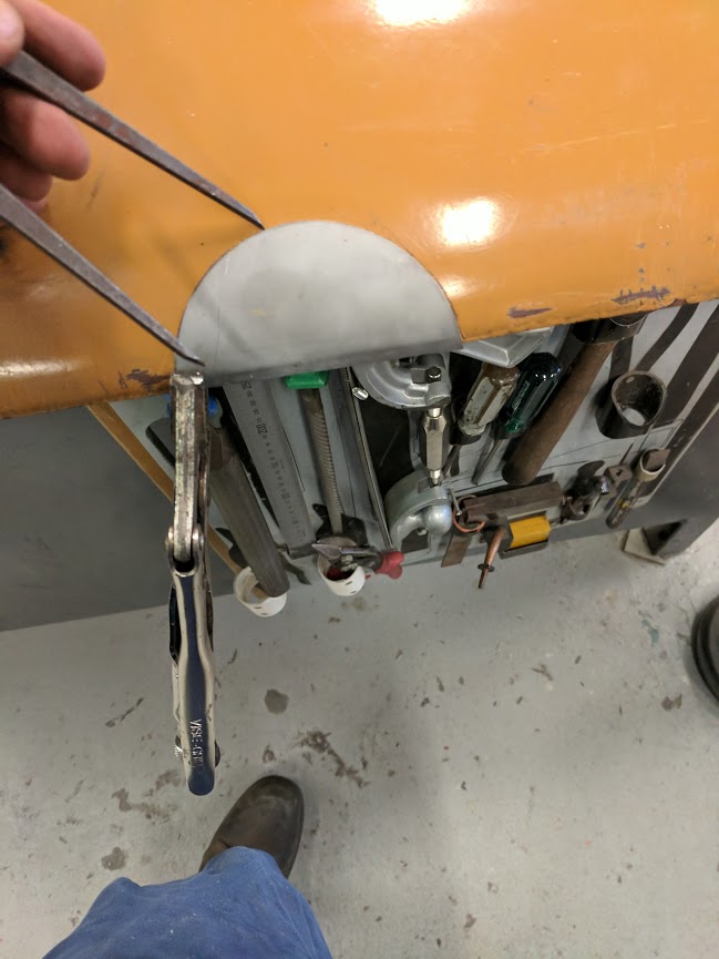

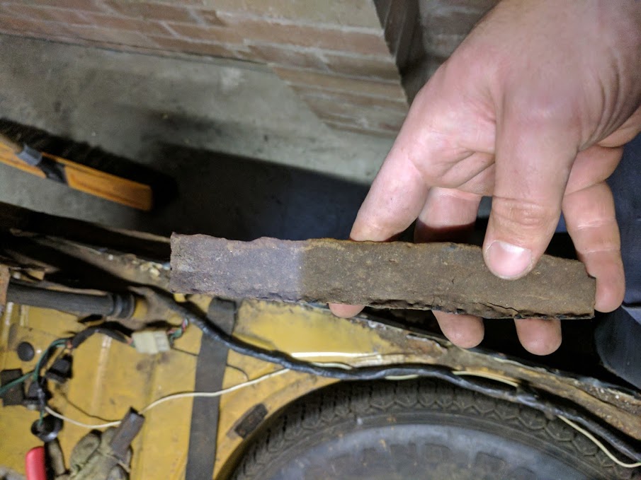

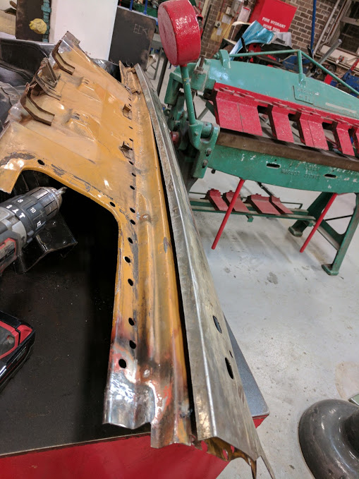

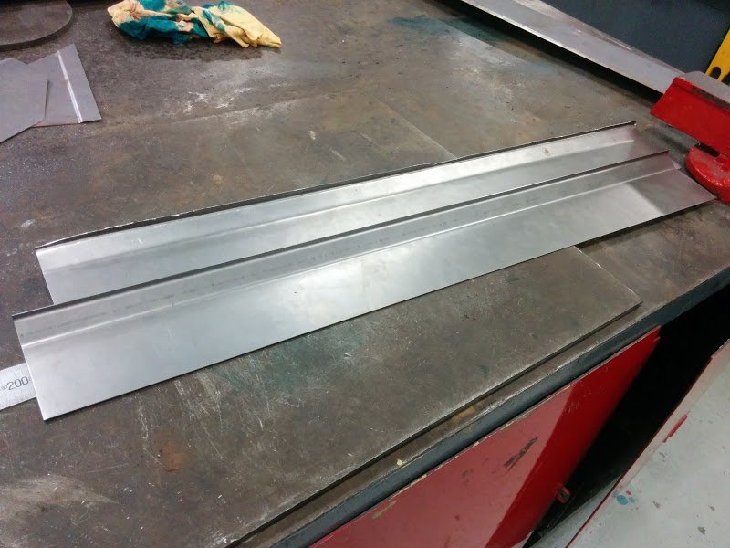

So instead I measured with a rule to get dimensions of certain sections. Here you can see 2 sections I made, the first was a mess as I tried to trim the lip for the rubber seal with tin snips and on such a long piece it's very hard to cut with tin snips close to a fold.

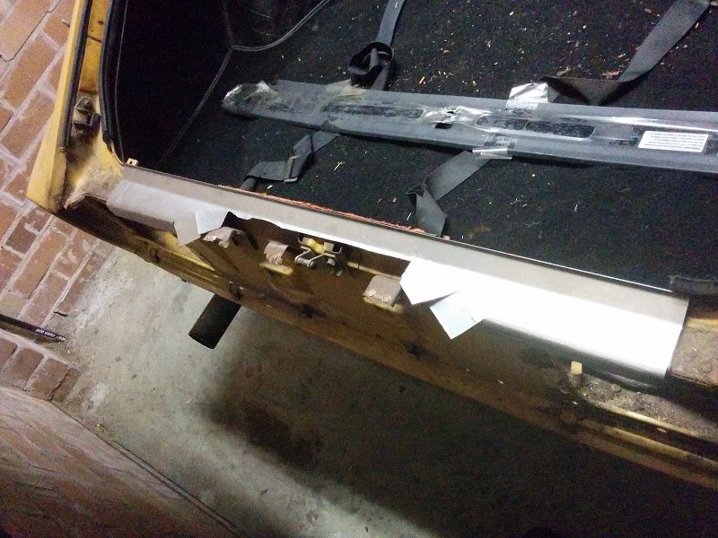

So on the right side you see the second attempt using a folder to get the nice lip and then folding again for the 30 degree bend upward.
Since the car was not at Tafe as a reference a lot of this was guess work or best guess based on my measurements and observations etc..
I used paper templates from the car the night before but focused on the missing sections on each side, then measured the different between those sections with a ruler to scribe them onto the panel. Since I made this piece a little longer to give me some room for error.

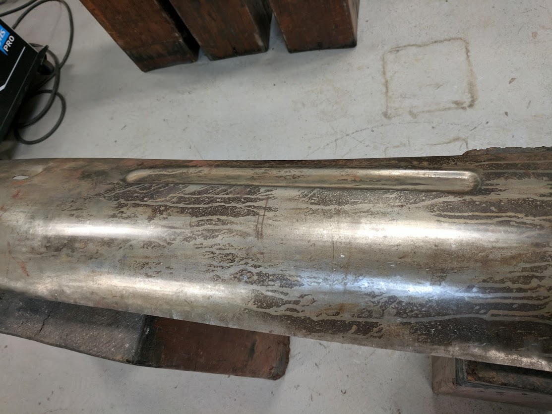

The original upper edge of the beaver section has a beveled edge as opposed to completely square so I tried to replicate that as much as possible.
I've left some excess metal to allow adjustments as I go. I also need to cut out the center section of the original piece as it's pretty knackered before I can put it in place completely.
Shows bevel area better.

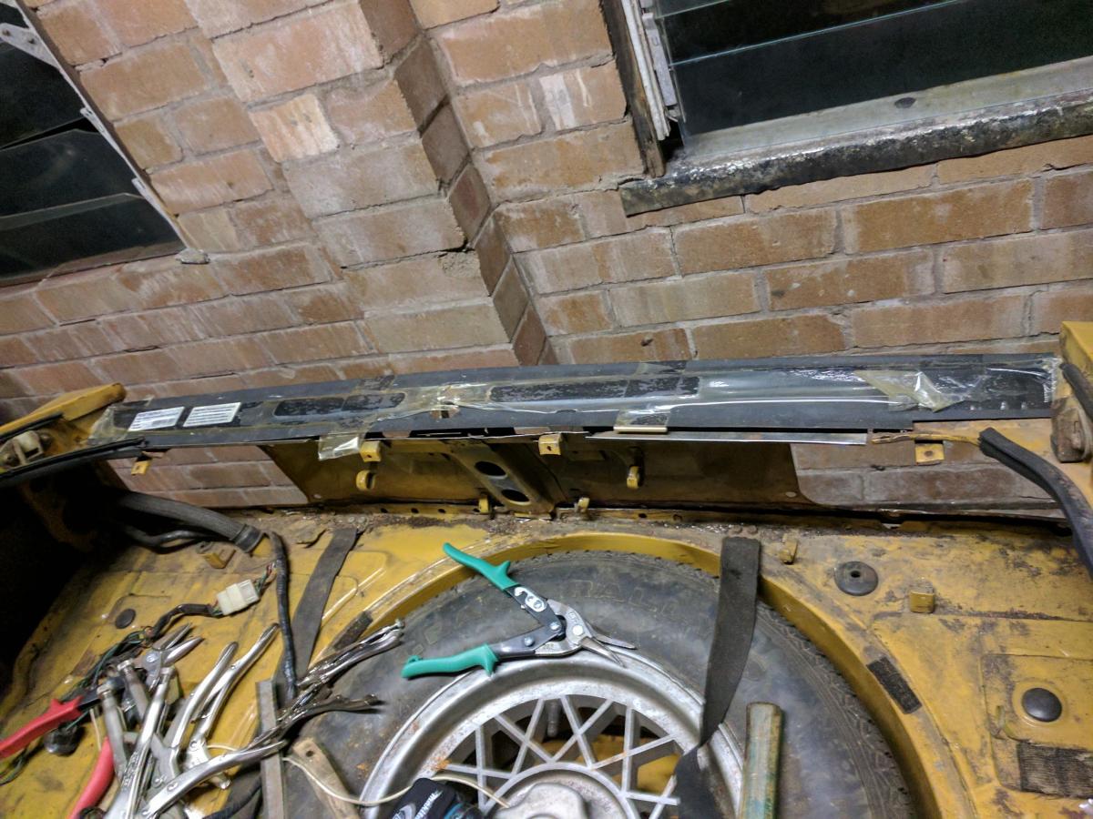

How it looks so far.

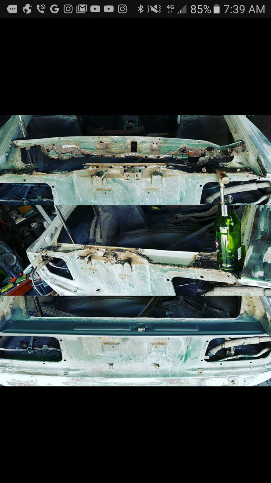

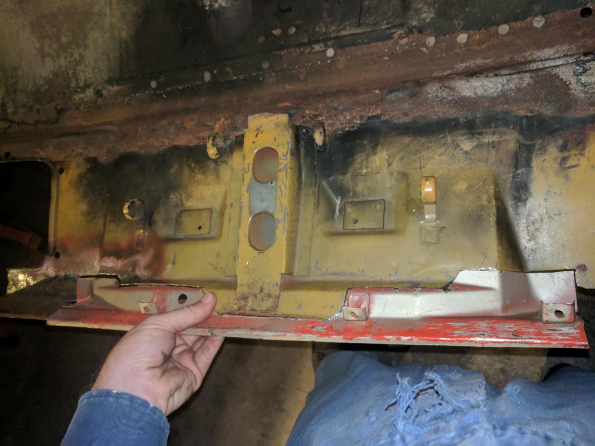

Reminder of how it looks underneath it all.
and attached is a photo of how it's supposed to look...(another photo borrowed from the Lithuania car)
This is still an experiment for me, but so far it's looking good. There is a few more fiddly bits though below this area that need to be fixed also. But I want to get this section correct before picking the whole rear panel and replacing the bottom half of the beaver panel.

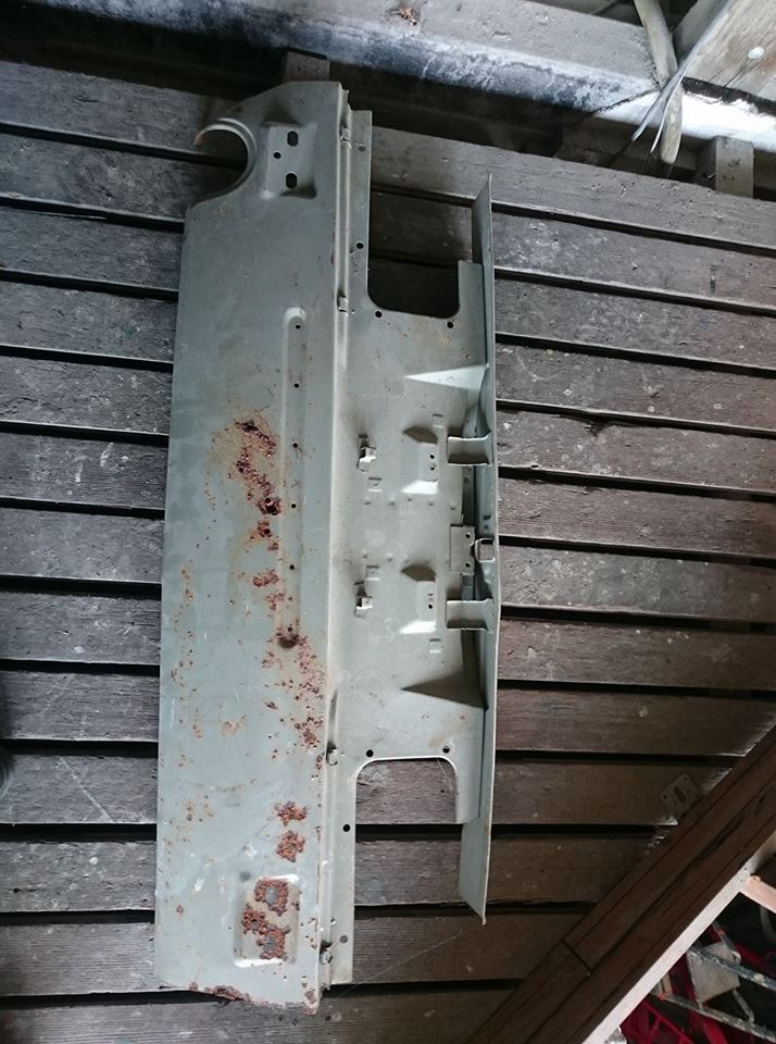

After buying a slam panel for a 260Z I've found out that it doesn't fit my 260Z 2+2.
The slam panel on the 2+2 bus is wider and has extended corners on the end.
It could be modified with alterations to the width and ends,but you may as well fix the one you take off as modify a rust repair panel.

So it's been a while between posts, but whilst I am working on the bonnet I've got to a stage where I really need guidance on the finishing bits and whilst the teacher is busy with other students I don't have much to do.
I decided I should probably tackle the rear slam panel while the teacher is busy and start making progress on that. Since I don't think it's going to be too difficult (famous last words of course).

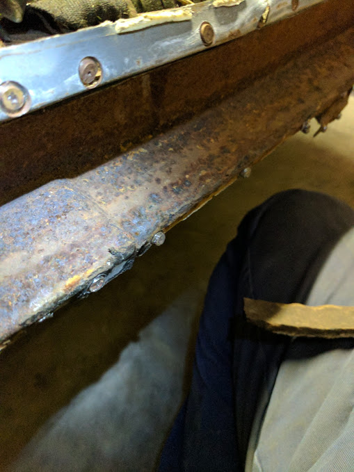

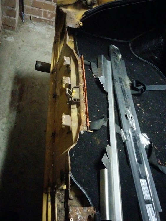

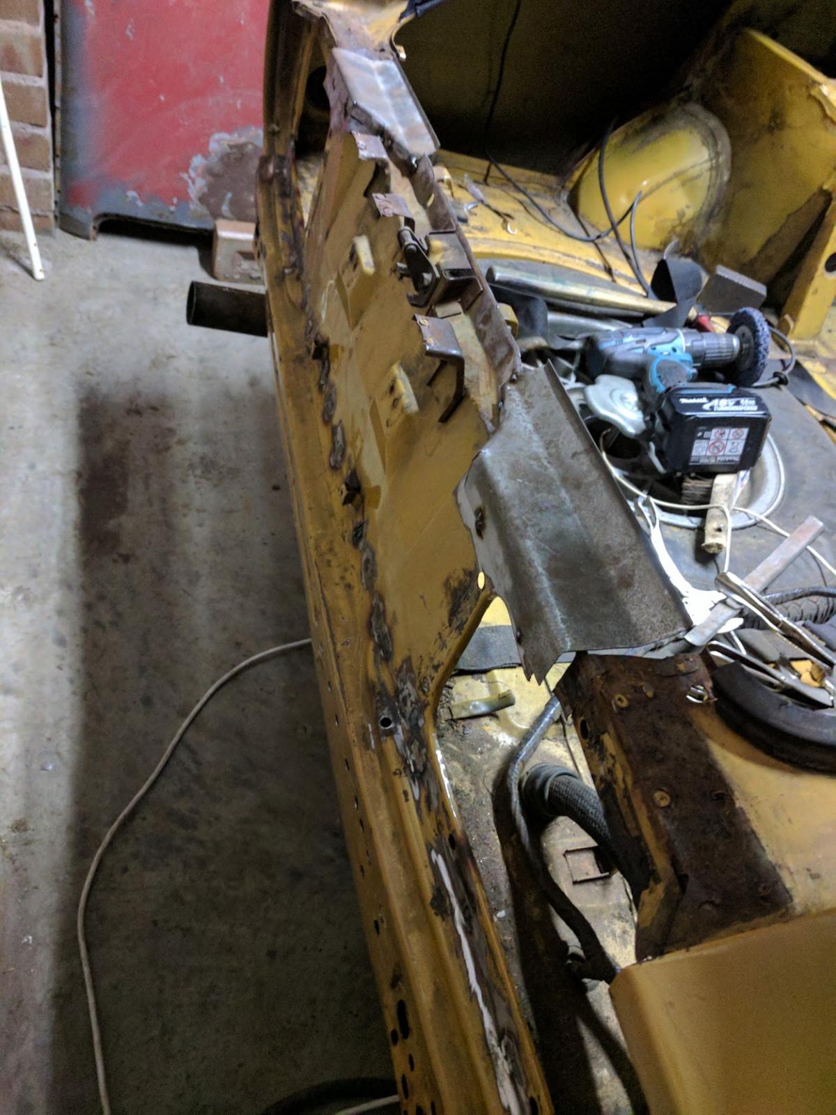

Removing it was an utter paint in the arse, but given the rust damage and the fact the car had a light nudge in the rear many years ago it really was the only way to do it.
What I found odd was the factory sealant behind the panel in the box section.
It sort of just sat here. I'm guessing a light impact in the rear disturbs the sealant around the panel, water ingress comes in and then she rusts out from the inside.

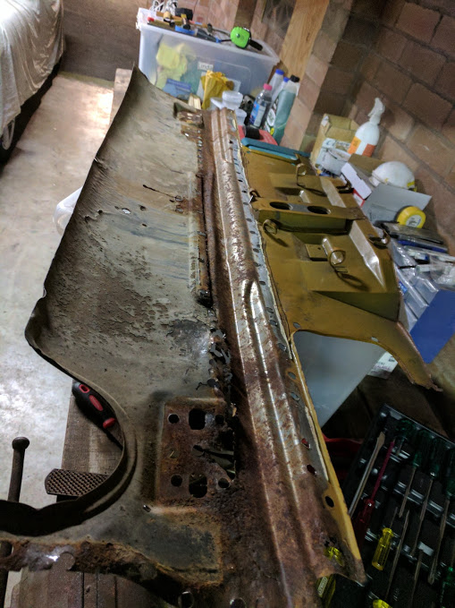

Rear valance / beaver removed.
The panel itself isn't actually too bad considering, but it is quite dented and the rusted areas would have been a pain in the butt to repair using mig.
For those playing at home, here are most of the spot welds. I certainly found a few hidden ones which made the whole process very frustrating I must say..

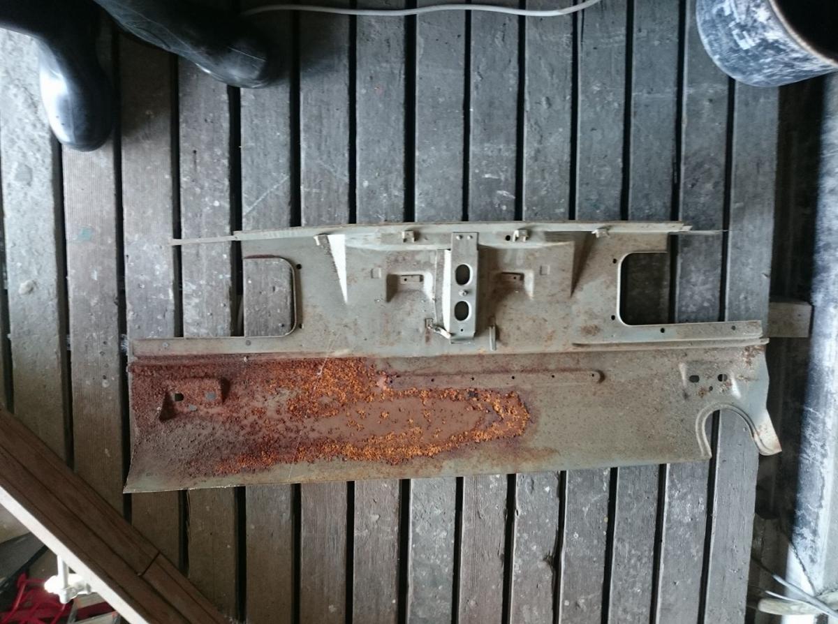

Now compare the profile with the replacement spare I got from Canada.

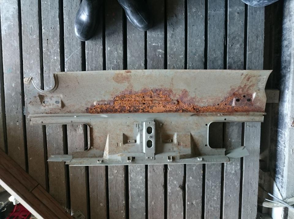

So I think the bonnet on this car was in pretty average shape, but actually the worst part of the car would have to be this rear beaver/valance panel and slam panel section.
As you know a while ago I imported the lower half section from a Z supplier in Canada, this piece however was made of really thick gauge steel and with the help of my tafe teacher we tried to re-shape it.
Part of the problem was the stamping in the middle, it's quite deep and this means that when we try and curve the piece it's actually being held in place by this stamping. I think the photos will best illustrate the problem.
We tried to beat it into shape and then used an English wheel to smooth it out, but we can't get the English wheel into the top section.
Notice the bow?

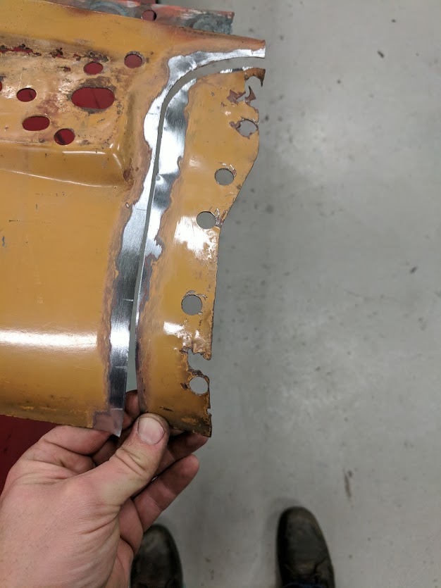

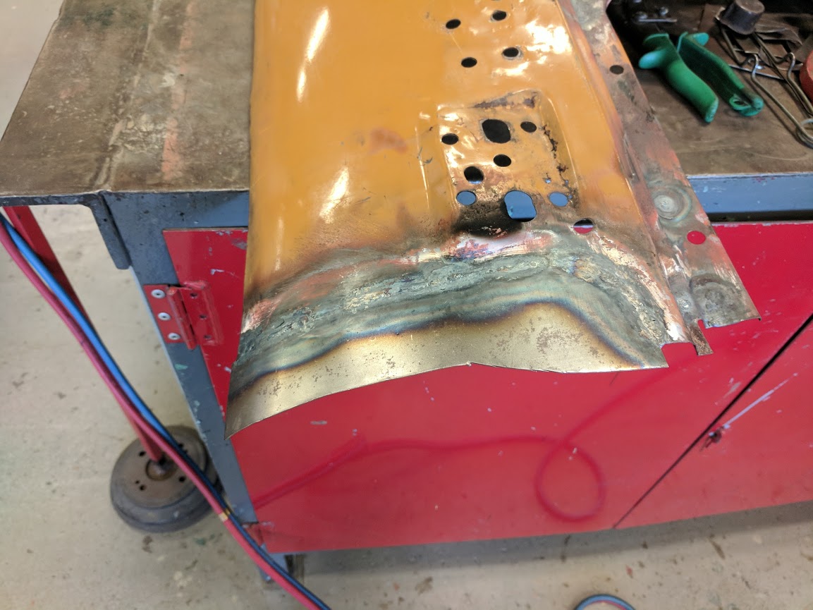

So after all that messing about, I said, do you think we could just repair the existing piece? It's going to be a bit of a patch work quilt, but the advantage is that it'a a thinner gauge of steel and more flexible. I've already panel beaten it into shape again (will need more work here) but we know importantly this piece fits perfectly.

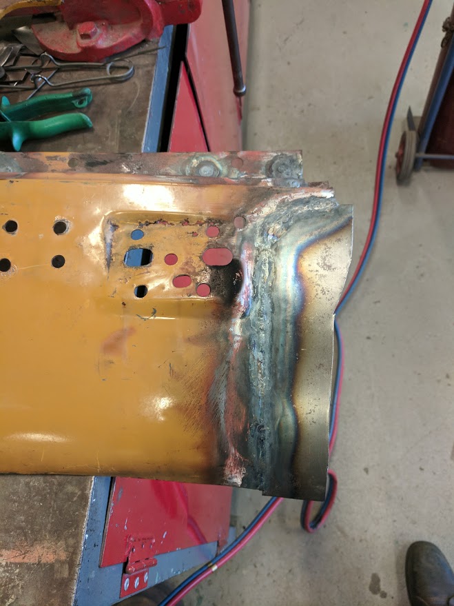

1 problem with repairing the existing panel is that I cut a bajillion holes in it removing the spot welds. The zip cutter creates large holes that need to be patched up again. If you're going to remove spot welds find the smallest spot weld cutter possible and use that. I didn't think I'd be using this panel again, but it looks like we will.
You can see rather than patch these holes I'm creating a new edge (on each side).
If there is 1 thing for certain I'll be learning a lot of welding skills fixing this thing. I'm using Oxy welding here as it will allow me to free form the panel as I go, Mig welds are too hard and brittle and would not allow for much adjustment later.

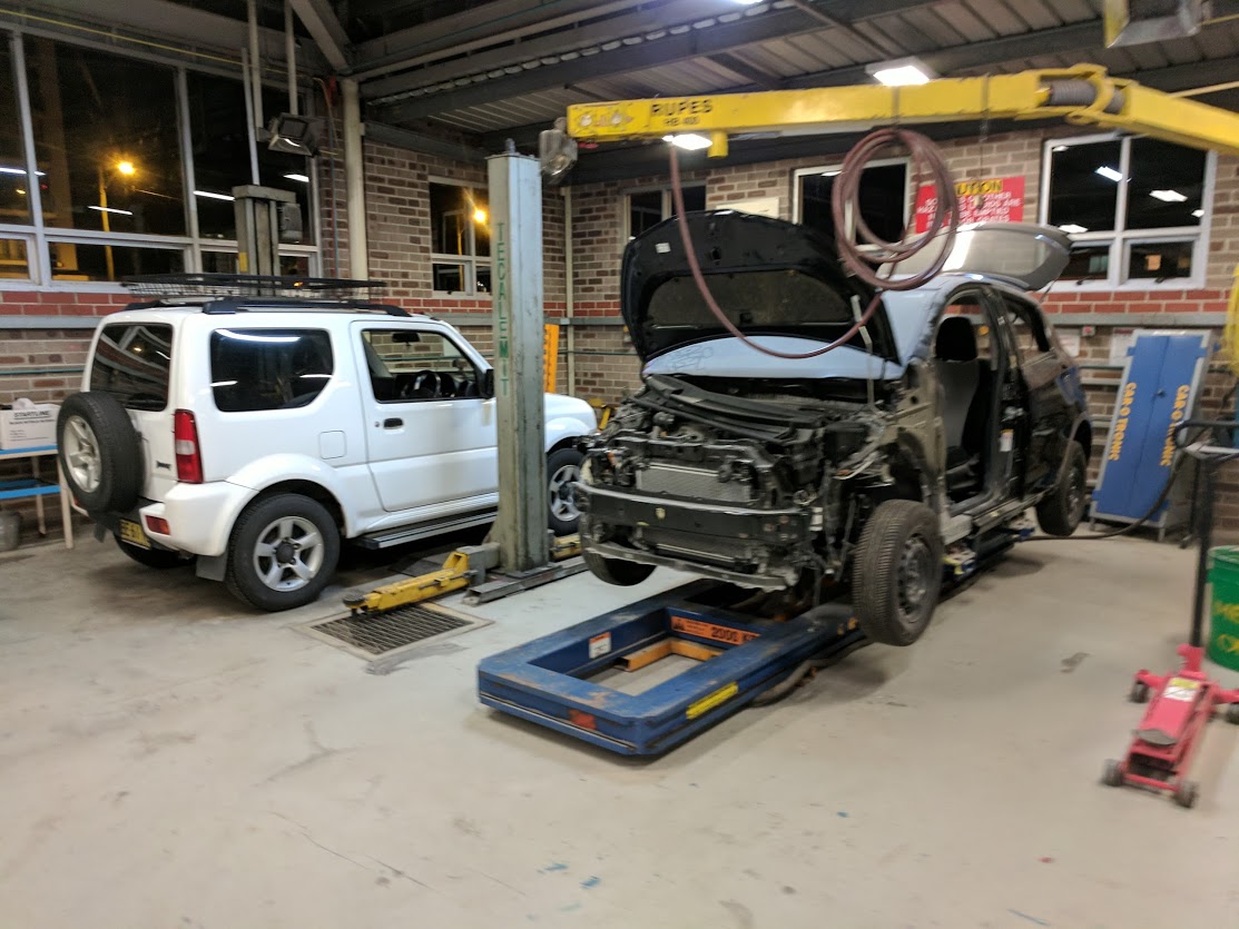

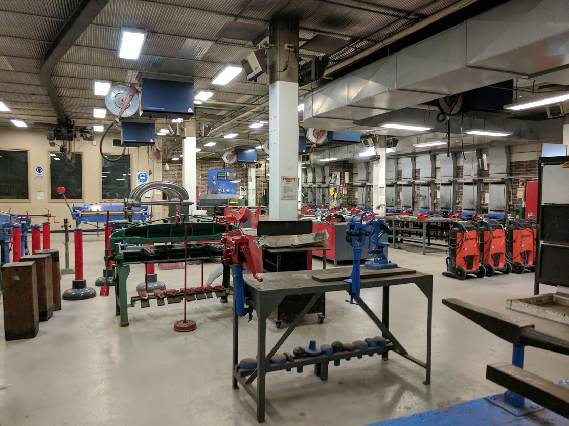

I took some photos of St George before I left.. last time there :(
Even got my Suzuki Jimny in there ;)
Bit sad to see the classes there end.
