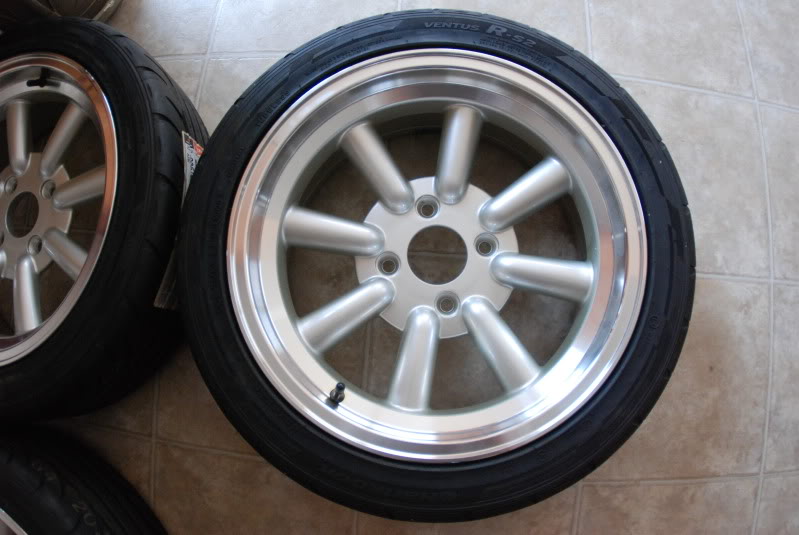

260DET Posted May 5, 2015 Author Posted May 5, 2015 Over 600 views but little conversation, just about finished anyway Wheels. Obviously are relevant to brake cooling so throw those awful Performance Heavyweight's into the bin and get serious. It may well be that some wheels would act as a fan for the brakes but that's beyond my knowledge so let's just look at the design of the usual Watanabe style and start with the proposition that the more open the design the better. Those less well known come from Enkei and Konig, Enkei always make a good light wheel while the Konig Rewind is a very open design, pic below. And finally onto the touchy subject of driving. I'll just leave the quote below from a driver who raced a standard braked S30 and say nothing. "You just have to drive while being easy on the brakes. On hard and then off for short intervals Don't drag the brakes, no trail braking, left foot brake, and learn how to carry more speed through the corners. Move roll stiffness to the back of the car so it rotates more and gives better control with the throttle. Install the front brake backng plates from a early car or run no front backing plates. Hawk blues have worked well for me. Most important, take weight out of the car and make sure the rear drums are adjusted tight." Another quote. "You will need to balance your braking agressivness with trying to get about 2 hours of life out of pads. You would be surprised what lap times you can get by rolling on and rolling off the pedal. Solid, consistent, threshold braking will only gain a .1 or .2 seconds on most turns and is usually the last thing a pro driver tries to squeeze out. From turn in to apex is where the magic happens." Quote

1600dave Posted May 6, 2015 Posted May 6, 2015 Nope, rotors must be 100% standard. Wheels too - strictly speaking, they must be "period correct" (although that rule seems to be more loosely applied from my observations at Group S meetings). A modern style wheel that aids cooling may well be knocked back as being not eligible. Agree with your statement that the best wheel should be chosen from those that are eligible. My 2c (from one who has never competed in Group S but has flag marshalled at a lot of historic meets where Group S run, compete at some of the same events as Group S and have a Group S build on the go - well, I will have once I find that enthusiasm and spare time I hid away in the shed somewhere....) I think the quote on driving style is the most telling bit of this thread. Group S is designed to emulate production sports car racing back in the day (when even the top cars in the biggest event on the calendar, the Hardie Ferodo 500, would run out of brakes - cue the development of HO Falcons / RT chargers / Bathurst special Monaros to get better "race" parts homologated for the track). Back when, arguably, driver skill counted for more, or they had more to deal with and overcome (like dodgy brakes). You could allow freedoms in Group S for the zeds so they can stop better, but then where do you stop (hehe, I made a funny - where do you "stop".....) with regards to "parity" ? Allow bigger brakes for zeds, they can now compete with (or even beat regularly) the Porsches. Then the Porsches complain, they get bigger brakes, and so on. Arguing with CAMS that factory / possibly factory fitted competition parts should be allowed is one thing, but allowing access to more modern / better performing alternatives is (in my mind anyway) quite another. Group S is for drivers to compete in cars representative of the period, and may not be the best category for the driver who wants to compete in his favourite type of car - to win at all costs, ideally you would pick the most suitable car and develop that (whether that's a Datsun or a Porsche). I'm probably an example of this, my intention is to join Group S in a Fairlady. I have checked things out and will be going with a 1600-engined one, rather that the much faster and (on the face of it) more suited to racing U20-engined one. Running a U20 puts me into a faster, more serious category with Porsche, Corvette, Healeys, etc. So, stick with the 1600 and play with MG's and the like. I also was looking at building up a 1600 sedan for Group N, but the additional freedoms allowed in that category, including brakes (and their propensity to drive more aggressively / cop more panel damage) is what made me lean to Group S. I take Jason's point about the lack of brakes potentially being unsafe, but then again "Motorsport is dangerous" (so the back of the tickets, the entry forms, etc, all tell me). The answer may well be that if zeds are unsafe, get a different type of car that is safe - the event isn't a category for Datsuns, but for the production sports cars. Personally, I like the category. It offers good, close (but mostly clean) fun. Some of the top cars are punted around extremely quickly for what are essentially only lightly modified versions of the road car. It is good to consider how to improve things, but keep in mind that production sports car racing has been around long before Group S, and that even Group S has some highly developed cars with very quick drivers. Quote
