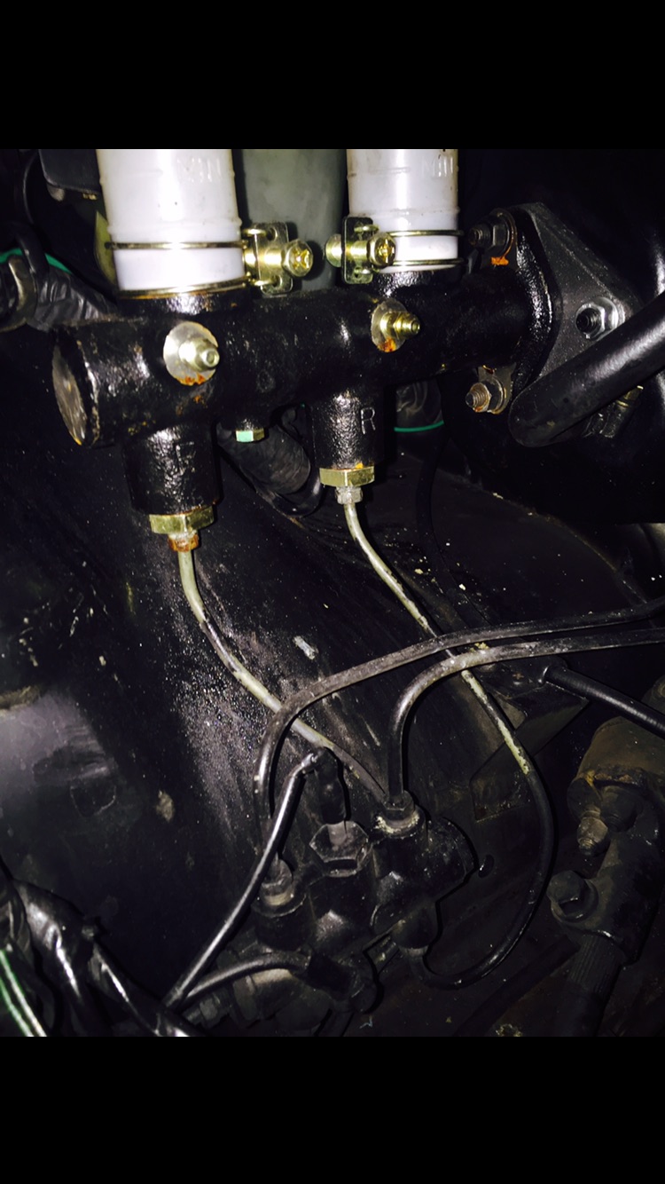

luvemfast Posted March 18, 2015 Posted March 18, 2015 Looking at changing to a Patrol master cylinder. Asked some brake places to copy the current lines from brake distribution block to where they'll actually be. But they don't really want to do it. So was thinking I could just do it myself, if I had the right tools. Anyone got some, local to eastern suburbs Melbourne, that I could borrow? Thanks, Simon Quote

luvemfast Posted March 18, 2015 Author Posted March 18, 2015 I want to do the swap at home. Not in a shop. Which means it has to be done beforehand. So measurements and thinking need to be done. Been to 2 brake places and they both only want to do straight pipes. Quote
dat2kman Posted March 18, 2015 Posted March 18, 2015 Consider buying a double flare pipe making kit? And steel bundy tubing? Bit f an overkill jst to do a couple of lines though. Quote
luvemfast Posted March 18, 2015 Author Posted March 18, 2015 You've read my mind there Jason. Can buy some tooling, pipe and nuts for about about $60. Quote
44014 Posted March 18, 2015 Posted March 18, 2015 I want to do the swap at home. Not in a shop. Which means it has to be done beforehand. So measurements and thinking need to be done. Been to 2 brake places and they both only want to do straight pipes. When I put my patrol master cylinder on I just moved the lines from front to rear ? Like literally just bent them to swap them front to rear? Quote
luvemfast Posted March 18, 2015 Author Posted March 18, 2015 I'll look into that Doug, but don't think it'll fit. Quote
44014 Posted March 18, 2015 Posted March 18, 2015 My brake lines bent quite easy was only a matter of a few minutes massaging them to fit and look tidy? Maybe your brake lines are different? Quote
