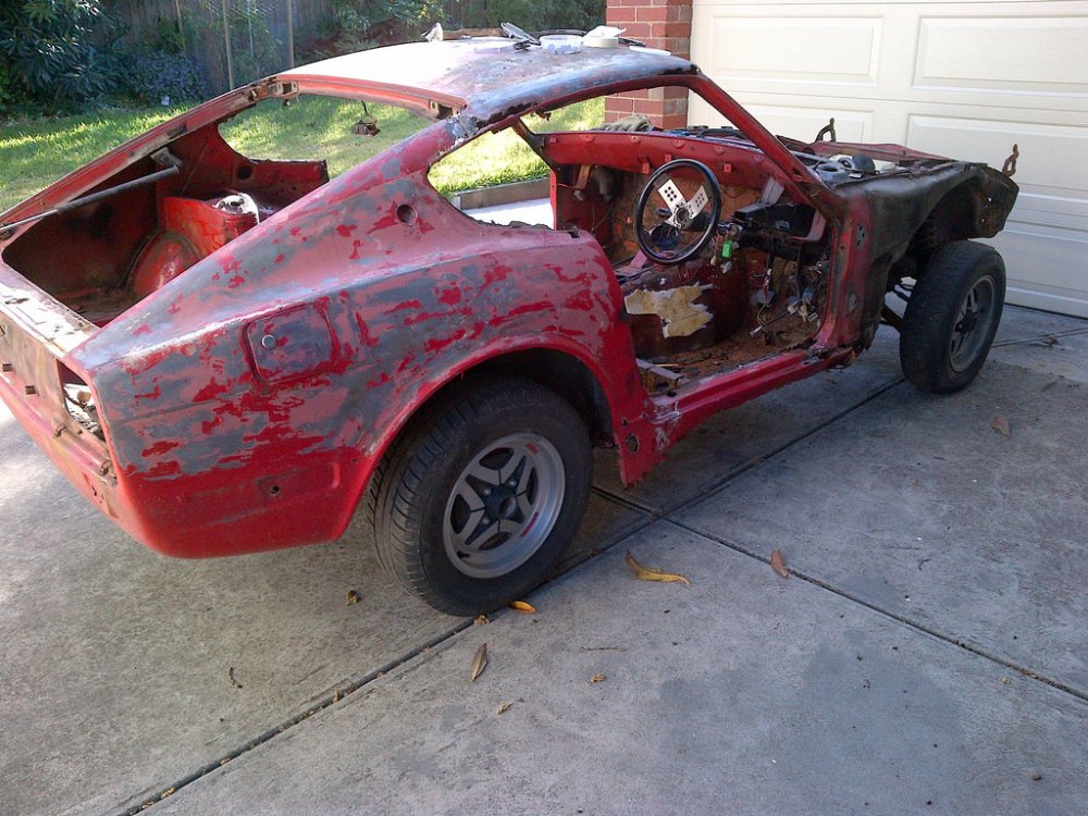

aircobra Posted April 3, 2015 Author Posted April 3, 2015 Today's update Have almost finished the stripping. thanks to lurch and rob for all the advice so far about to start taking out the supsension and put onto car stands, ready to rip the inner and outer sills Quote

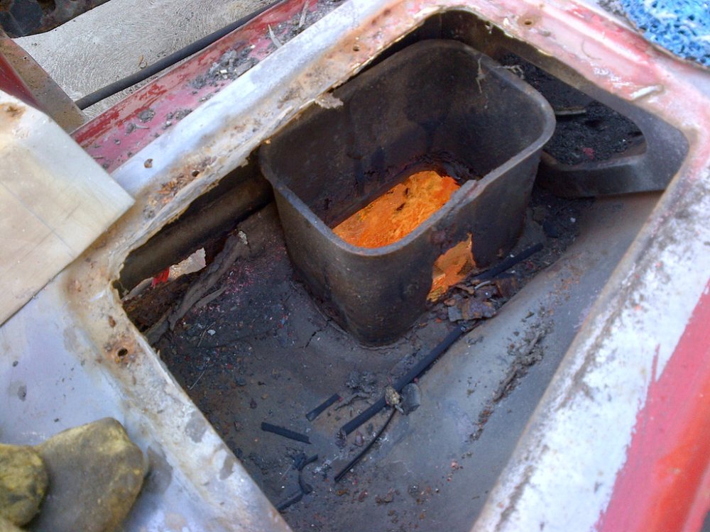

aircobra Posted April 3, 2015 Author Posted April 3, 2015 what's supposed to be here loosk like ites been patched Quote
dat240z Posted April 3, 2015 Posted April 3, 2015 Wow!!! Good progress, but man, thats a lot of work!!!! Quote

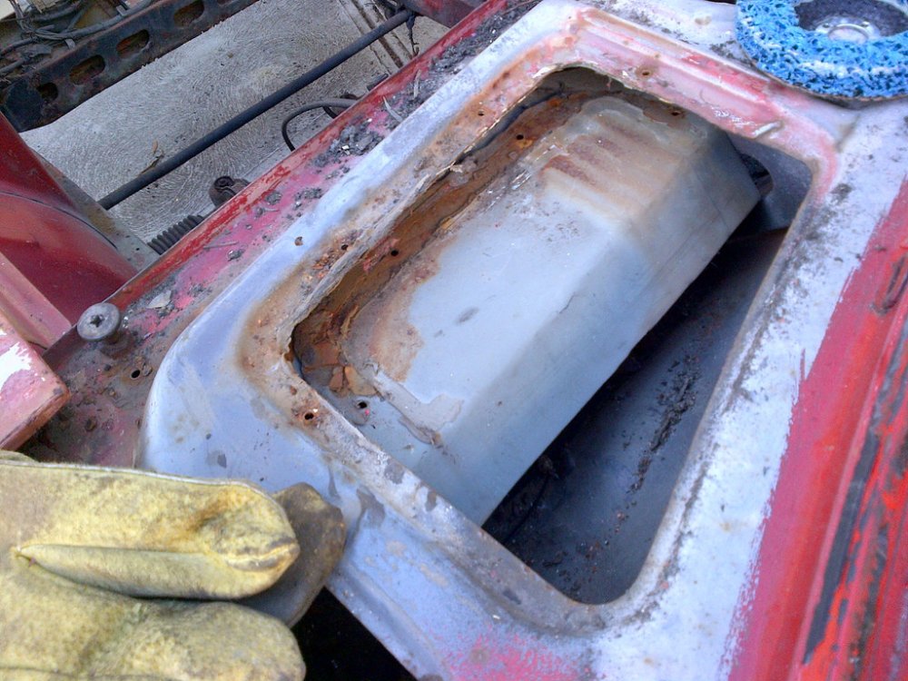

aircobra Posted April 4, 2015 Author Posted April 4, 2015 it looks like the air intake for the heater. has anyone taken this part and knows what's supposed to be on the top from factory? looks like someone just cut a piece from roofing iron Quote
Administrators gav240z Posted April 5, 2015 Administrators Posted April 5, 2015 Hey mate, pretty sure that is standard piece. I can take a photo of mine to compare but I haven't undone the spot welds about yet. Pretty sure heater intake looks like that though. Quote
