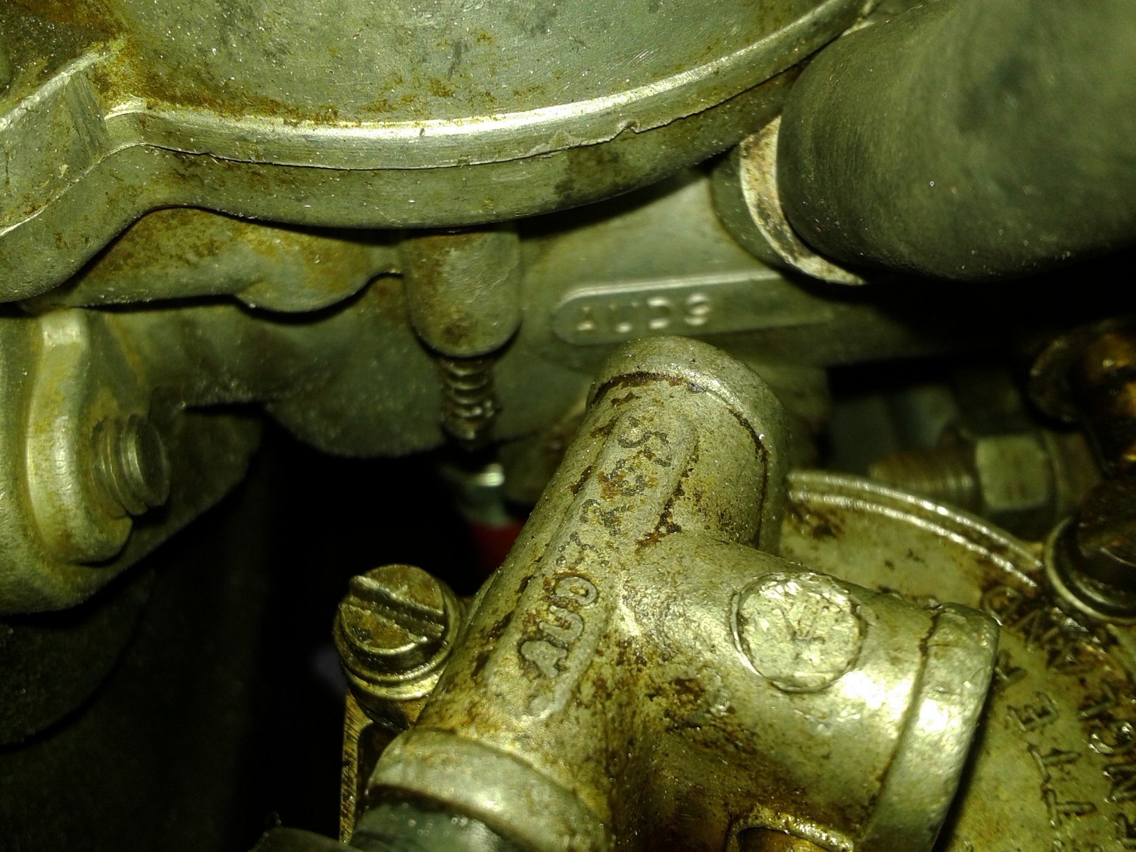

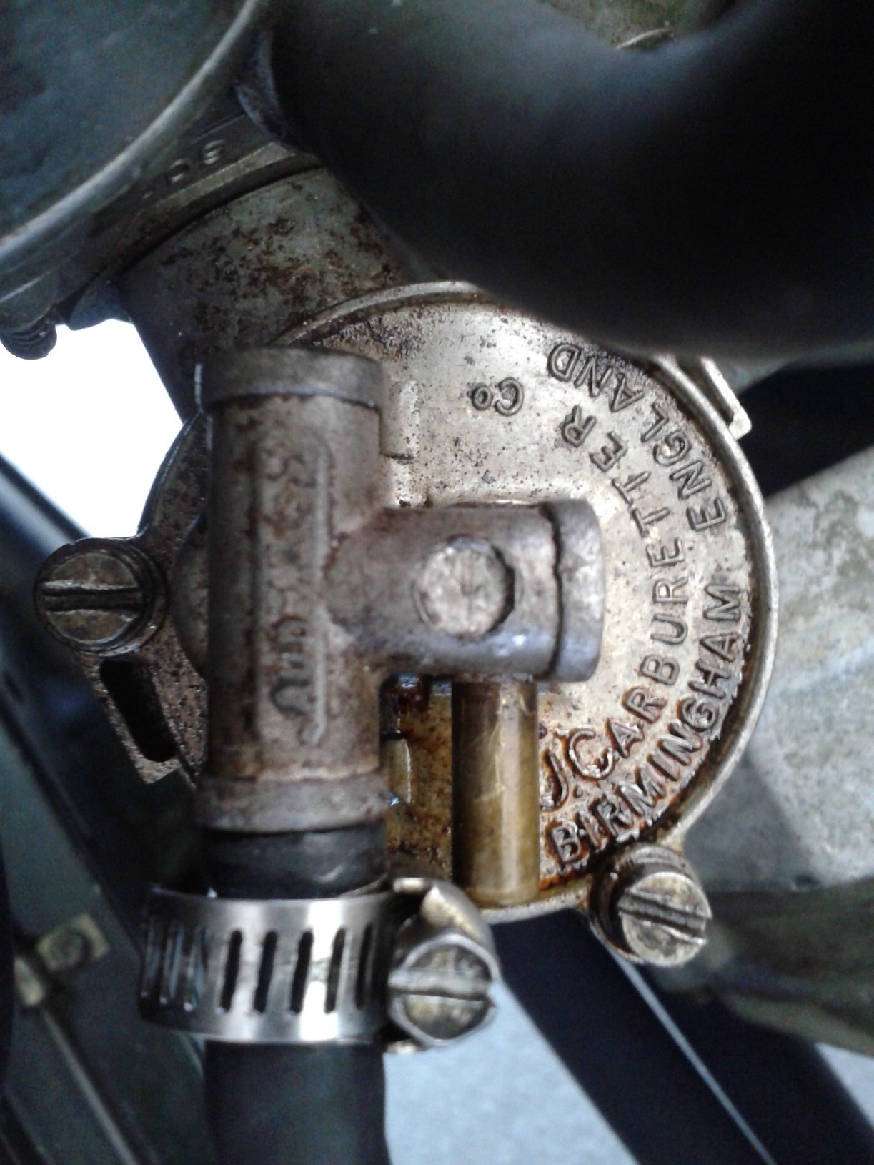

WogsRus Posted December 28, 2014 Posted December 28, 2014 Ok so my new Z came with what looks like to be HS6 not the early hitachies. Can someone tell me what the main differences are and are these worth keeping or going to Z therapy 240z carbies with SM needles etc. Current;y, ca pulls hard, however i have lowered the jet down another one turn as it was lean, now seams ok still a bit flat above 5600rpm and will not rev to anything over 7K not even at idle,that could be more the dizzy. Quote

Administrators gav240z Posted December 28, 2014 Administrators Posted December 28, 2014 They look like HS6 SUs to me. Can tell by the nozzles. Why are you trying to rev past 7k anyway? Quote

1600dave Posted December 28, 2014 Posted December 28, 2014 They're genuine british SU's (HS6). Very similar performance between these and Hitachi's, nowadays how well they run depends on the condition of the carbs rather than what type they are. Real SU's are easier / cheaper to get parts for, both standard bits and "tuning" bits. I rebuilt a pair a year or two back for a cost of under $200, including having the carb bodies re-bushed, new jets / needles / gaskets / special non-sink adjustable floats and high-flow ball valves for the float chamber. All the bits (except the fancy floats and needle / seat) were available from Carburettor Service Co in Sydney, who also did the rebushing. Fancy bits came from Burlen in Pomgolia. Only thing I don't like is the method of adjusting float level on the British SU's - most of the 1 3/4" ones I have need to be adjusted by adding / removing shims / washers from underneath the valve (which is a little fiddly to get spot on). Hitachi's can be adjusted by bending the float lever. You can get (as I did) special adjustable floats for the SU's. Quote

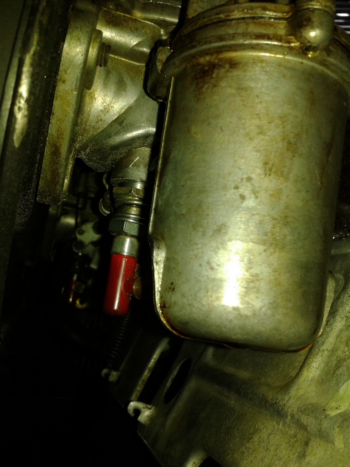

1600dave Posted December 28, 2014 Posted December 28, 2014 Also, had a look in one of my SU books, according to the little tag on the float chamber in one of your pics that says "AUD661R" that carb is the rear carb off a '74 onwards Triumph Dolomite sprint with a 2l engine. Perhaps you may need to look at re-jetting them if they are still jetted for the smaller Dolomite engine. Quote

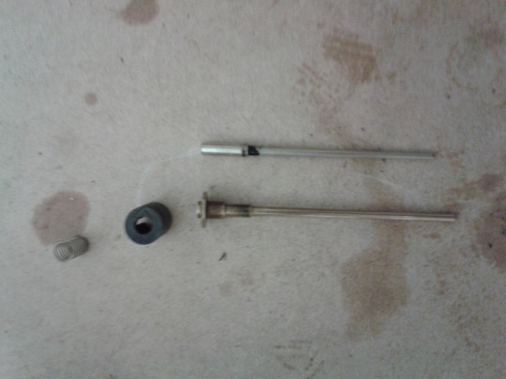

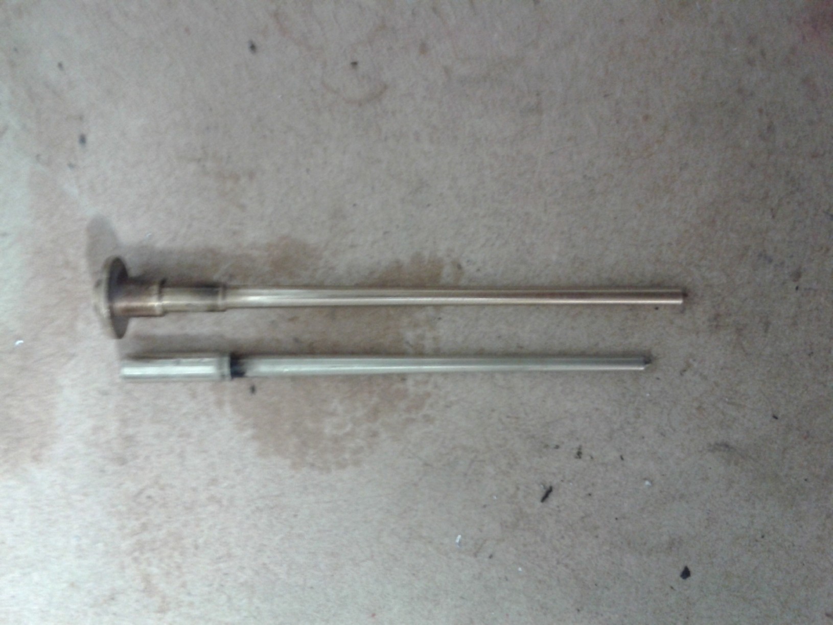

WogsRus Posted December 28, 2014 Author Posted December 28, 2014 Ok so i took the HS6 carb jest out, stamped BCM. I also took a set of jets out of the spare set of 4 screw dome tops. The HS6 needle is much longer and fatter then the hitachi one. The hitachi one will not fit into the HS6 carb as this has a spring loaded needle seat. SO i think SM needels are in order. Thoughts> Quote

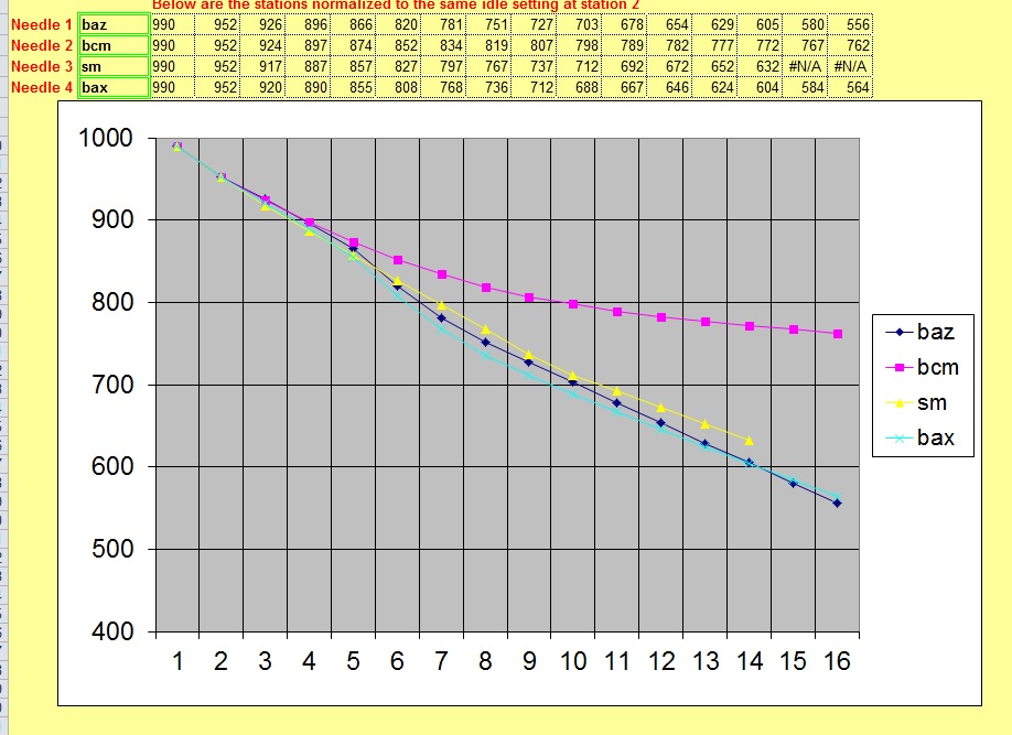

1600dave Posted December 29, 2014 Posted December 29, 2014 Good to hear. You can see the difference between the needes in the graph below - BCM are much thicker, especially at the "fast" side of the scale (right hand side), meaning less "space" between the needle and the jet for fuel to get through. Interestingly, I run (I think, should check again one day) BAX needles converted to suit "fixed" needle carbs on my overbored L18 (so around 1.9litre). But it is quite modified and I don't care for fuel consumption or low speed running (because race car). These were chosen by a very good dyno guy with lots of MGB / SU carb experience, after I rebuilt them initially with BAZ needles from a recommendation by another guru with SU's on Datsuns. Quote
