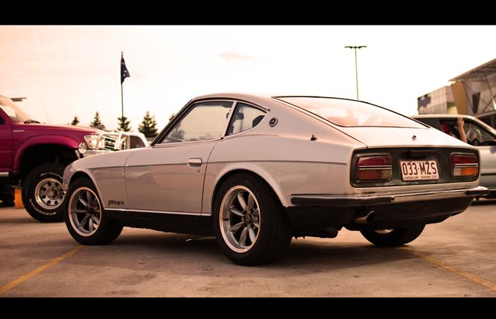

d3c0y Posted September 24, 2014 Posted September 24, 2014 To be honest if you do lowered king springs and then put thin strut tops in it you will get pretty close to the height you first said you wanted. Here is a pic of mine with low king springs. If you use a GC camber kit that will drop you another 30mm or so? Quote
