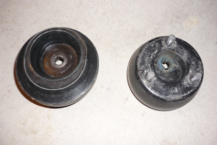

Riceburner Posted March 30, 2014 Posted March 30, 2014 I have SWM offset strut tops and I have managed to strip the threads on one stud and a second stud is close to going also. Unfortunately they are off set so it's not just a case of buying a new cheap one. Is there any way to replace the studs in these? Quote
d3c0y Posted March 30, 2014 Posted March 30, 2014 Might be cheaper just to make some flat alloy ones like on modern coilovers. Then you can have a monoball and still get them offset? Quote
luvemfast Posted March 31, 2014 Posted March 31, 2014 Can you weld onto the studs, remove them and install new ones? Quote
Riceburner Posted March 31, 2014 Author Posted March 31, 2014 Might be cheaper just to make some flat alloy ones like on modern coilovers. Then you can have a monoball and still get them offset? I was trying to be a tight wad and hopefully fix them myself Can you weld onto the studs, remove them and install new ones? I figured they're like a wheel stud with a spline and need to be removed from the back. Are they just a stud similar to a manifold stud That would make it easy Quote
Moderators PB260Z Posted March 31, 2014 Moderators Posted March 31, 2014 IIRC the studs are pressed in then the rubber added afterwards. Is it an option to recut a smaller thread on the damaged one ? Or would that reduce the holding strength to much ? Just my two cents worth. Quote
Retro Z Posted March 31, 2014 Posted March 31, 2014 If thats a stock type isolator you can throw it in the oven for a few minutes to seperate the rubber from the shell and then u can hammer the stud out just like a wheel stud. I know this as my friend done the oven trick in order to trim the isolator for added suspension travel. Quote
Riceburner Posted March 31, 2014 Author Posted March 31, 2014 IIRC the studs are pressed in then the rubber added afterwards. Is it an option to recut a smaller thread on the damaged one ? Or would that reduce the holding strength to much ? Just my two cents worth. I did think about going smaller and re-threading but I was concerned about strength. The two problem studs are on the same top. If thats a stock type isolator you can throw it in the oven for a few minutes to seperate the rubber from the shell and then u can hammer the stud out just like a wheel stud. I know this as my friend done the oven trick in order to trim the isolator for added suspension travel. How did he re-bond them? Is it only the rubber that holds the two parts together? These one are urethane, I don't know if that matters at all Quote
Retro Z Posted March 31, 2014 Posted March 31, 2014 He used some sort of Shoe contact adhesive if i remember correctly. Not sure if your urethane one would work.. but if its anything like the stock one it was 2 discs of rubber than sandwiches a metal plate with the 3 studs pressed in with a outer shell surrounding it all. He just heated it up for 10 minutes at a lowish heat and pryed it apart, trimmed and reassembled. He said the weight and spring compression means the glue was not a major concern. He's been driving the car for over 2 years and is still alive so i'm guessing it would be ok? If u manage to get yours apart i have some stock isolators you can have for free to salvage the studs from. Quote
C.A.R. Posted March 31, 2014 Posted March 31, 2014 As a first step, have you tried running a Die-Nut down the threads to clean them up? The rubber is vulcanized around the steel housing, so you'll end up destroying them just to repair the thread. If they are that badly damaged, I wouldn't waste your time G-man. Just get on to SW Motorsport or MSA & order some new ones. For something that is placed under so much load at the track, why would you want to re-install something that may compromise you & your Zeds safety? Quote
Riceburner Posted April 1, 2014 Author Posted April 1, 2014 Yeah mate I did try the die but it didn't really do much and the threads aren't nearly as deep as the other studs. I wonder if it has stretched a little too, either that or the strut bar has been chewing them out. I've never really bothered to look at these too much so I wasn't sure if the were serviceable or not. SWM list them at $115 per side which seems pretty good. Thanks Gents Quote
