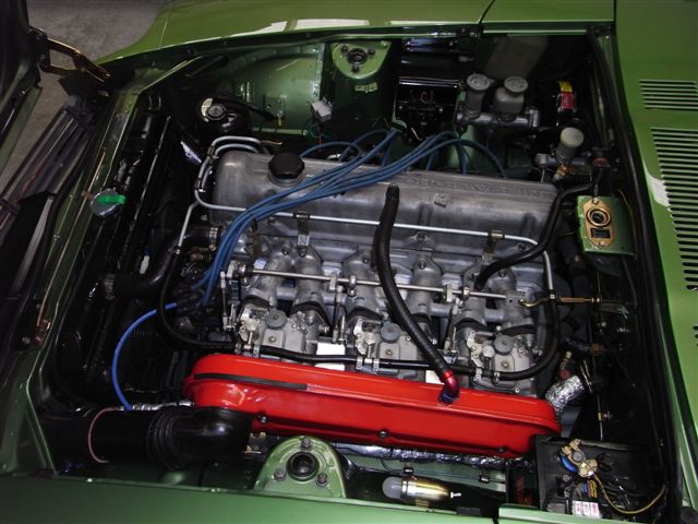

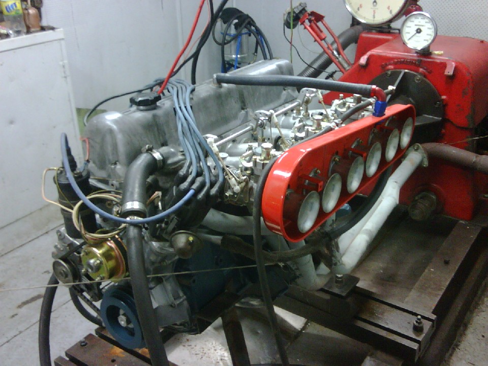

260Coupe Posted August 13, 2013 Posted August 13, 2013 I have a GT-B airbox which I modified to fit my 44 Mikuni's, I offered to get a mould made and get them reproduced in carbon Fibre (for rigidity) a couple years back before the engine was reinstalled but I needed a minimum commitment of 10 x units and they would have been approx. $400 each ex ram tubes..................and yes they fit under a strut brace, you just need to relocate the coil. Needless to say I got plenty of "yeah count me ins" unit I asked for a $100 deposit ..............and none were forth coming.......alas many like to experiment with modified rocker covers and un-tested air boxes This airbox was dyno tested and proven to improve mid range torque by approx. 10% and not rob any top end HP, as tested on my warmed over L26 and Gerhard Metz's L3.1 stroker. If I can get 10 x serious orders then I'll look into getting them produced again. cheers Alan Quote

260Coupe Posted August 13, 2013 Posted August 13, 2013 I would take one if it would be everything else then Carbon Fiber (in my eyes it doesn't fit the age). Im looking also for a lamborghini Box from the 70 like from espada. If I would find one of those before I would back out. (cheapest I found was 700$ till now). They would have been gell coated with a smooth finish so could have been left natural (for those who like C/F) or painted any colour and would have looked just like the original, the Prince box was a cherry red, I powder coated mine orage to match the 240 Z air box. To make them out of F/G would have made them three time as thick to get the same ridigity........you don't what the airbox collapsing under full throttle. Quote
