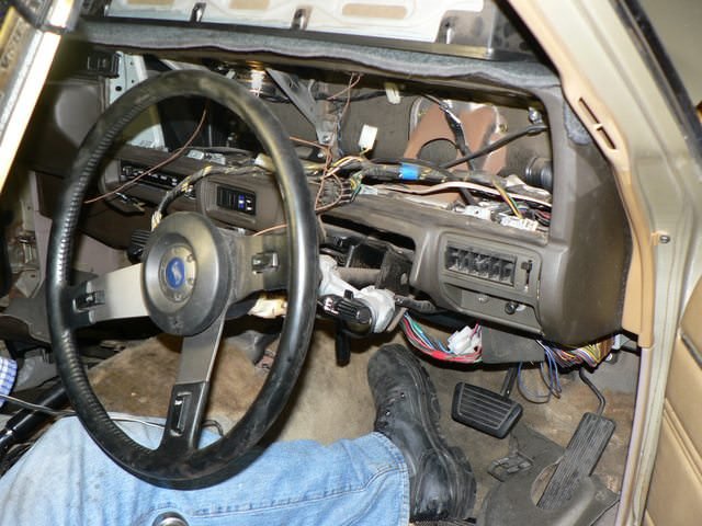

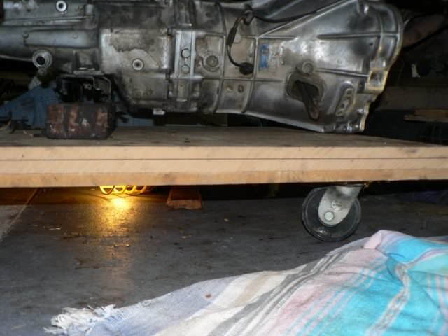

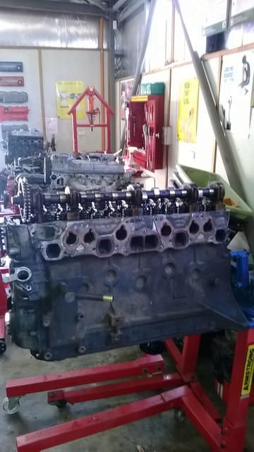

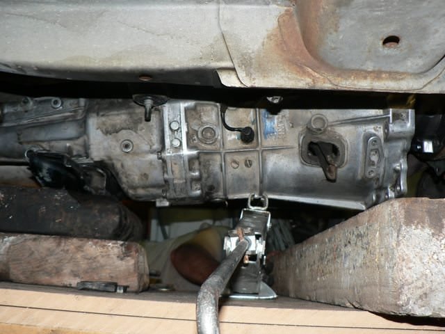

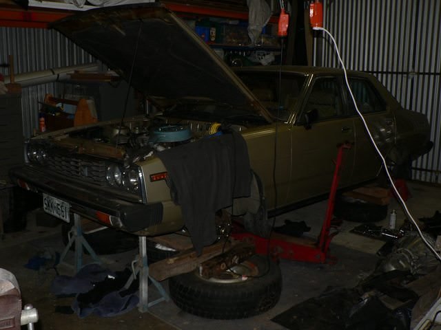

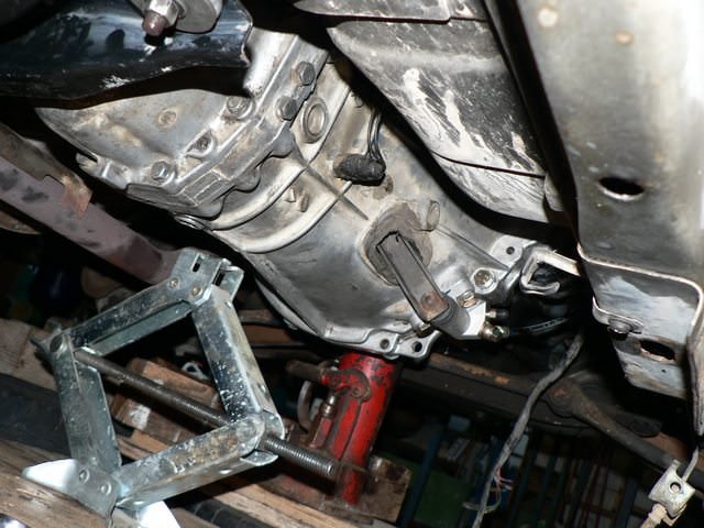

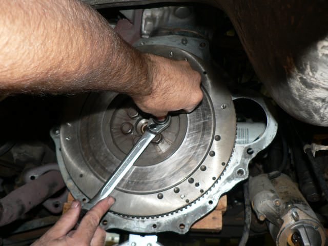

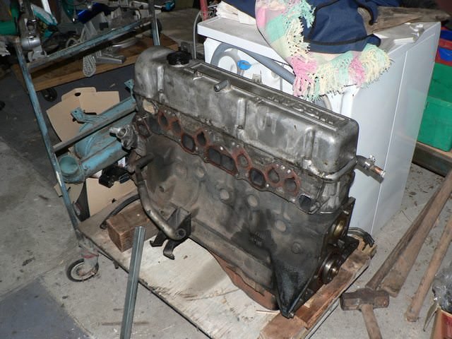

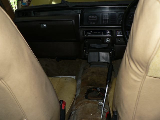

DOOM Posted February 24, 2014 Author Posted February 24, 2014 So some updates since that post. The manual conversion was completed, using a 280ZX box (with 120y shifter), 225mm flywheel, Datsport providing Nissan Urvan Clutch and master/slave cylinders. this took two weeks in October Hover mode. Many thanks to the oldman for helping. L28E has been purchased to be rebuilt by me. Quote
