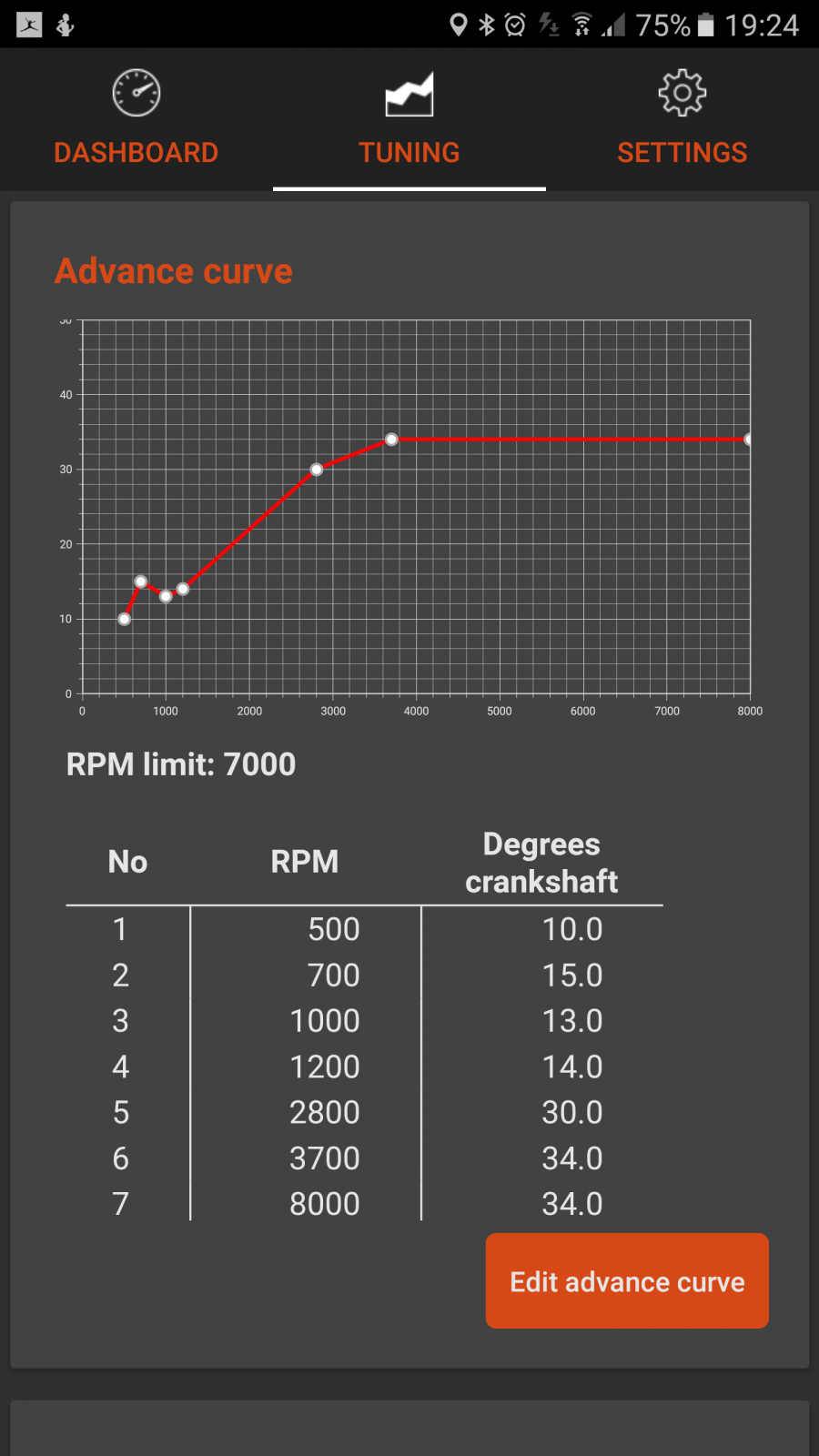

C.A.R. Posted August 1, 2017 Posted August 1, 2017 To my eyes it should run on that.However I suggest you remove the dip @ 1000rpm & continue adding timing from idle. Maybe try backing the timing off to 7deg at 500rpm.Personally I'd have full advance at all in at 3000rpm... 34deg total is fine, so long as it doesn't detonate (ping). Quote

HKSZ Posted August 1, 2017 Posted August 1, 2017 Did you upgrade the coil for electronic ignition and remove balast resistor? I run idle @1000rpm 17deg static Quote

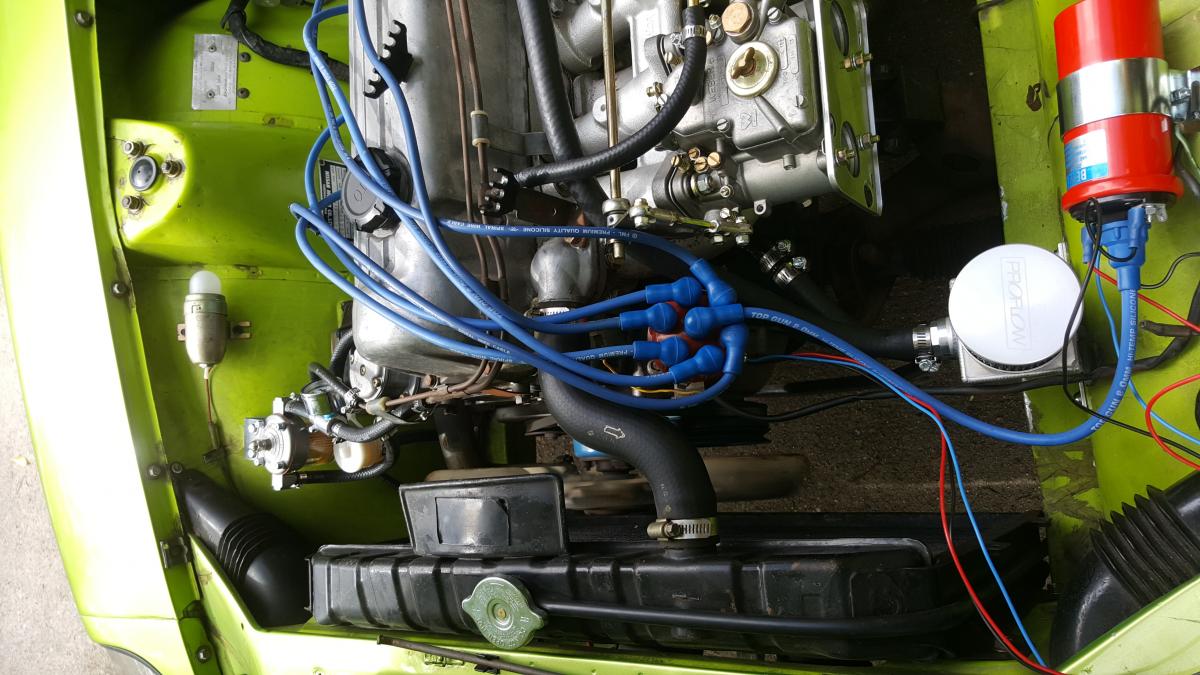

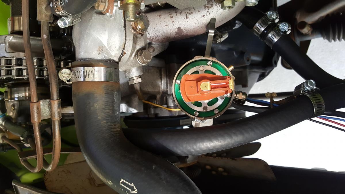

Kent Posted August 2, 2017 Author Posted August 2, 2017 (edited) Thanks for the advice guys.. i will follow the directions and adjust the curve to 7'@500, 17'@1000, 34'@3000 and leave it at that. or is the 7' to 17' ramp up too quick? Yep, its the Bluetooth Datsun version of the 123ignition dizzy (123\TUNE+-6-R-V-DATSUN). I bought it through 123ignition.com.au, it had to be ordered in for me, but it came relatively quickly.. and pretty good pricing compared to the O/S pricing I had read some problems on other forums with the shaft key not fitting correctly, but mine was perfectly fine (i assume the problem has been resolved in production). It does rotate the location of your TDC #1 plug though if you have custom leads. It was all new to me but i didn't have a problem fitting it, and although the calibration it uses (turning the dizzy on and rotating until a light changes), seems like it is open to large tolerances.. mine seems to be perfect. I didn't get any decent install photos apart from the attached.. it certainly doesn't look out of place Did you upgrade the coil for electronic ignition and remove balast resistor? I run idle @1000rpm 17deg static I did, i asked for advice and was recommended to replace my coil with their 1.8 ohm Red "Beru ZS109" coil, which i ordered along with the dizzy. I bypassed the resistor, but i did use the one side of the resistor as a connection post for the coil still (other side isn't connected), mainly because i couldn't be stuffed rewiring too much Edited August 2, 2017 by Kent gav240z 1 Quote

Kent Posted August 3, 2017 Author Posted August 3, 2017 (edited) Thanks for the advice Lurch, HKSZ and Gareth I ended up with the following curve that seems to have met everyones suggestions, amazingly it was able to drive under its own power at least 500m this morning! (even if it was down hill). it's heading off to get tuned now. Edited August 3, 2017 by Kent scott and C.A.R. 2 Quote
Kent Posted August 10, 2017 Author Posted August 10, 2017 Just a very quick update.. the webers were successfully tuned on this curve, and runs quite well (although he needs to order me in some 110 mains, its still a little rich on 115's). I have to say, the software is still a little buggy at the current version when changing the curve, but this doesn't happen often, its definitely a solid solution.. just wish i could get the vacuum advance working with the weber manifold Quote
munters Posted August 24, 2017 Posted August 24, 2017 The Anti stall dip you had before does work. (this is the cool thing with this distributor its not a recurved but programmable) I am using it and with this, mine idles even when it goes to 500 rpm. With 7° mine would never run. Try once at your first curve to take off point 4 and point 5, set point 6 to 3000rpm. I will try soon to use the manifold vacuum and programm it above 1500rpm to kick in. Quote
Kent Posted August 24, 2017 Author Posted August 24, 2017 (edited) Hi Munters, Back when i posted, i was in a bit of a fix with the car not running and upcoming registration inspection required.. It didn't help that i had changed a bunch of critical components at once.. try as i could i couldn't get the original map i posted to run the car.. strange as the mappings were not too dissimilar now the car is running happily on the 2nd curve, i can look at re-introducing the anti-stall dip knowing i am starting from a decent base.. i was impressed with the original thought behind this dip, so i would like to introduce it again would love to know how you get on with the manifold vacuum install.. There seems to be some real benefit from it, and it would be easy to do on an SU setup.. however i have not found a definitive posting on how to achieve this with the triple weber manifolds.. keen to see your curves (with engine setup spec's) once your done! Edited August 24, 2017 by Kent gav240z 1 Quote
