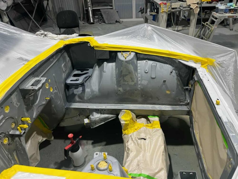

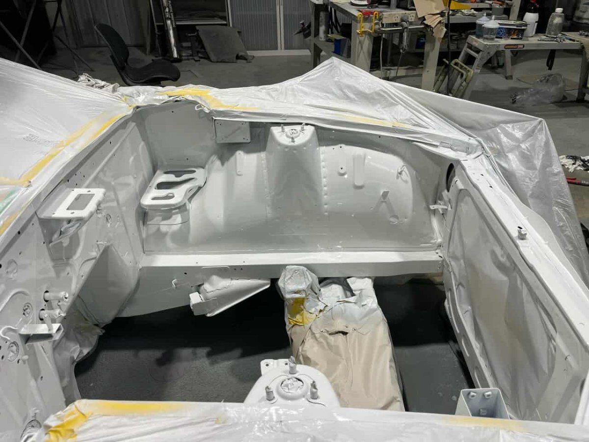

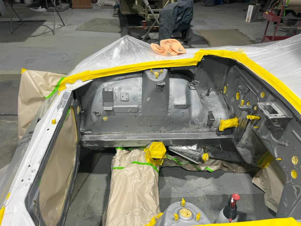

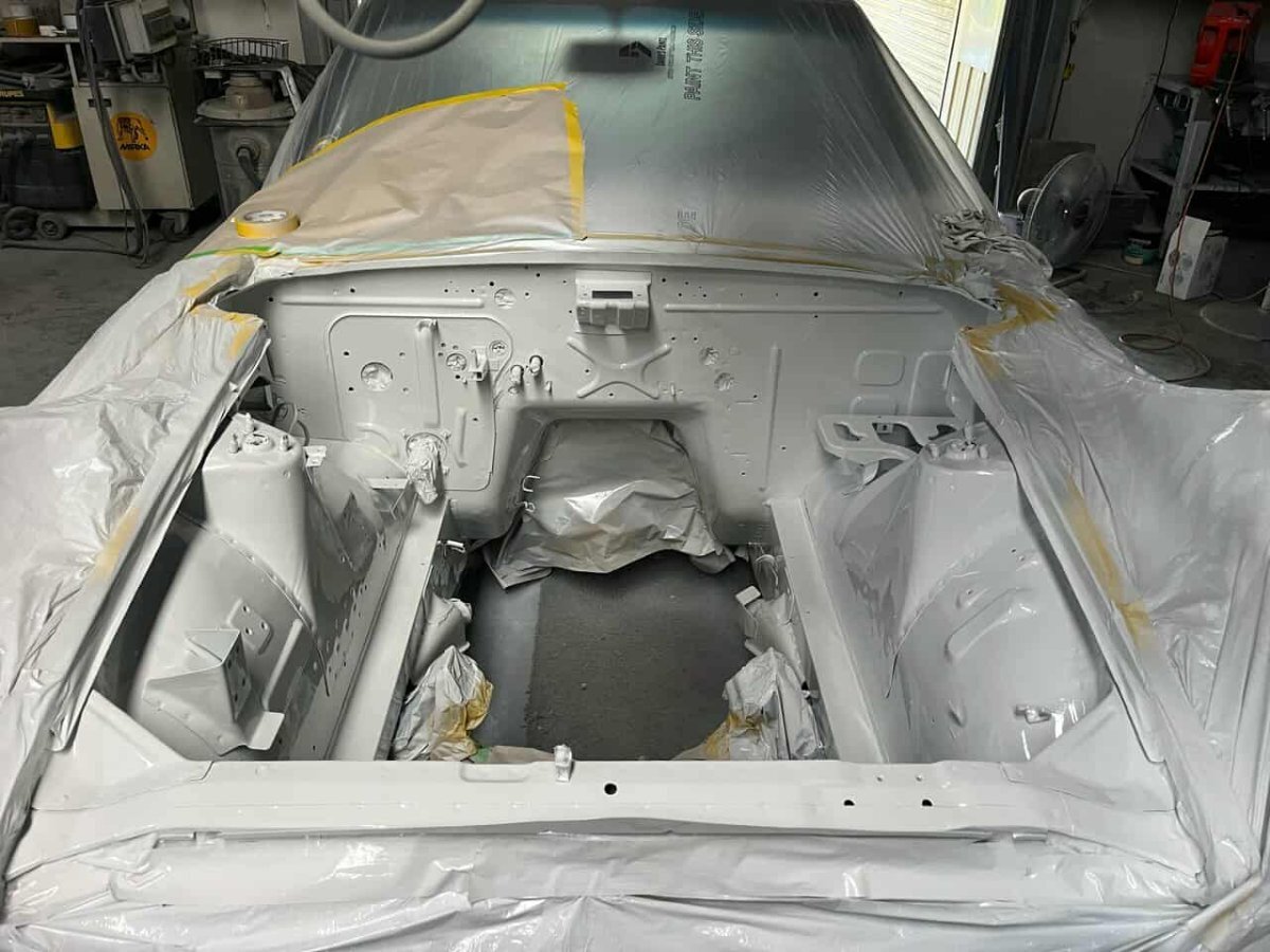

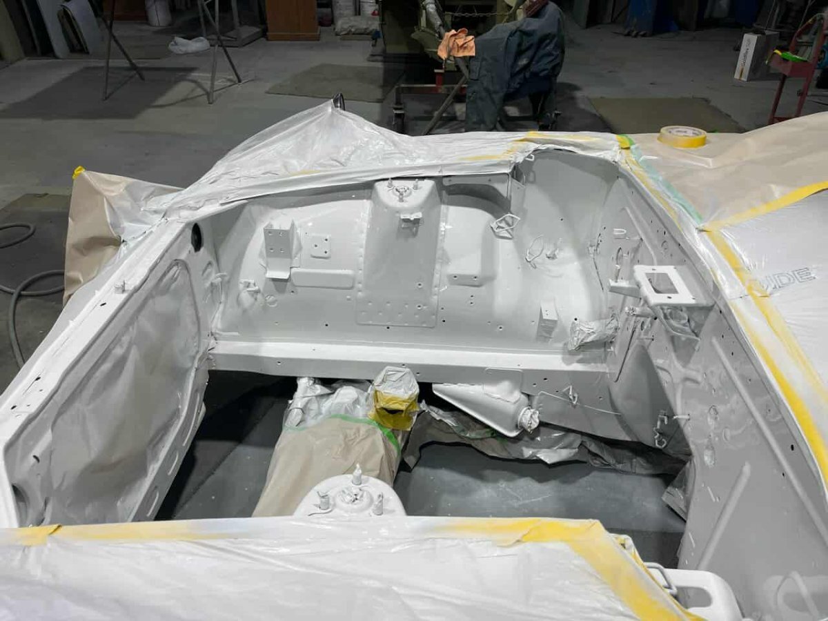

  9. So to carry one from the last the post, the boys at @C.A.R. suddenly had some space in between some of their bigger restorations to get the V8, the engine bay tidied up, painted and the L28 in, mind you our conversation a week prior was, let's book this in for next winter. Any way, off the boys she went. Didn't take them long to get the donk and box out of the bay and the rest of the hardware. No rust was found, just a bit of surface rust needed cleaning up around the battery tray of course. Also my 71B box from my last Z was disassembled to bevapour honed with the new rocker cover. Clean up of a set of headers I had hoarded too:
